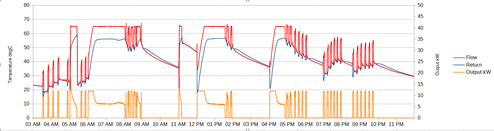

PiMike Posted March 15, 2023 Author Share Posted March 15, 2023 (edited) 2 hours ago, Radian said: Good stuff - ebusd on a Raspberry Pi? If so you should be able to get the operational modulation value "ModulationTempDesired" which despite the name is the calculated value that's controlling the gas valve and fan. If you range rated a 24kW boiler to 12kW, for example, then this would max out at 50 (%) and if the boiler has a 4:1 modulation ratio then would go no lower than 25 (%). My Glowworm boiler is monitored via ebusd and I get this kind of spaghetti plot which shows the actual modulation bottoming out at 33% as it's only got a crappy 3:1 range: Which component is "turning off"? Do you mean the boiler is cycling off as in "hit the lowest modulation" and still too little delta? Yes it's a RPi4. I've played with the ModulationTempDesired but converted it to kW as in this earlier plot: I'm not sure what's telling the boiler to turn off yet. I need to go deeper into the rabbit hole ... Mike Edited March 15, 2023 by PiMike Replaced poor graphic Link to comment Share on other sites More sharing options...
PiMike Posted March 15, 2023 Author Share Posted March 15, 2023 53 minutes ago, JohnMo said: You will have a max temperature set in the control system, so the boiler slowly increases power and therefore heat output, once it hits the max temperature setting it cuts out. It will continue circulation and when it sees the return temperature drop by a given temperature, it will kick back in to life. Well that's what's happening now, but in the graph I posted in reply to Radian (above) it doesn't shut off when it reaches the desired flow temperature (65C in that instance). Mike Link to comment Share on other sites More sharing options...
JohnMo Posted March 15, 2023 Share Posted March 15, 2023 Looks to hitting max kW of 12 ish then it trips? Link to comment Share on other sites More sharing options...

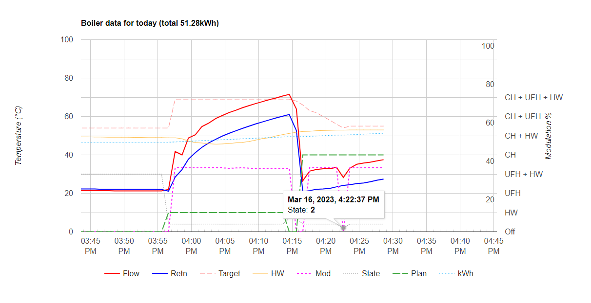

Radian Posted March 15, 2023 Share Posted March 15, 2023 2 hours ago, PiMike said: I've played with the ModulationTempDesired but converted it to kW as in this earlier plot: 2 hours ago, PiMike said: I'm not sure what's telling the boiler to turn off yet. I need to go deeper into the rabbit hole ... Right, so the modulation is swinging between 12kW and 6kW by the look of it, corresponding to your max range rating and boiler doing 4:1 minimum modulation. I'd therefore say it's not the boiler cycling, as it wouldn't cut out while it still had some modulation authority available, yet each short-cycle seems to start with close to full modulation. Can you capture and plot the control inputs for bai SetMode Link to comment Share on other sites More sharing options...
PiMike Posted March 15, 2023 Author Share Posted March 15, 2023 3 hours ago, JohnMo said: Looks to hitting max kW of 12 ish then it trips? Yes because the part load was set to 12kW and the minimum for this boiler is 5kW. Mike Link to comment Share on other sites More sharing options...

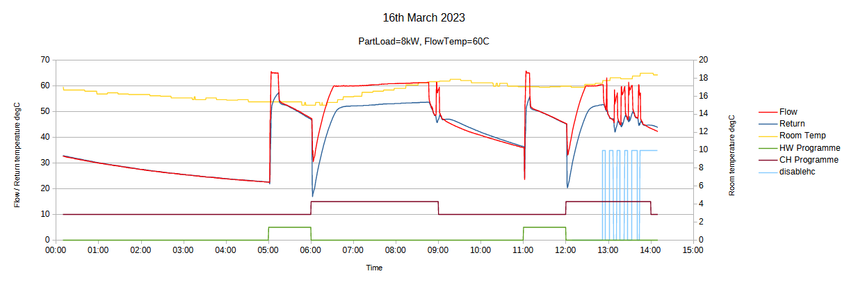

PiMike Posted March 16, 2023 Author Share Posted March 16, 2023 Thanks for that. Yes I found the problem with -f by trial and error. A typical output from SetMode is: auto;0.0;65.0;-;1;0;1;0;0;0 I decided that a FlowTemp of 55C was insufficient to achieve the 18C room temperature so I increased it to 60C and set the CH Part Load to 8kW. I started a new plot at midnight and the interim result is below. I only started plotting SetMode at 1pm. The only SetMode parameters that vary are flowtempdesired (which swings between 90 and 0) and disablehc (the inverse of flowtempdesired and plotted on the graph). I believe flowtempdesired is only relevant to return regulation and I am using flow regulation. What is driving disablehc? Mike Link to comment Share on other sites More sharing options...
Radian Posted March 16, 2023 Share Posted March 16, 2023 58 minutes ago, PiMike said: I believe flowtempdesired is only relevant to return regulation and I am using flow regulation. What is driving disablehc? What makes you believe FlowTempDesired is only relevant to the return regulation scheme? It's the only parameter my 'controller' uses to adjust boiler output and it's working in flow temperature regulation mode (I don't know how or if it could be switched to return). If I set disablehc to 1 when the boiler is running (in the fifth parameter of SetModeOverride) like so: ebusctl write -c bai SetModeOverride '0;54;0;-;-;1;0;0;-;0;0;0' The boiler shuts off into state S.02 (pump pre-run) so behaves the same as yours I have no idea why your controller would be doing this kind of bang-bang control! Link to comment Share on other sites More sharing options...
PiMike Posted March 16, 2023 Author Share Posted March 16, 2023 (edited) 11 minutes ago, Radian said: What makes you believe FlowTempDesired is only relevant to the return regulation scheme? It's the only parameter my 'controller' uses to adjust boiler output and it's working in flow temperature regulation mode (I don't know how or if it could be switched to return). Sorry you're correct, I misread the manual. d.5 is Flow or Return target depending on whether Flow or Return regulation is selected in d.17. I read elsewhere that Return regulation works better with the VR392f thermostat so I will try it at some point. Is SetModeOverrive persistent? I could try setting disablehc to 0. Mike Edited March 16, 2023 by PiMike Link to comment Share on other sites More sharing options...
Radian Posted March 16, 2023 Share Posted March 16, 2023 14 minutes ago, PiMike said: Is SetModeOverrive persistent? I could try setting disablehc to 0. You'll be fighting the controller which is periodically setting this so I doubt if it would be an effective work-around. Clearly the wiring center or room thermostat are sending this bizarre command - is it trying to do some sort of load compensation? From your first plot, It always seems to kick-in whenever the room temperature approaches the set point: It certainly seems to track with the onset of the temperature peaks in the room. You could check the menus to see if load compensation is listed... Link to comment Share on other sites More sharing options...
PiMike Posted March 16, 2023 Author Share Posted March 16, 2023 8 minutes ago, Radian said: You'll be fighting the controller which is periodically setting this so I doubt if it would be an effective work-around. Clearly the wiring center or room thermostat are sending this bizarre command - is it trying to do some sort of load compensation? From your first plot, It always seems to kick-in whenever the room temperature approaches the set point: It certainly seems to track with the onset of the temperature peaks in the room. You could check the menus to see if load compensation is listed... I can't see any mention of load compensation. However, the VRT392f has two operating modes. It's currently in 2-point (like a conventional thermostat) so I could try analogue mode. Mike Link to comment Share on other sites More sharing options...

Radian Posted March 17, 2023 Share Posted March 17, 2023 The only plot you posted that shows the actual modulation level was this one labelled Output kW: You said the ecoTec 428 minimum modulation was 5kW yet it doesn't quite seem to get down to that level so it really has to be the external control that initiates the cycling. I hope you will be plotting the modulation again when you switch to analogue control so we can see how it goes about it... Link to comment Share on other sites More sharing options...
PiMike Posted March 17, 2023 Author Share Posted March 17, 2023 My boiler is a 418 (my friend has the 428) but yes 5kW is the minimum and yes I am logging modulation 😀. It gets down to 33.3% which is 5kW. Mike Link to comment Share on other sites More sharing options...
