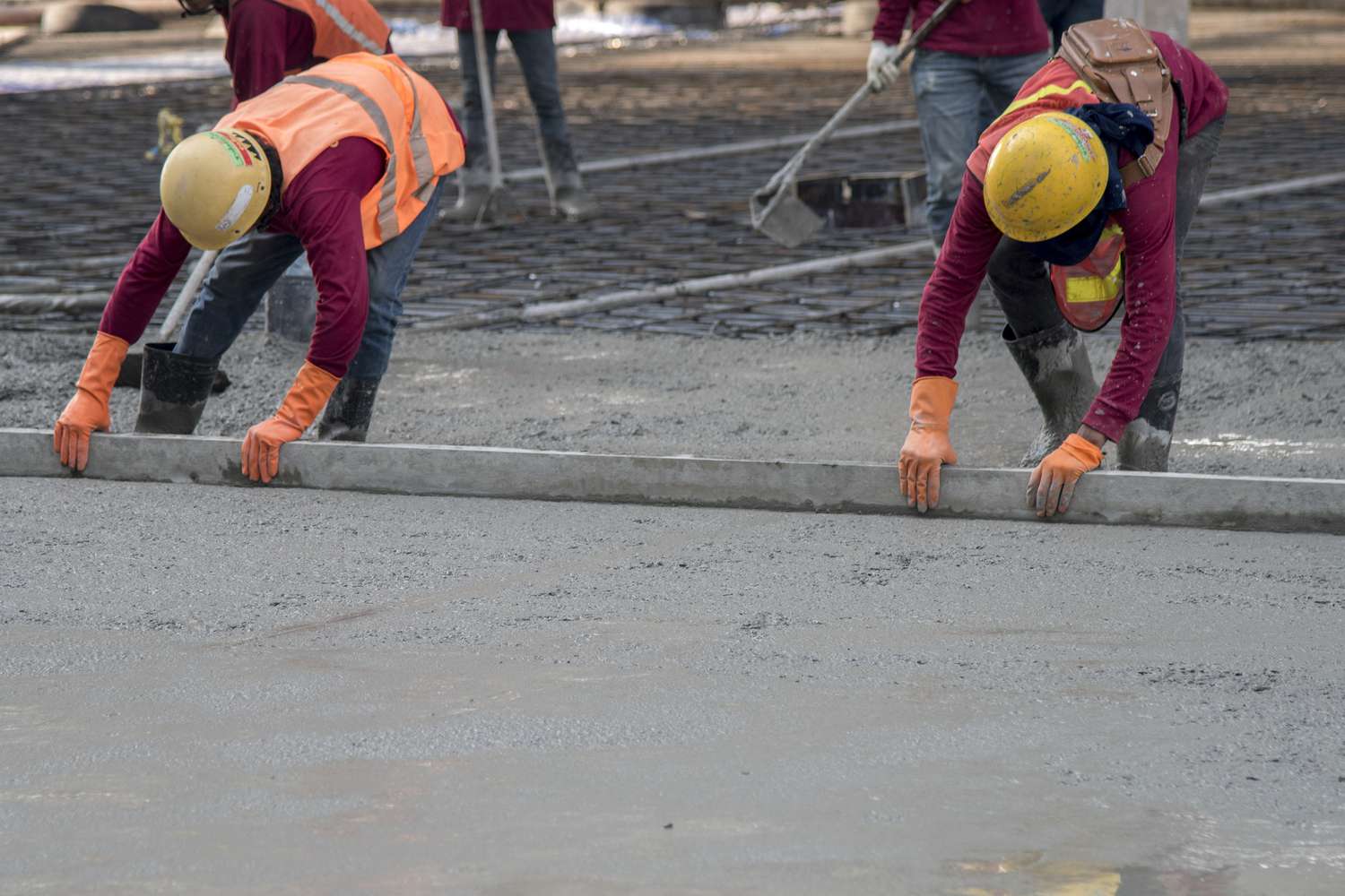

You may need a long board to level the wet concrete anyway. Put that across the top of the shuttering and put a  regular spirit level on top.
