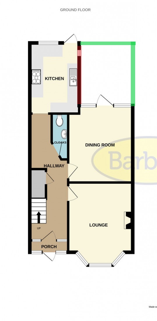

aaronl95 Posted February 14, 2023 Share Posted February 14, 2023 Currently we have a single storey flat roof extension on the rear of our 3bed semi detached which contains the kitchen, it's a bit pokey so I'd ideally like to extend this flat roof extension to be the full width of the rear of the house, is this possible under permitted development or would I need planning permission for this? The extension would not reach out further than 3m from the back wall of the house. Would basically like it to cover the full width of the rear of the house, single storey. Added a badly annotated pic: Green is the walls I'd like to add, red wall would need removing, what's your thoughts? Link to comment Share on other sites More sharing options...
PeterW Posted February 14, 2023 Share Posted February 14, 2023 Assuming not in an AoNB, Conservation area or similar, and no PD rights removed then yes using the neighbour consultation scheme. Link to comment Share on other sites More sharing options...
