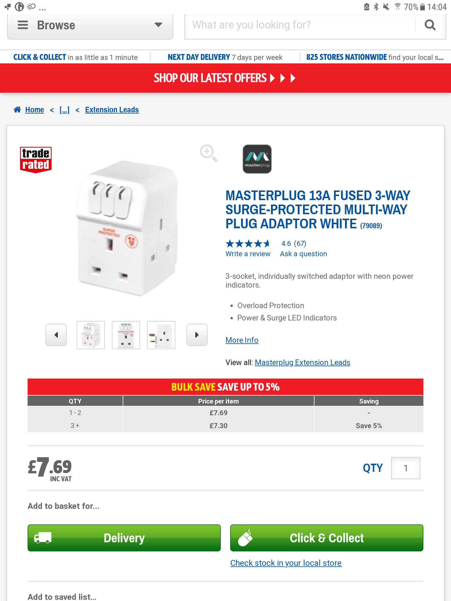

I've just had our Aqualisa shower repaired under warranty (3rd of 5 years).
After changing the valve module, he found it was actually a software problem.
Do you get many powercuts? Yes we are in the countryside.
So he changed a circuit module and it works.
He advised fitting a surge adapter, as the surge at reinstating power can be a problem.
I'm wary of using amazon as the spec's are vague.
But where it is clear, I see that most are only for electronics and should not be used for higher power: in this case a pump.
The only one i have found that seems ok is from screwfix.
The reviews include one saying they have a kettle on it, and another has garage doors. Why they need surge protdction i dont know...maybe they like the switches.
I don't need 3 outlets or any switches and could tape over to keep out spiders.
The pump is in the attic, with a dedicated, switched socket.
Any comments or advice?

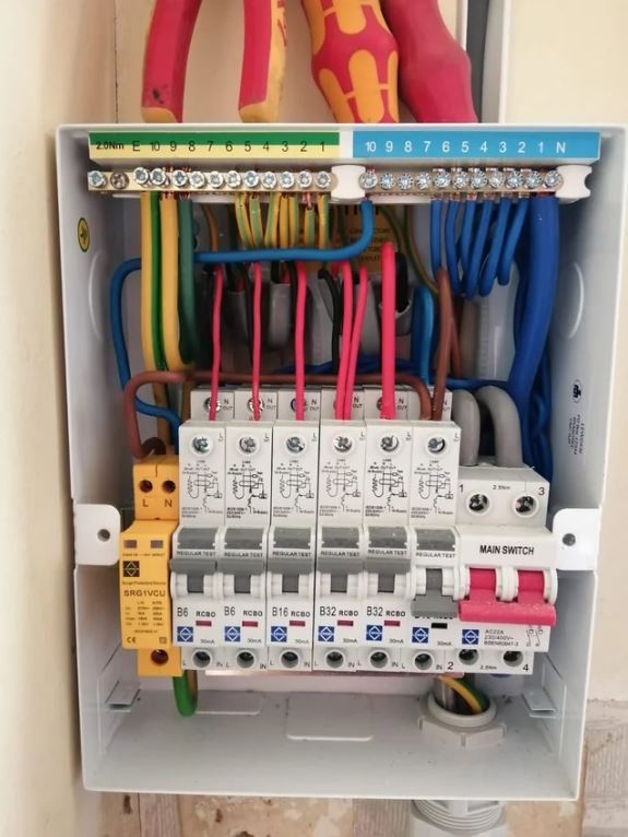

When you say your shower, do you mean and electric shower or do you mean a pump? What rating is it?
You could just fit a whole house surge device if you suffer powercuts and surges.
Depends on your setup you can put it in your board if space, or a little dual enclosure adjacent to the main board and wired into the consumer unit.

It needs to be a filter, vs a one shot SPD etc. That will give protection from frequent fluctuations, and not need expensive replacement by an electrician ( after every power cut / surge ).
The shower is a digital mixer so no big power supply. The one linked in Screwfix should be fine.
Or;
https://www.argos.co.uk/product/9473188

However, if he suffers these issues, and it is now commonplace and the regs (18th AM2) basically require that surge protection is installed in consumer units, I think I would install it.

It is pump only, with hot water from central system.
I can see from the instruction manual that it is a 3A fuse.
I saw the Belkin one at Argos and thought, known name, small and smart, that will do. But it is specifically for low power electronics, so I thought it won't be right for a pump.
Surge protection for small electronic keep your small electronic devices protected
And yet it is stated at 13A.
I would prefer to use this model but am wary.

It's mandatory, but wont solve this particular problem. The OP needs a filtered supply to remove spikes / soften disconnects when the grid drops. An SPD isn't for that and won't 'trip' in these instances ( or the world would go potty as that would be £200 or more each power cut, plus the wait for an electrician to attend to replace the SPD ). Remember that an SPD is a single shot device and blows like a HRC fuse would.

I have read the Belkin info on the Argos page again and see that it also says 'ideal for laptops, basic household devices, and small kitchen appliances'.
It would be good to have some numbers or examples instead of  'basic/ small'. But this is probably ok. (??)
For general interest, the one at SF seems to be ubiquitous, although with a variety of names, and is also at Wickes, Argos (cheapest and in stock), Dyas  and Amazon.

TBH I'd go for the Belkin, as it's rated at 13a and offers a guarantee against failure of devices plugged in to it. Download the MI's from Belkin and read up a bit to see if it says no pumps / inductive loads over x number of Watt's etc.

It basically sheds any excess energy, above a set point, to ground ( via the earth pin ) instead of dissipating it via a sacrificial component ( as an SPD does ). All good, give it a whirl.

It's not actually "mandatory" - the reg is certainly open to a bit of interpretation. I could think of plenty instances you could make it compliant without.
