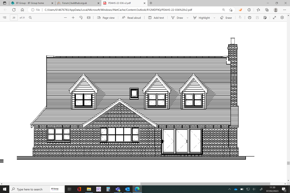

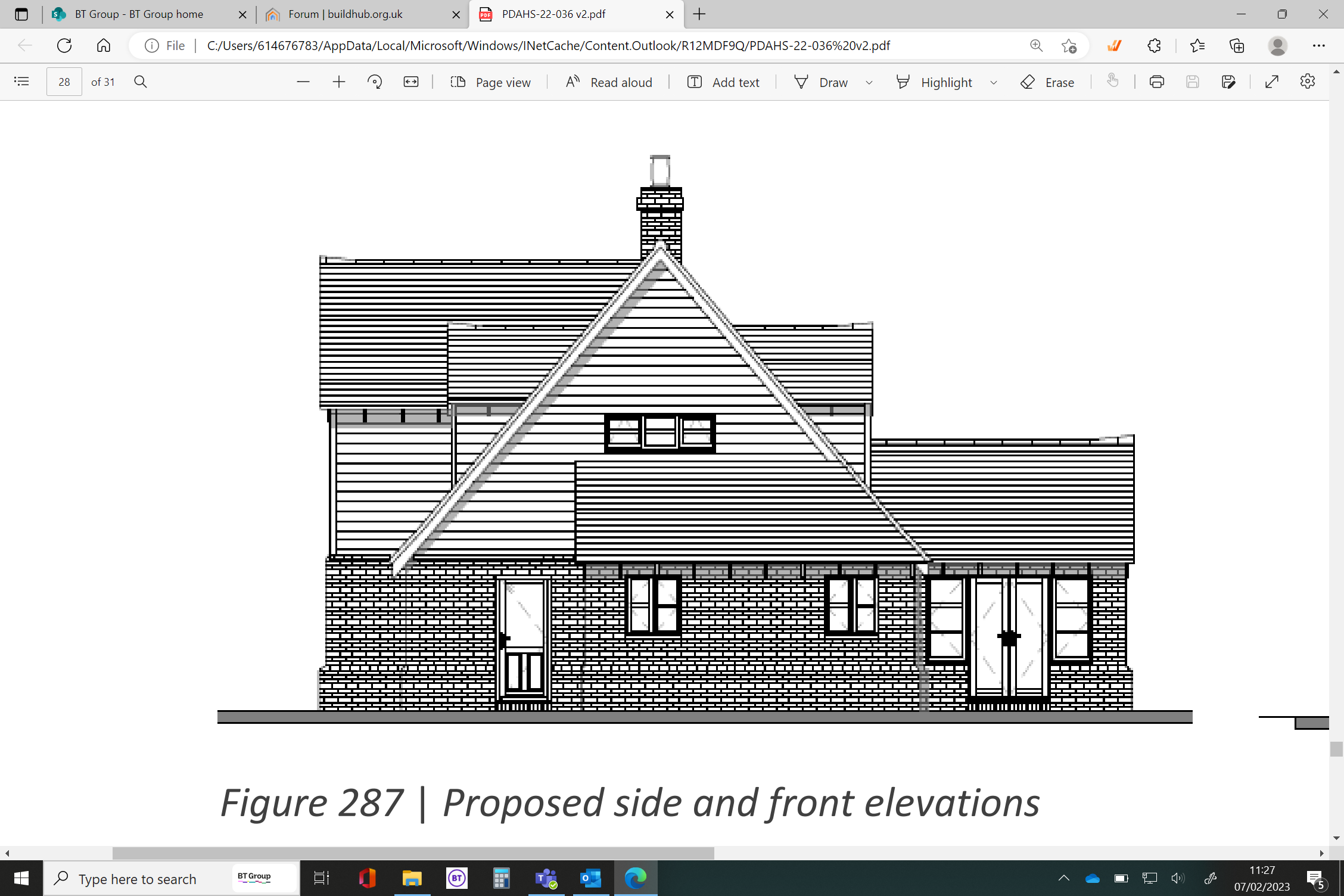

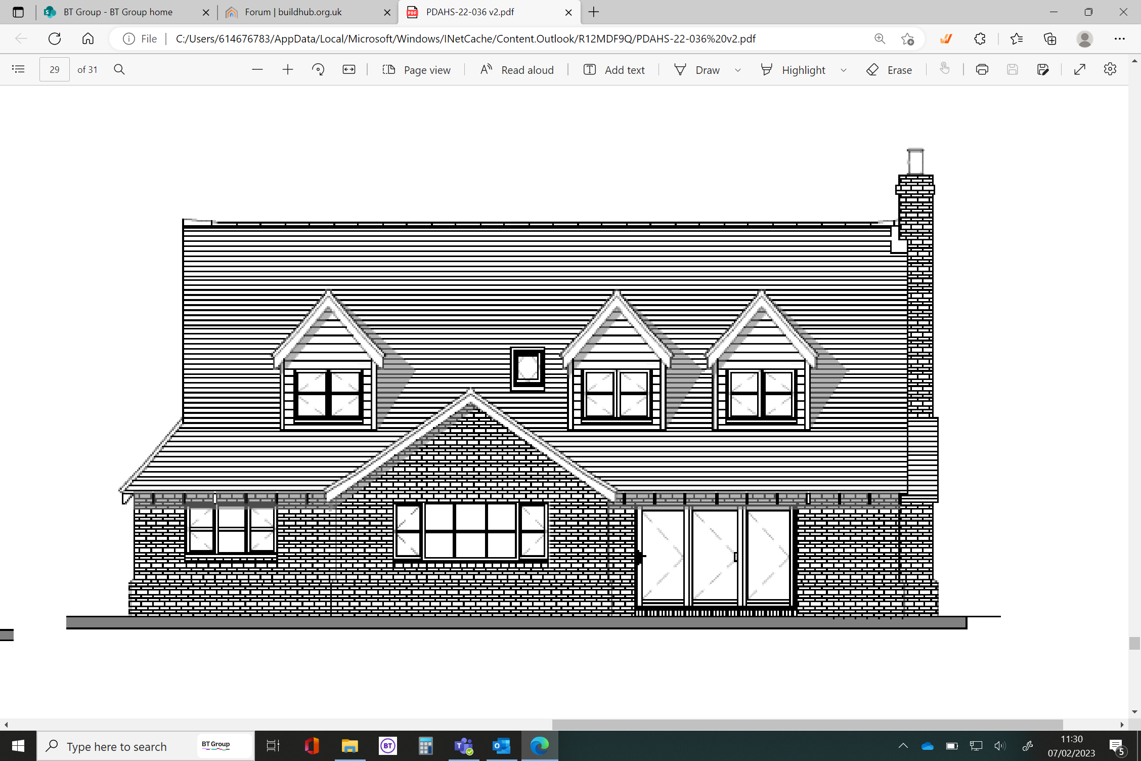

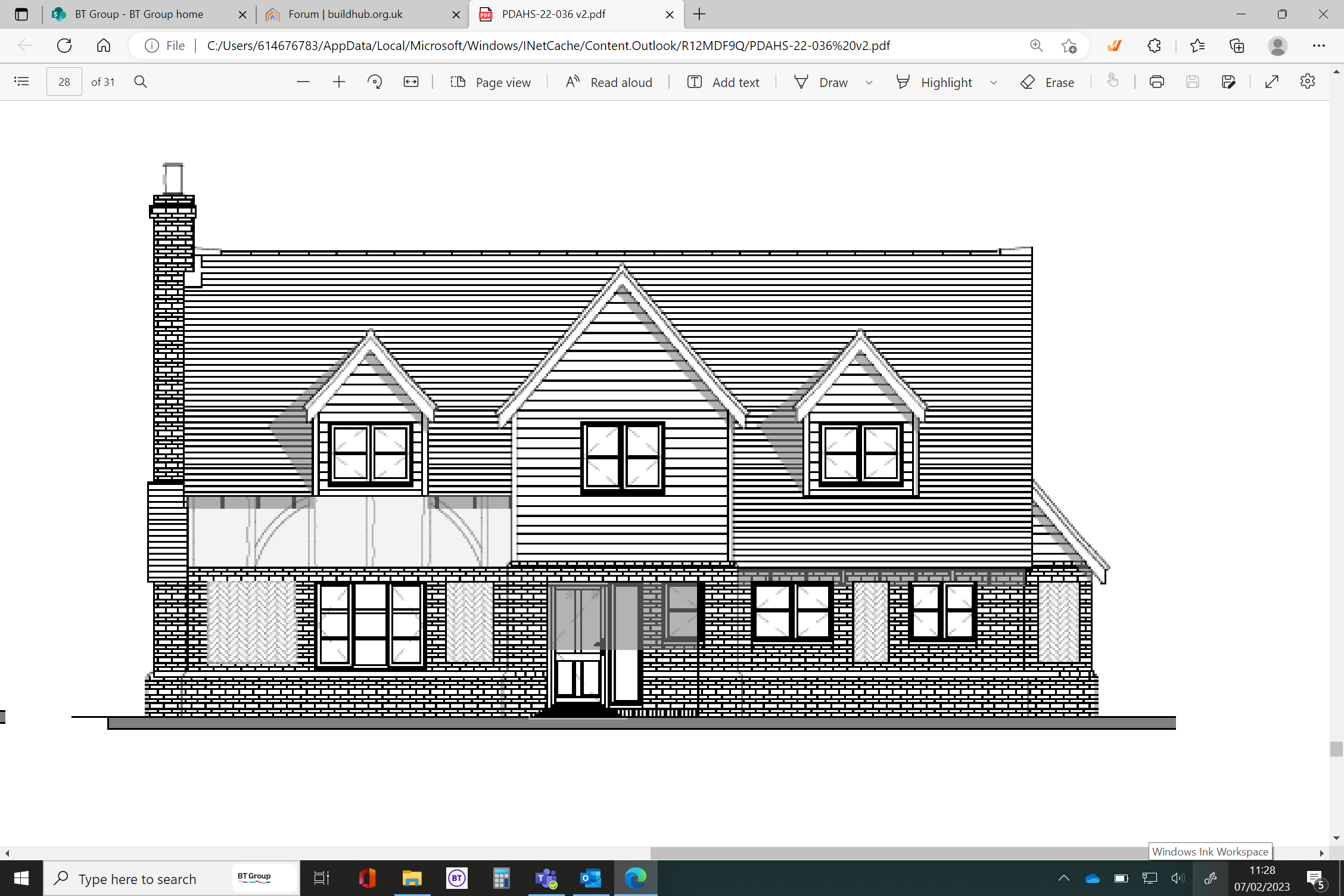

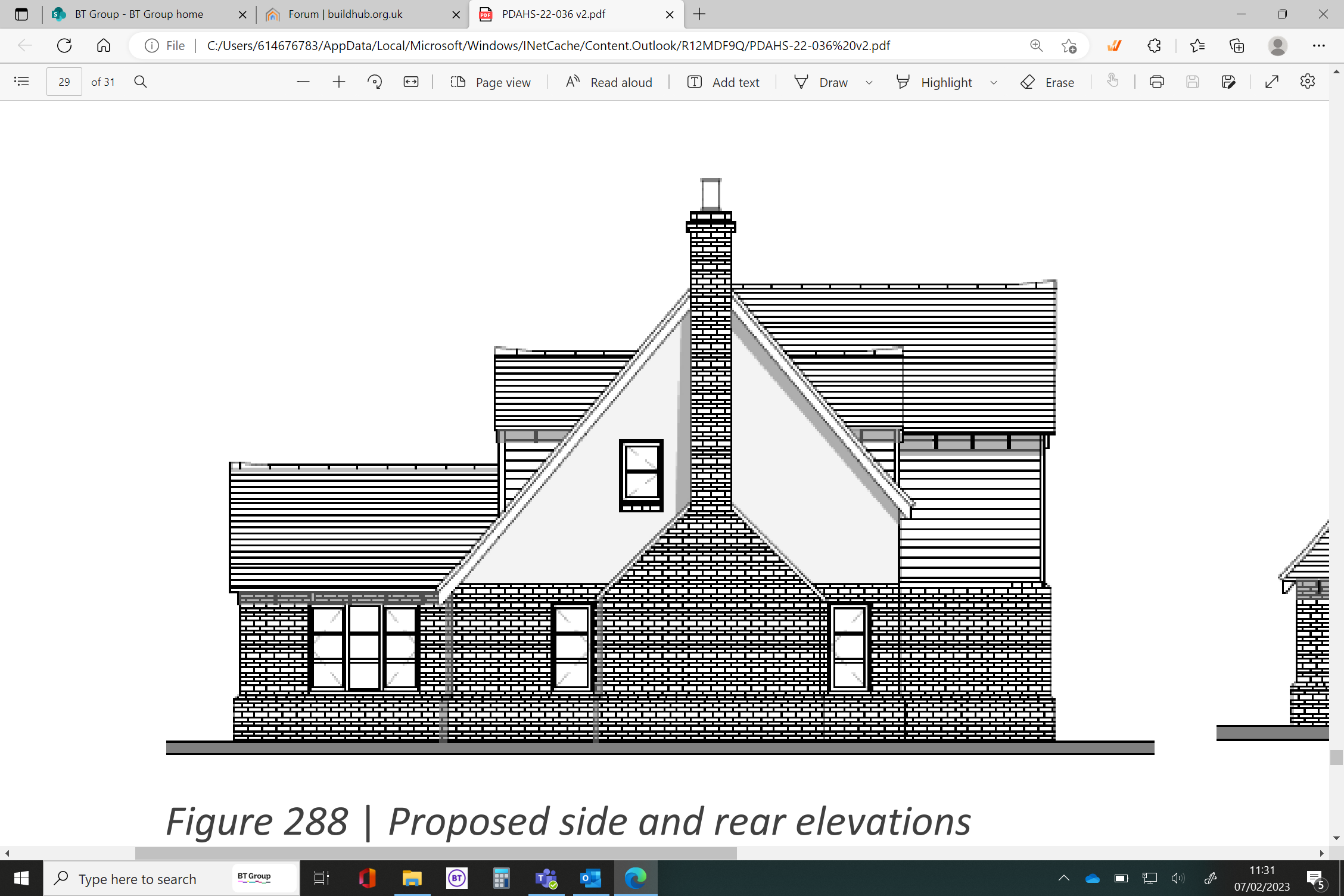

Post and beam Posted February 7, 2023 Share Posted February 7, 2023 I am beginning to gather info on my potential house build. I believe i need about 7500 bricks. Bear in mind that i dont know what i am doing though. As a guide to quantities the house is 200 sq M and 14.5 metres wide. Location is north Hertfordshire. Link to comment Share on other sites More sharing options...
eandg Posted February 7, 2023 Share Posted February 7, 2023 Rough guide here. You'll be anywhere between 50p and £1.50 a brick depending on what you want (common bricks through to handmade). Not knowing labour costs in your area budget for £1 per brick laid (N.B. usually costed to include the openings, so maybe 20% more or £9k). Plus then £800-1200 for ancillaries (lintels, dpc, weep vents, sand, cement). Link to comment Share on other sites More sharing options...
Post and beam Posted February 7, 2023 Author Share Posted February 7, 2023 4 hours ago, eandg said: Rough guide here. You'll be anywhere between 50p and £1.50 a brick depending on what you want (common bricks through to handmade). Not knowing labour costs in your area budget for £1 per brick laid (N.B. usually costed to include the openings, so maybe 20% more or £9k). Plus then £800-1200 for ancillaries (lintels, dpc, weep vents, sand, cement). Are you a brickie? does my guess at 7500 bricks seem reasonable looking at my drawings? Link to comment Share on other sites More sharing options...

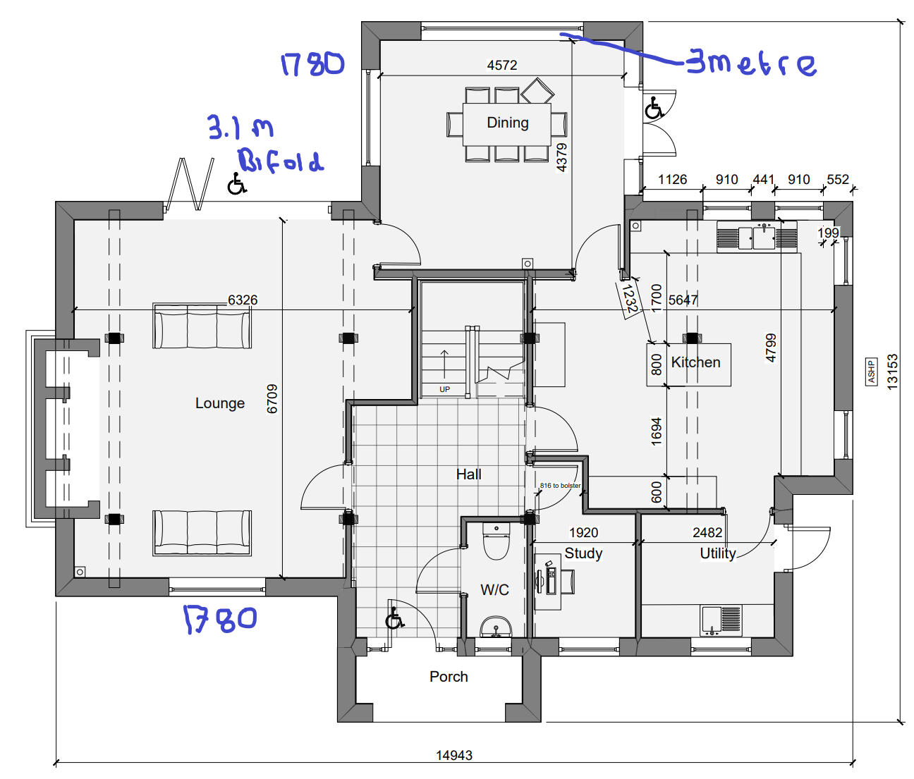

Canski Posted February 7, 2023 Share Posted February 7, 2023 I am a brickie and that sounds about right. Ive not measured anything today yet so if you gave me the dims or a ground floor plan and also ground floor window and door sizes I can have a quick look for you. Are they herringbone panels on the front ? Link to comment Share on other sites More sharing options...
Post and beam Posted February 7, 2023 Author Share Posted February 7, 2023 35 minutes ago, Canski said: I am a brickie and that sounds about right. Ive not measured anything today yet so if you gave me the dims or a ground floor plan and also ground floor window and door sizes I can have a quick look for you. Are they herringbone panels on the front ? Hi Canski, Yes herringbone. The one on the far right has been deleted. The kind of costings i am looking for are for the quantities of bricks and price to lay them. Not for supply, unless that turns out to be the right way to go. Link to comment Share on other sites More sharing options...
Canski Posted February 7, 2023 Share Posted February 7, 2023 (edited) Well done ! I make it 6959 at a rough guess add 5% cutting and waste gives you 7307. I'm sure you're aware that your ground floor plan doesn't match your elevations ? @eandgis about right with pricing for my area. Edited February 7, 2023 by Canski Link to comment Share on other sites More sharing options...
Post and beam Posted February 7, 2023 Author Share Posted February 7, 2023 17 minutes ago, Canski said: Well done ! I make it 6959 at a rough guess add 5% cutting and waste gives you 7307. I'm sure you're aware that your ground floor plan doesn't match your elevations ? @eandgis about right with pricing for my area. Yes dude, there have been a few alterations to windows. The TF company made some choices of their own regarding where and what size we might want windows. There may well be a few more minor alterations as well. Your number is very precise. I guess you noticed the 'plinth' bricks. So if i can get bricks delivered kerb side Inc Vat @ £1.20 each and then that much again for the fit i should have a reasonable price guide for this part of the job. By the way there is a huge inglenook as well. Link to comment Share on other sites More sharing options...
Canski Posted February 7, 2023 Share Posted February 7, 2023 I missed the plinth that would be a small extra lin m rate but should be covered in previous rates. Add the inglenook bricks to my calcs. Zero rated VAT on new housing. Link to comment Share on other sites More sharing options...
