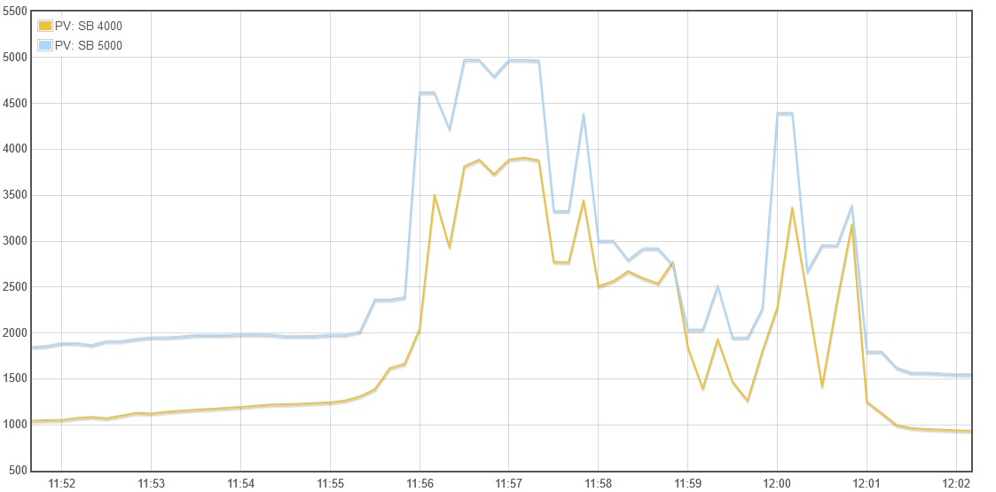

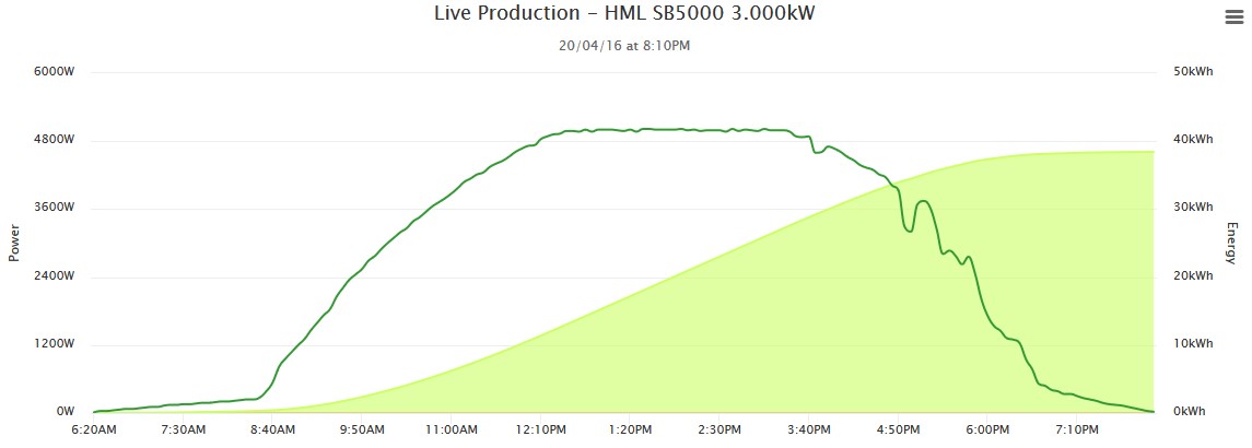

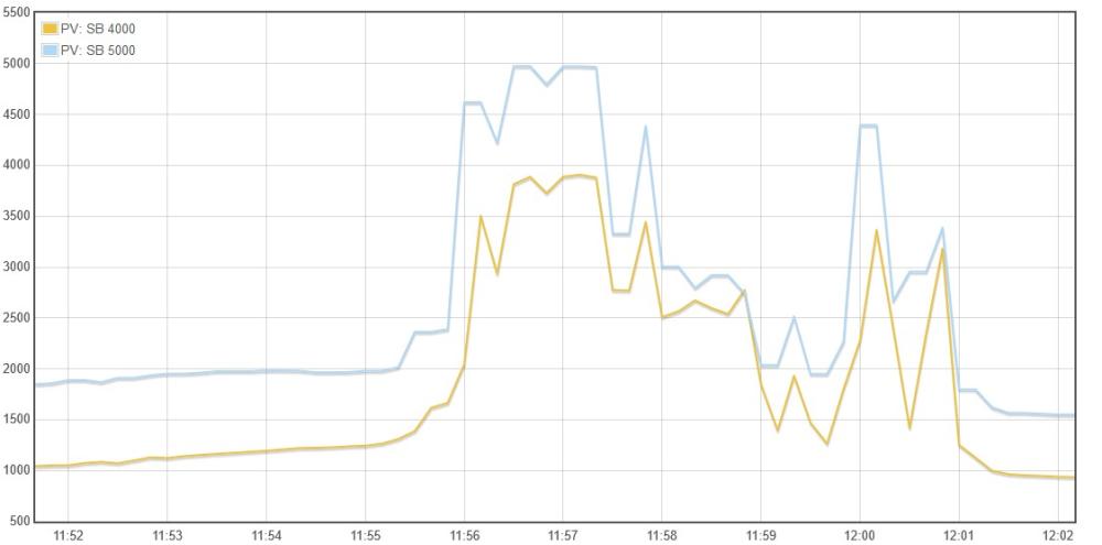

billt Posted February 6, 2023 Posted February 6, 2023 Here's an example of what actually happens to the output. It limits at 5kW in the middle of the day. The SMA Sunny Design web site lets you try various combinations of inverter and panel and will tell you if there is a significant mismatch. https://www.sunnydesignweb.com/sdweb/#/
JamesPa Posted February 6, 2023 Author Posted February 6, 2023 7 minutes ago, billt said: Here's an example of what actually happens to the output. It limits at 5kW in the middle of the day. The SMA Sunny Design web site lets you try various combinations of inverter and panel and will tell you if there is a significant mismatch. https://www.sunnydesignweb.com/sdweb/#/ Thanks, is this an actual measurement or a prediction from SunnyDesign? If the former can you tell me precisely the inverter model please? Installer very sceptical although all the evidence seems to support the clipping you show.

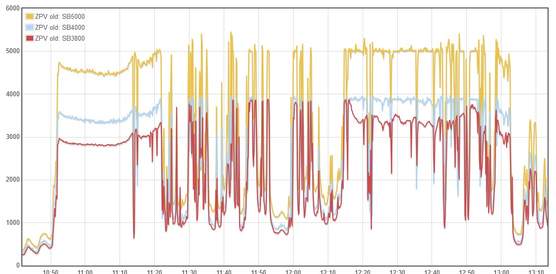

billt Posted February 6, 2023 Posted February 6, 2023 (edited) They are actual measurements. It's the reported output from the inverter sent to PVoutput.org at about 5 minute intervals. That was an SB5000TL-20, no longer current, it was installed in 2013. Here's another example. This has the SB5000TL-20, an SB4000TL-20 and an SB3800. The SB3800 is a transformer inverter and was installed 2 years earlier. The nominal array is 3870 watts, so only clips very occasionally. This is measurements of the AC output and much more frequently. You can also see that the SB5000 has brief overshoots sometimes. I've found an instance of the current inverters limiting. They are an SB5.0AV and an SB4.0AV. It doesn't happen very often because of the panel orientation, and lack of oversizing on the SB4.0. I take it that your installer hasn't been doing this for long. It used to be very common to undersize inverters for the array. Edited February 6, 2023 by billt Added image.

JamesPa Posted February 6, 2023 Author Posted February 6, 2023 3 hours ago, billt said: You can also see that the SB5000 has brief overshoots sometimes. Can you clarify what's going on here with the oscillating output. Is this clouds passing or the inverter cutting in and out?

billt Posted February 7, 2023 Posted February 7, 2023 9 hours ago, JamesPa said: Can you clarify what's going on here with the oscillating output. Is this clouds passing or the inverter cutting in and out? Yes, that's cloud, i.e. a normal days output. The first image was very unusual, a day with unbroken sunshine.
