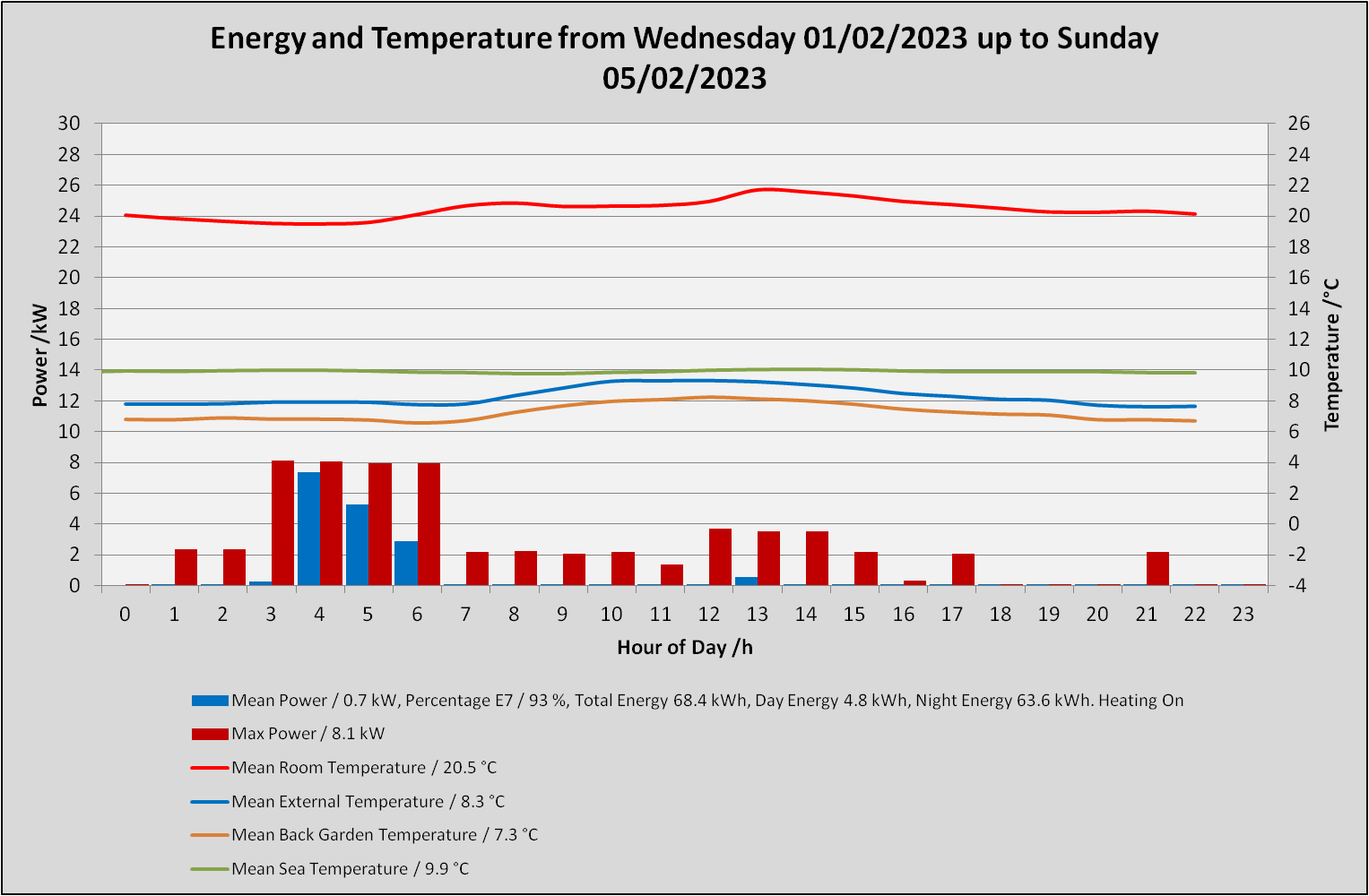

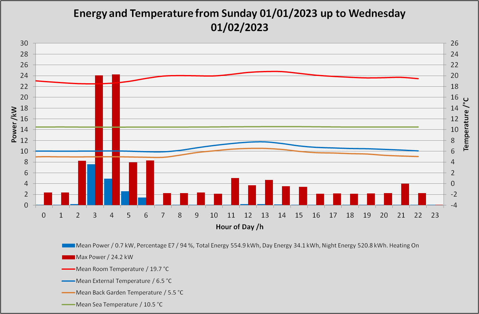

As we enter, what is traditionally the coldest month down here, and because I like trying out simple changes to see what happens.  I have shifted my E7 heating window from 3 AM to 7 AM (GMT) to 4 AM to  7 AM (GMT).

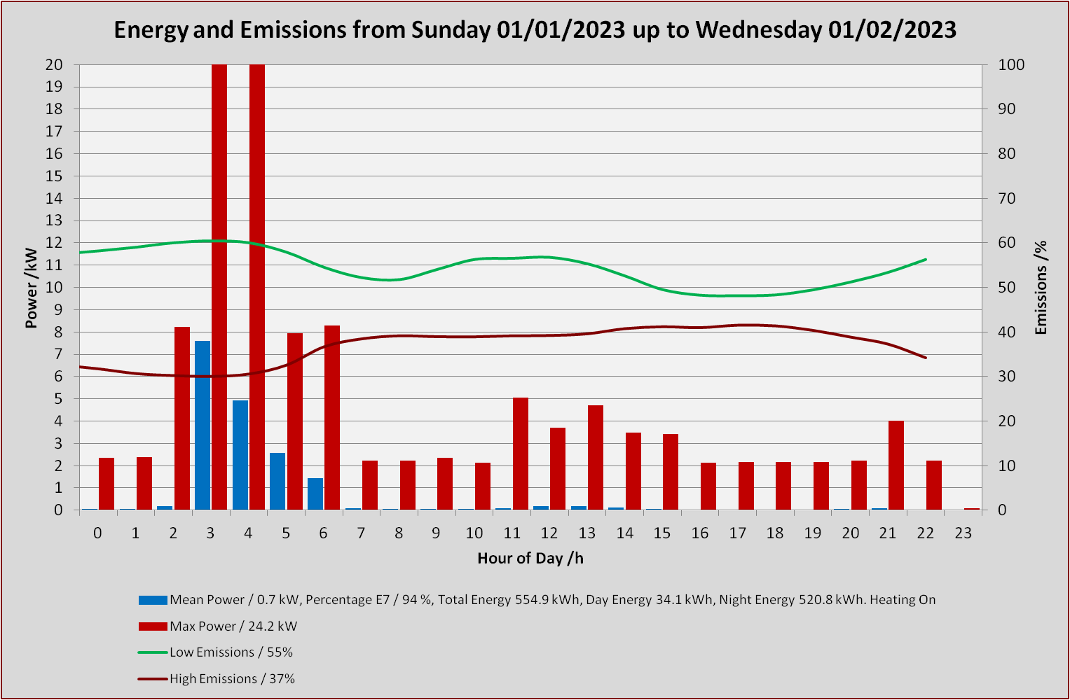

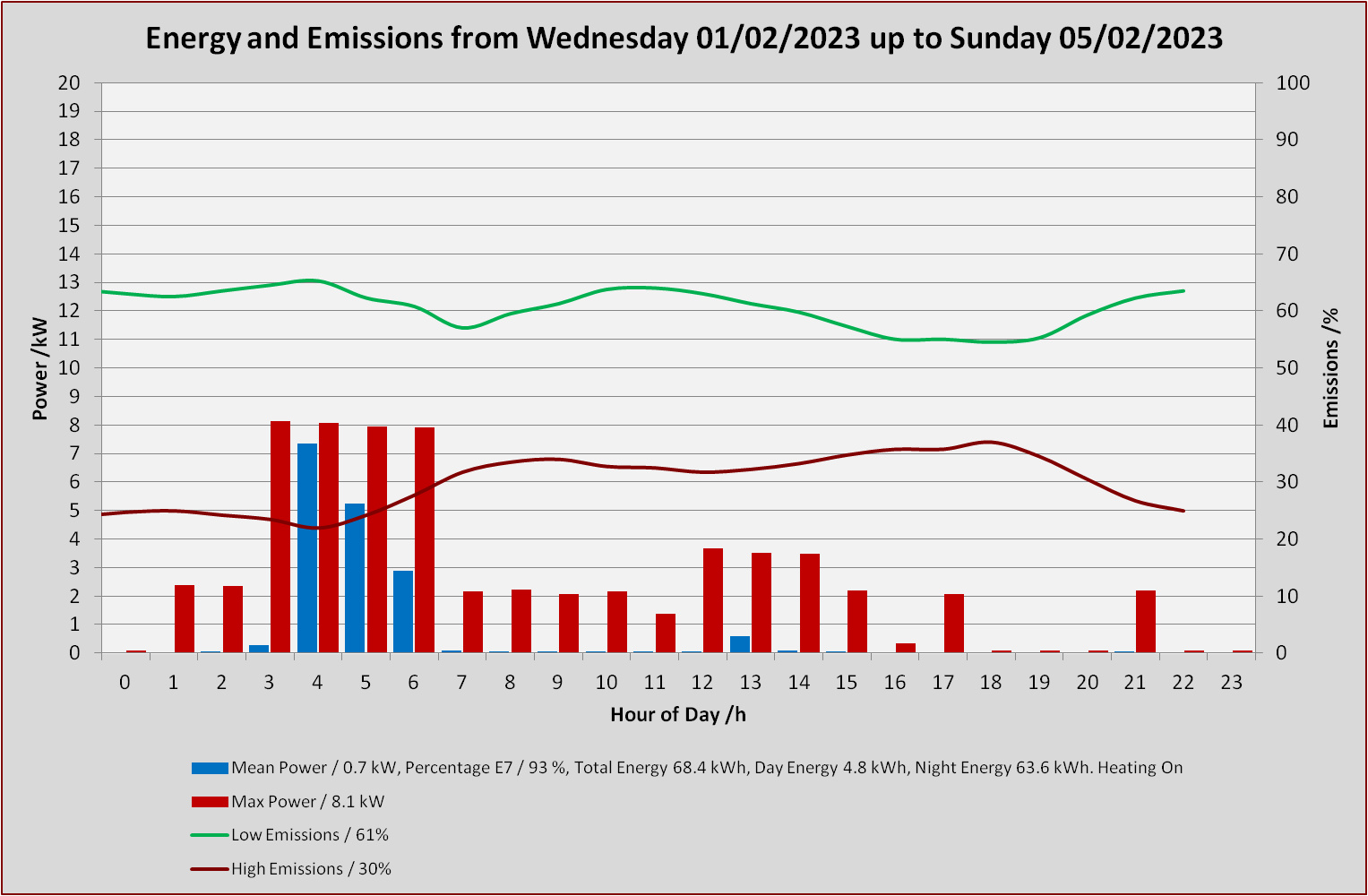

This is party because I noticed that all the heating had happened before I was out of bed, and party to try and use low CO2 generation, which is what the ultimate goal of us all should be..
So as usual, a couple of charts to show the difference.  Early days yet,
And CO2 charts.

I should have a better resolution in a week or two as I fiddled a bit with the storage heater input. I had turned it down a bit too low.
Outside air temperature has been a bit up and down as well. Ideally need at least 25 samples in each temperature bin to get reasonable accuracy.
