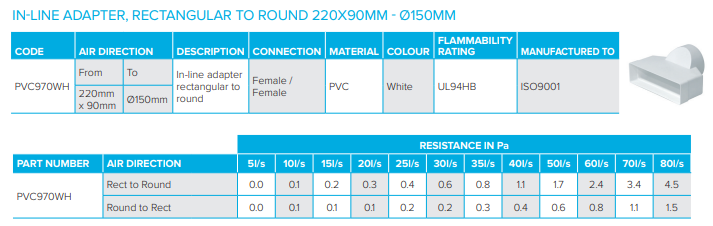

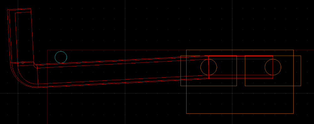

Our kitchen design has two side by side cooker hoods. Is there such a thing as an Inline Rectangular to Round 90 degree bend to put in the left hand hood as in the first image below or do I have to have them both bend/tee onto a straight run as in the second image. The blue circle is a soil pipe I have to get round and the dark brown lines are the wall surfaces of the kitchen.

Thanks @Nickfromwales, I've seen those parts from other suppliers and I can't see an Inline Rectangule to Round Tee. I was think along the lines of a straight section of rectangular duct with a spigot in the bottom for a 150mm Round to join. I guess I join the two extractors in 150mm Round and then adapt to Rectangular instead.
Any reason Rectangular can't be used on its side, so the 220 or 204 dimension is vertical?

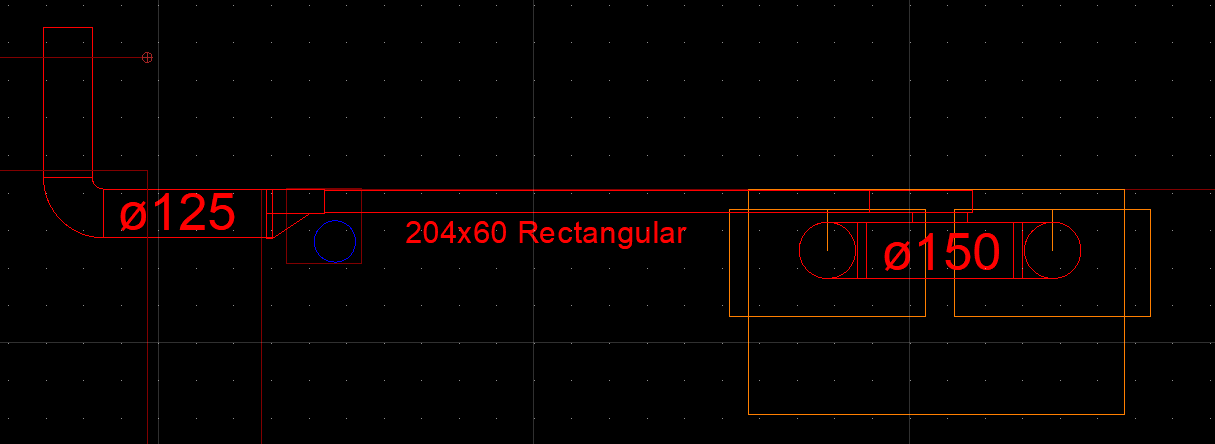

Here's what it would look like using Rectangular ducting on its side:
Passing from one of the extractors:
  • 150mm Round Straight 600mm
  • 150mm Round Bend
  • 150mm Round Straight 200mm
  • 150mm Round Tee
  • 150mm Round to 204x60 Rectangular Spigot
  • 204x60 Rectangular Straight 1450mm
  • 204x60 Rectangular to 125mm Round Adaptor
  • 125mm Round Straight 450mm
  • 125mm Round Bend
  • 125mm Round Straight 350mm
  • 125mm Round Vent/Grating
I read bends count as 1.2m equivalent. This has 4 bends so overall is equivalent to 8m straight length of 204x60 I'd guess. I've read it should be kept under 5m equivalent, but is there a building reg that needs satisfying?

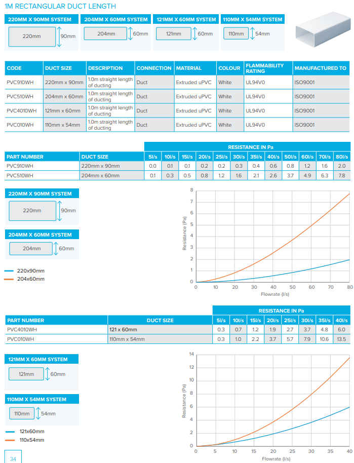

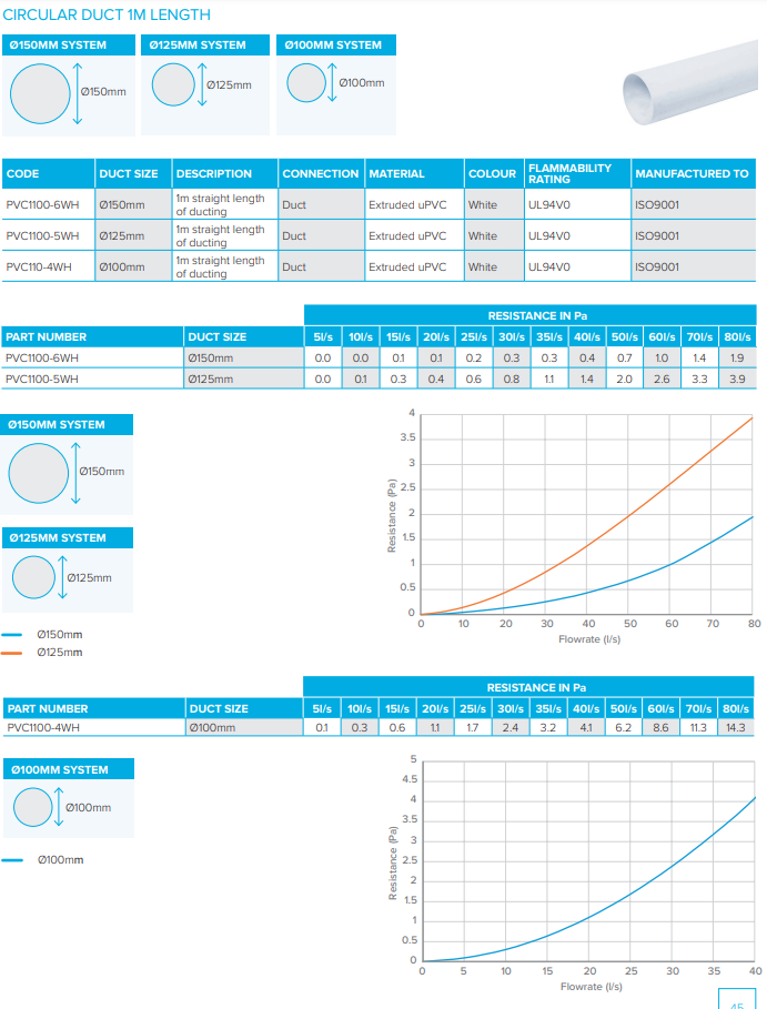

Posted
Here's a comparison of ducting resistance per metre for different types. At 288m3/hr it works out as:
                            144m3/hr  288m3/hr
150mm Round     0.4Pa      1.9Pa
125mm Round     1.4Pa      3.9Pa
100mm Round     4.1Pa      14.3Pa
220x90 Rect       0.4Pa      2.0Pa
204x60 Rect       2.1Pa       7.8Pa
121x60 Rect         6.0Pa        -
110x54 Rect       13.5Pa        -
http://www.nuaire.info/catalogue/Nuaire_Ducting_Specification_Guide.pdf

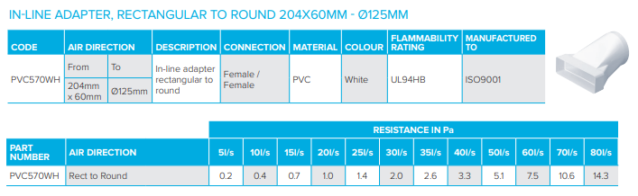

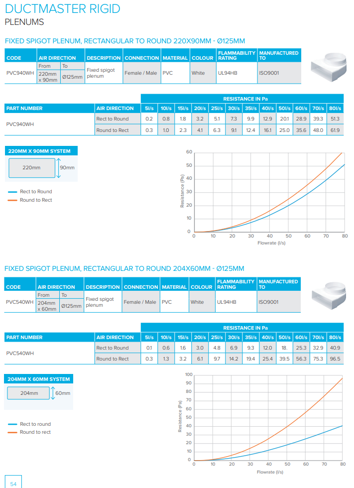

Posted
Using the values in that Nuaire PDF, the total resistance becomes:
  • 150mm Round Straight 600mm   1.1
  • 150mm Round Bend   16.6
  • 150mm Round Straight 200mm   0.4
  • 150mm Round Tee   14.5
  • 150mm Round to 204x60 Rectangular Spigot   90est. <<<<
  • 204x60 Rectangular Straight 1450mm   11.3
  • 204x60 Rectangular to 125mm Round Adaptor   14.3
  • 125mm Round Straight 450mm    1.8
  • 125mm Round Bend   26.4
  • 125mm Round Straight 350mm   1.4
  • 125mm Round Vent/Grating   ??
  • TOTAL: 177Pa @ 80l/s (288m3/h)
Half of that is from the plenum (aka "150mm Round to 204x60 Rectangular Spigot") which you'd almost always have in a system using rectangular ducting.
Posted (edited)
____________
____________
____________
From these, I'd guess 150mm Round to 204x60 Rectangular using a 150mm Round Bend and then Adapter would be about 30Pa @80l/s so much improved over the Plenum (~90Pa @ 80l/s) if space allows.
