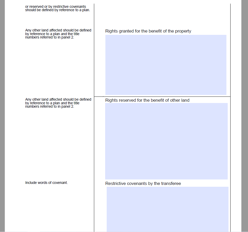

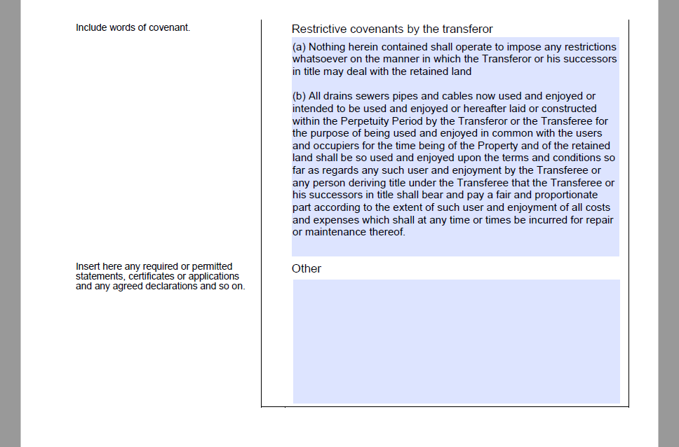

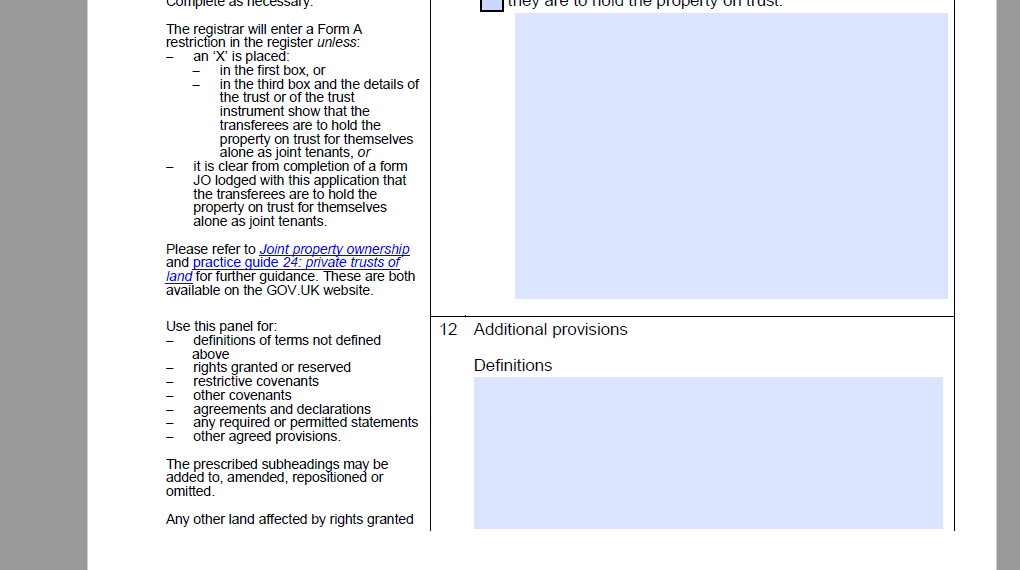

MoDo Posted February 1, 2023 Author Share Posted February 1, 2023 (edited) One more question please: Filling out the TP1 - I found a covenant on here that fits with our situation perfectly - ie to protect my parents retained house and garden going forwards after we split off half. However I'm not sure if I've entered it in the correct box or in the correct format. Any one able to advise? EDIT: Just to clarify - the covenant I'm referring to, is the one I've entered into 'Restrictive covenants by the transferor' - but need advice if this is the correct place for it and whether I need anything entered in addition in 'Definitions'? Edited February 1, 2023 by MoDo Omission Link to comment Share on other sites More sharing options...
