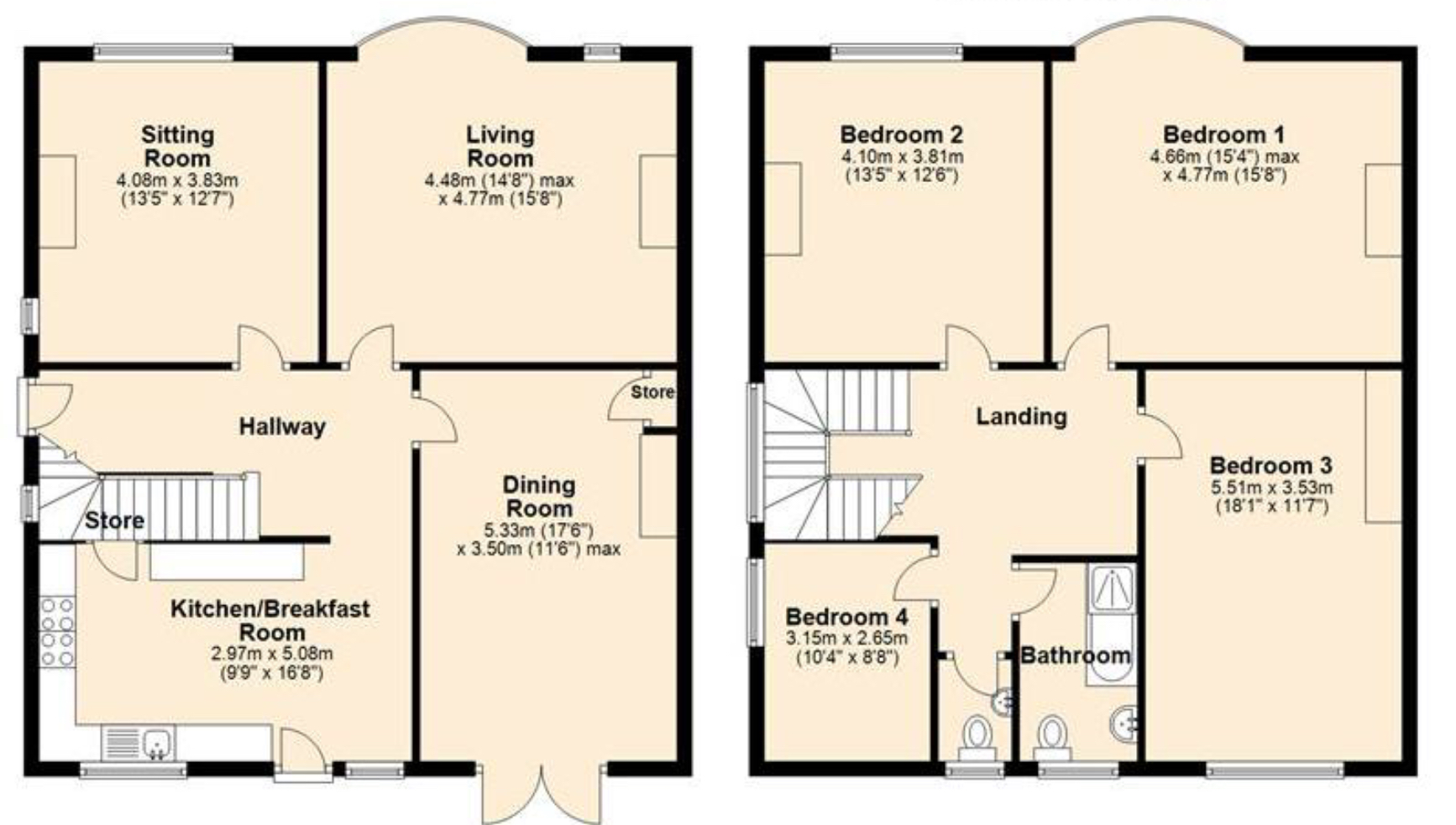

I have attached a copy of the existing floor plans. The bay windows are to the front which faces east and main entry to the house is via the side.

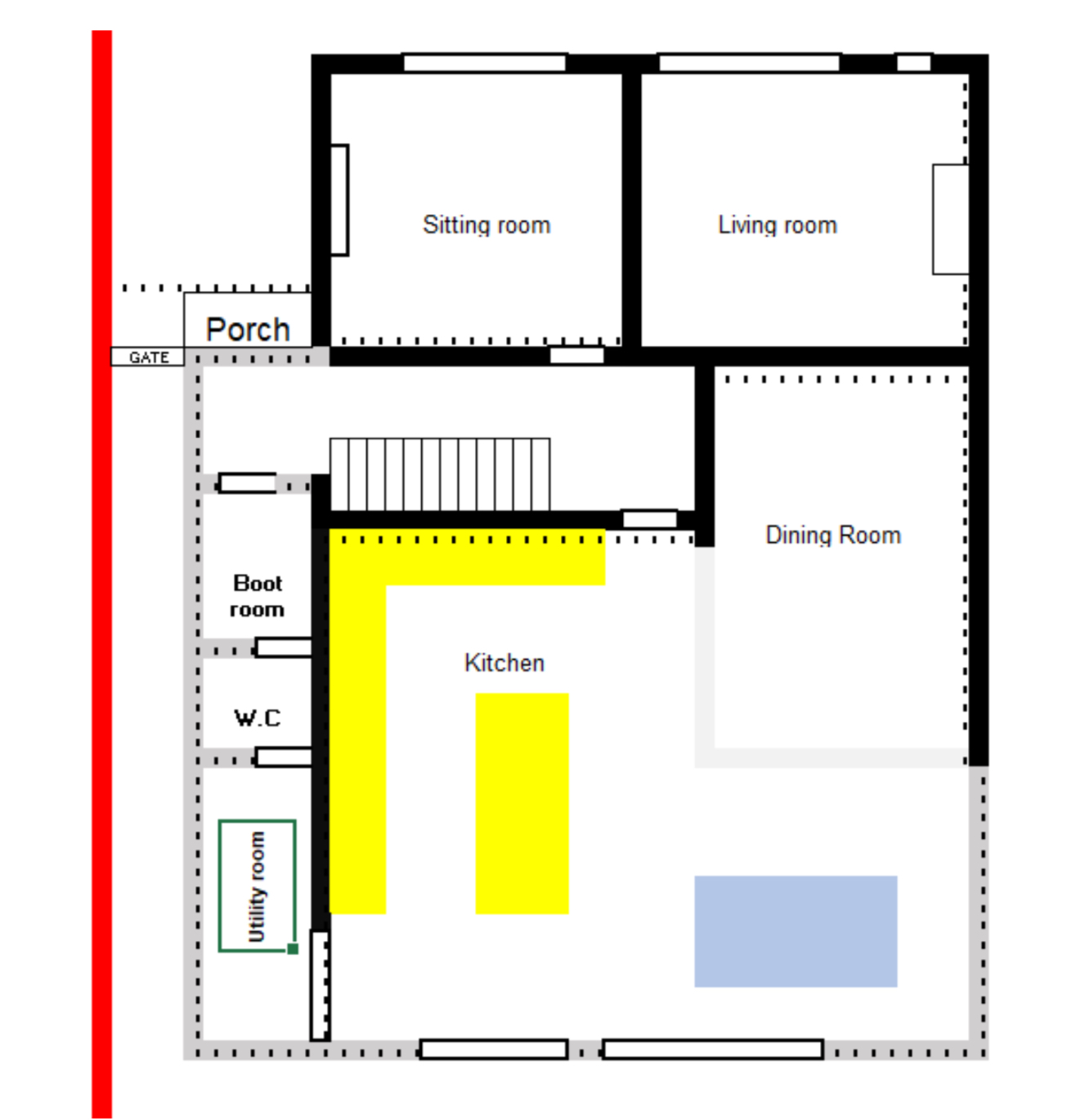

Downstairs I'd like to add a porch, boot room, WC and utility room (potentially via a side extension). I'd also like to combine the back two rooms with an extension to house kitchen/diner/living area. We have no restrictions to the rear as there is a very large garden, however, we only have 2.8m from the side of the house to the neighbours boundary (marked with a red line in my mock ups) and we'd like to retain rear access of approx 1m.

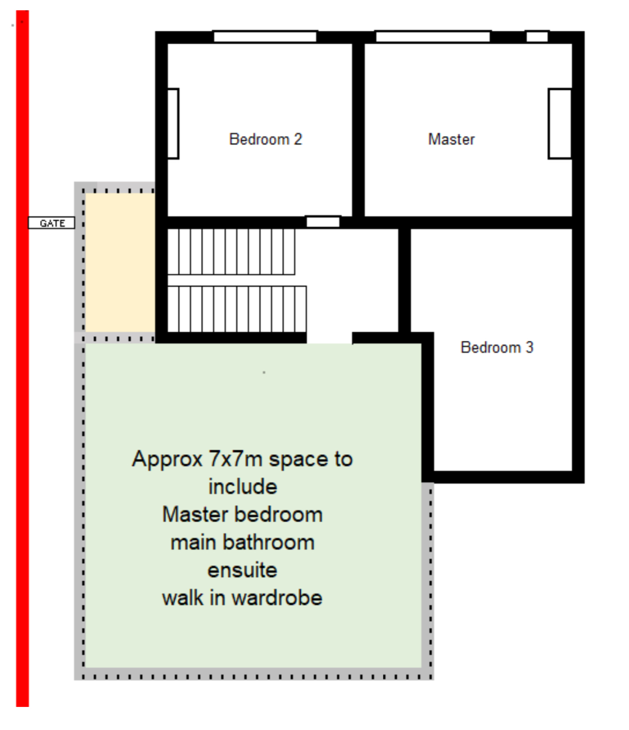

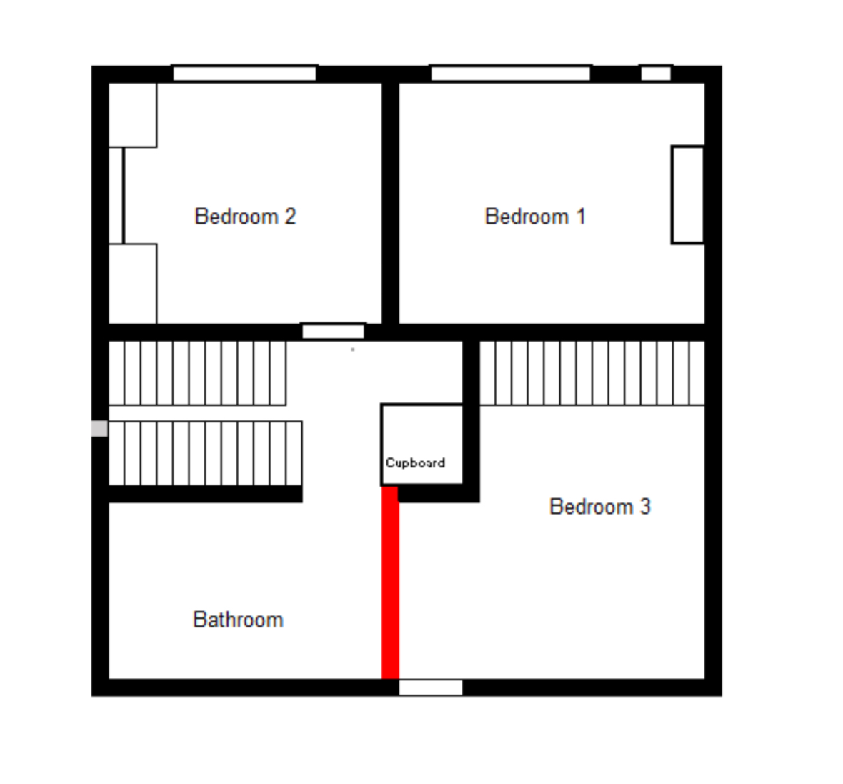

Upstairs I'd like to make the main bathroom larger and add a master bedroom with en-suite and walk in wardrobe to the rear. The two options we have considered here is a double story extension over the existing kitchen (upstairs image 1), or an attic conversion, with the stairs going through existing entry to bedrooms 3 (upstairs image 2).

Bit of a loss of light in bedroom 3 and first floor stairs? Depends what your plans were with the new wall I suppose or roof.

@twice round the block I don’t have any plans of the attic but if we did this over a double story extension then ideally the stairs would run through bedroom 3 as per the last image. This would prevent losing light and aesthetics from the window on the current stairs from ground to first floor.
we thought maybe an attic conversion maybe less costly than adding a double story extension. But I’m a complete novice in this field.
@larrythere would be no light lost in bedroom 3 as this room adjoins the neighbouring property. Potentially running the stairs to the attic through the back of this room, we thought would preserve light on the landing as we have a large window over the current ground-1st floor staircase.

Ah OK, I wondered if it would it be potentially overshadowed by the extension?  ☺️ But if the neighbours are to the south and they don't have anything sticking out that makes sense
Don't quite understand this but can't completely get my head around your attic plans (me not you!)

Other thought, access to drains OK for your downstairs WC in that location.

And If option 2, roof above blue square would be what? Top Needs to be below window for bedroom 3
Is wall between existing dining and kitchen bearing any load?
