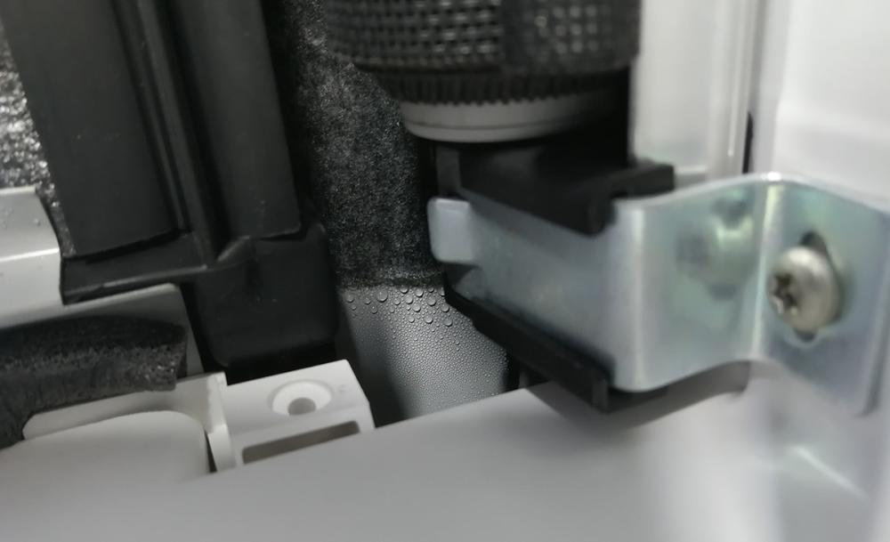

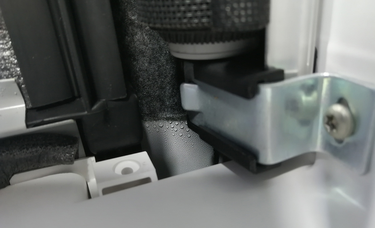

I am struggling to get a measure of whether it is or it isn't. I haven't got a blower door made yet so I'm reliant on strong winds in the right direction, and the weather's not been cooperating.

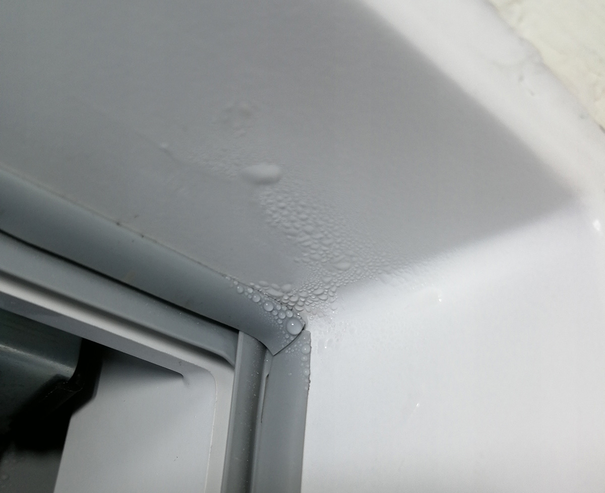

It could be a cold spot. The 19th was another cold day and this time I opened the windows. I wanted to see if the condensation stopped at the rubber seal or went up the frame alongside the pivoting bit containing the glass (whatever that is called).
At the bottom there was the bigger patch of condensation again. I am satisfied these are cold bridging. Here, the condensation stopped at the line of the rubber seal. All along the rubber seal position was a line of condensation but it didn't extend above the seal. Fair enough.
At the top corners the condensation went up further all the way to the external seal (the rubber gasket round the pivoting bit comes at approx 1/3 of the height down the white frame here)
There was also frozen condensation further up in the window
To me the fact the condensation doesn't stop at the seal says there is an air leak at the top corners. Whether I can make Velux understand that the condensation isn't the problem and what it shows is, I doubt it.

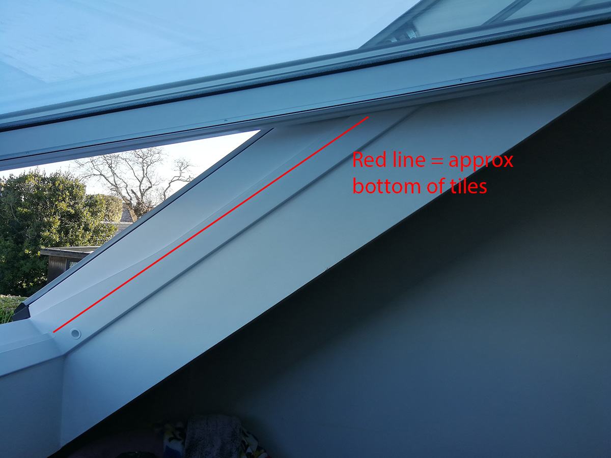

On 19/01/2023 at 22:46, Radian said:
Could do with a photo showing the velux in context with the reveal and roof but the rafters must be in the region of 175mm? With only 50mm PIR between rafters (none underneath the plasterboard crossing the rafters?) some of the reveal would seem to be flanked by almost direct contact with outside air (assuming ventilated rafters).
Here you go
From the eaves on the en-suite side of the room, it will be 100mm air gap and 50mm PIR, and then plasterboard.
But here I would hope there's PIR against the wood forming the window surround. And then more given the depth. I don't want to strip off the plasterboard when other places are far colder but it is on my list for "maybe one day"
How wide is the window reveal? I'm thinking about the spacing of rafters and if it's between a pair (~550mm) or if it cuts through one (>600mm)
The width is 890mm.
Measuring up the side of the window reveal is 14cm to the edge of the Velux frame / 18cm to the pivoting window. I am curious what's in there, might have to drill an inspection hole and have a look.
