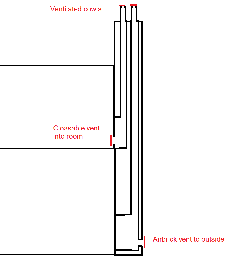

The disused open chimney will need ventilation to prevent damp. Usual approach is a closable vent into the room and a ventilated cowl at the top. However, you can seal it to the room if you can put a vent on the outside of the wall into the flue. That's what I did with my upstairs disused flues.
Spray foam I wouldn't use - just frame it out and tight fit insulation board.
