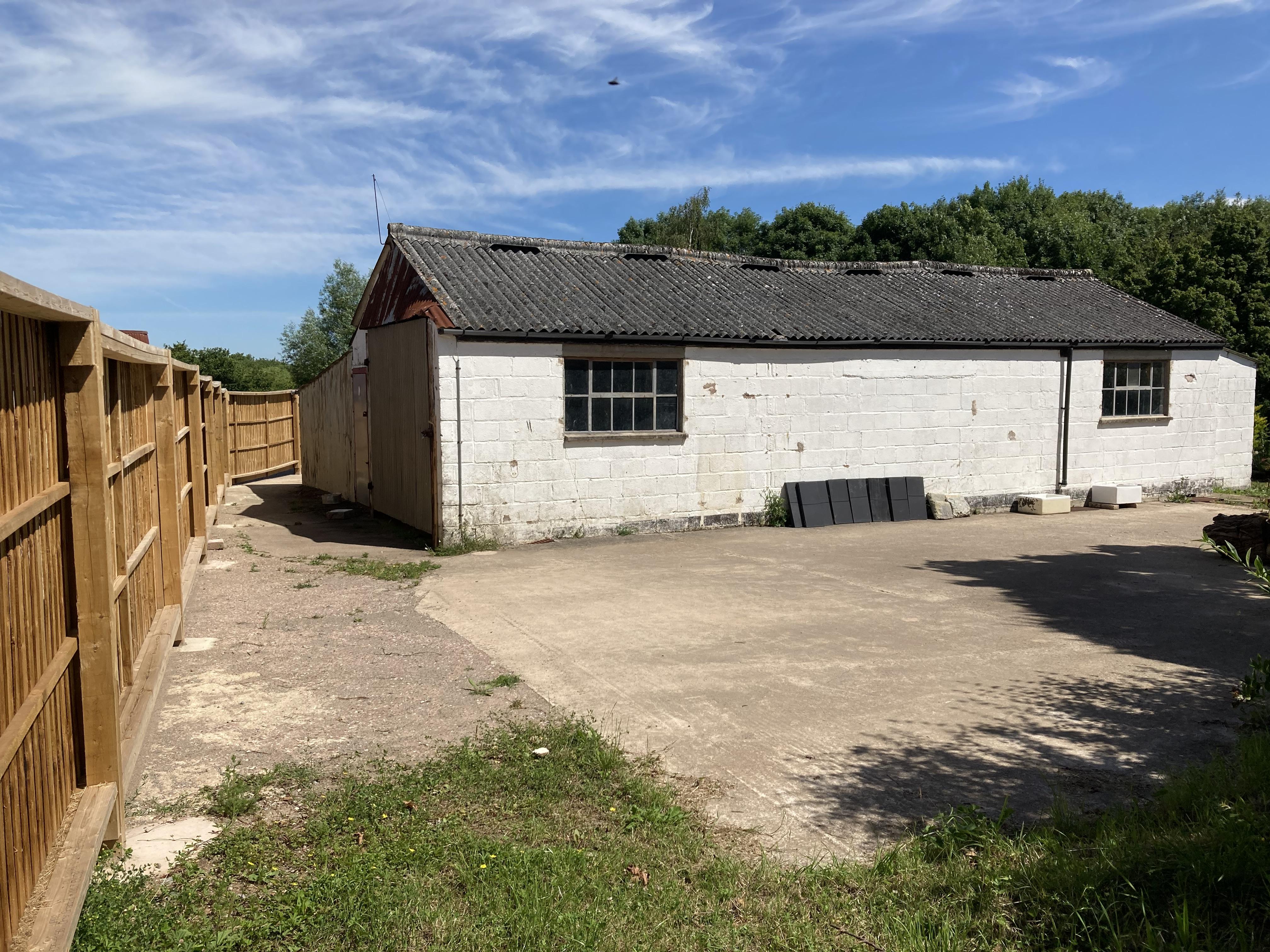

Somersetcider Posted January 9, 2023 Share Posted January 9, 2023 (edited) hi all just wondered if anyone had any experiences of planning under section 80 "the development would re-use redundant or disused buildings and enhance its immediate setting" we have barns 1&2 with a lean to that joins them together (pics and drawings attached). we would like to convert to a 2 bedroom house unfortunately we cant use class q as there isn't an existing agricultural access anymore as the neighboring site has been developed. so a new access needs to be formed and this will be over residential land (part of my parents garden goes over the front). Originally we wanted to demolish and put a new build there during pre planning even though the design was well received and the access isn't an issue the officer has said this wouldn't be supported by local and national planning policy as its classed as open countryside and we haven't got a fall back position. i think now i potentially wouldnt be able to get enough funds together to go the new build route so im looking to do a smaller single story build. ive come up with 2 designs 1 which uses the buildings in entirety ideally i dont want to do this as the leanto and workshop are poorly built and would need significant works to bring up to required standard. the second is my preferred option and puts an new build element in place of the leanto that wouldnt be seen from the roadside and would be a more compact site with a smaller footprint but is a paragraph 80 application allowed to have a new build element? i would still be reusing the main barn which is a significant portion of the site. elevations and floor plan.pdf floorplan and elevations with new build element.pdf survey of existing site plan.pdf survey of existing building.pdf Edited January 9, 2023 by Somersetcider Link to comment Share on other sites More sharing options...

IanR Posted January 9, 2023 Share Posted January 9, 2023 1 hour ago, Somersetcider said: just wondered if anyone had any experiences of planning under section 80 "the development would re-use redundant or disused buildings and enhance its immediate setting" Hi and Welcome, I understood Para 80 to be an exception that allows for a new home in an isolated setting. I don't believe it can be used for a Change of Use. (Happy to be corrected if someone knows better) My feeling is that your option is a standard planning app for Change of Use from Agricultural to C3 Residential. 1 hour ago, Somersetcider said: unfortunately we cant use class q as there isn't an existing agricultural access anymore as the neighboring site has been developed. so a new access needs to be formed and this will be over residential land That's not necessarily a restriction to Class Q, you'd only need to get an access up to the Residential Land, access across it could be handled separately, and wouldn't stop a Class Q Approval. What's more important is if the now redundant buildings were last used in Agriculture. Link to comment Share on other sites More sharing options...

IanR Posted January 14, 2023 Share Posted January 14, 2023 (edited) On 11/01/2023 at 20:40, Somersetcider said: I’ve been in contact with a local planning consultant to see what they have to say as well and what the fees involved are I feel you definitely need a Planning Consultant, with Local Class Q experience, to help you with a strategy. The Refused Class Q, for Barn 1 only (and retaining the shed for use as a garage), I believe was only refused as you included the new entrance AND exceeded the permitted curtilage area on the application. Separating the permission for the entrance, and defining a curtilage not larger than the area of the barn being converted, should achieve an Approved Class Q. With regards to the new entrance, I had a quick look on Street View, and it doesn't appear that the lane is a "classified" road, ie. it's not been assigned a number such as B1234. In that case Planning is not required for a new cross-over, although Highways Agency approval is. From your OP, you are now hoping to achieve a larger conversion, than what was covered by the Refused Class Q, by incorporating the area of the lean-too and the shed. I'm not clear on whether the lean-to was part of the previous, Approved Class Q. You may be able to include the lean-to and Shed in a new Class Q, but I'm concerned by your statement: On 09/01/2023 at 19:28, Somersetcider said: ideally i dont want to do this as the leanto and workshop are poorly built and would need significant works to bring up to required standard. This may stop them being part of a Class Q, as they would need to be structurally capable of conversion with reasonable works. Subjective, but an avenue for refusal if the LPA wishes. However, if they were part of the original Approved Class Q, then the LPA have already accepted they are structurally capable of conversion. The other potential issue for including them in a Class Q, is whether the limit of two "large" conversions has already been met. Combing the 3 buildings into a single residential unit, pushes the conversion over the 100m² threshold, so the new residential unit would be a classed as a "large" home, of which only 2 large homes can be created within an Agricultural Unit and their cumulative area cannot exceed 450m². So, have 2 "large" homes been created under Class Q applications already, or is there room for another. If it's agreed that the lean-too and shed are structurally capable of conversion and there's room on the PD for an additional large home, then that's probably the route to go, which then provides the fall back for all the buildings to be converted to residential. If this was to get Approved I'd then start talking to the LPA about a knock-down and rebuild for the scheme you want, or failing that a Full Planning for the Change of Use that should give you more freedom for a better quality conversion, while retaining the majority of the original primary structure. Edited January 14, 2023 by IanR 1 1 Link to comment Share on other sites More sharing options...

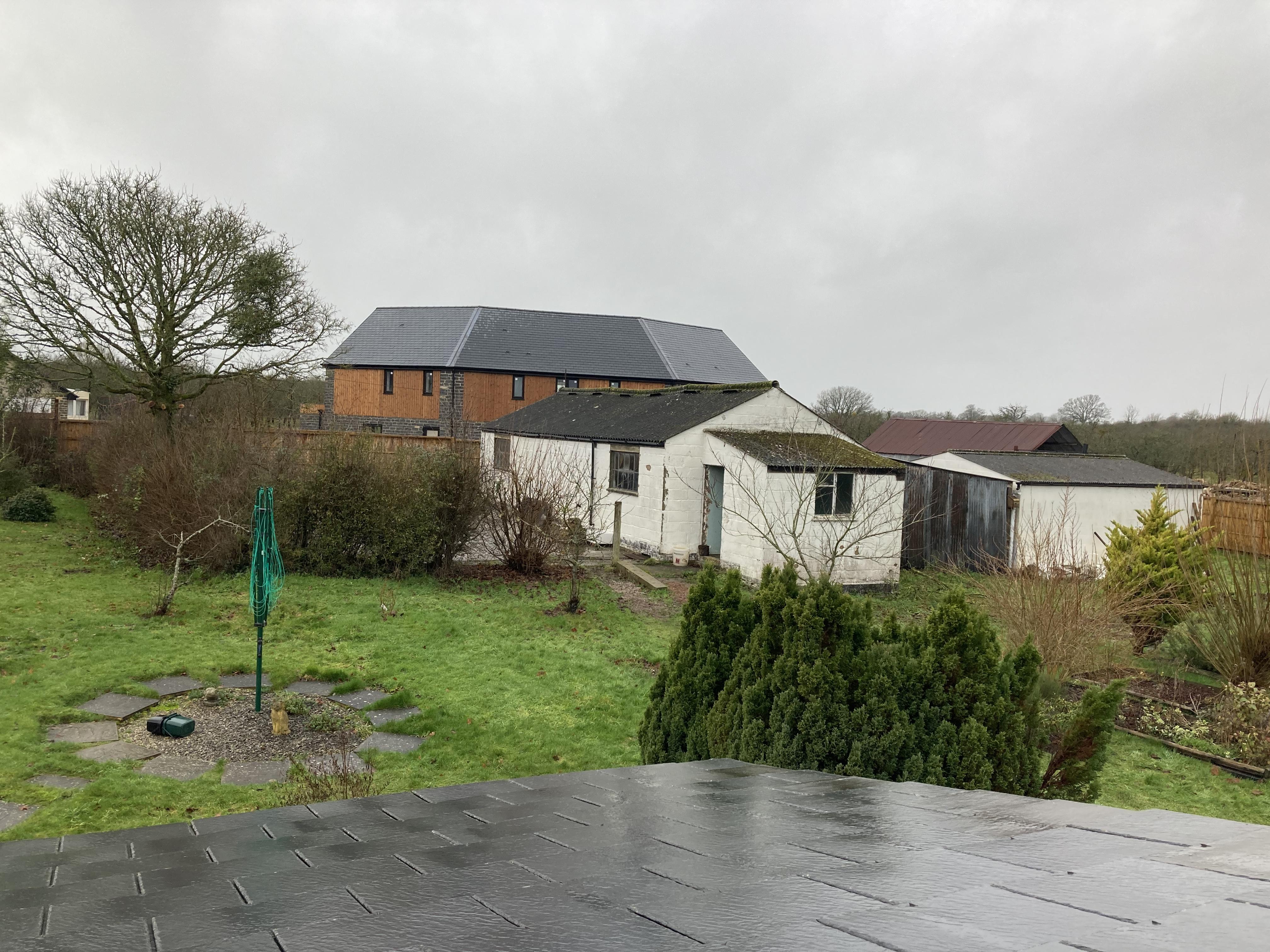

Somersetcider Posted January 14, 2023 Author Share Posted January 14, 2023 Thanks a lot for your reply. The original class q had the barn and workshop as a separate dwelling! Believe it or not the planners accepted a 1 bedroom conversion of the workshop! Within that it was agreed that the lean to element was to be demolished interesting about the driveway I can confirm it’s an unclassified road we had thought about doing it separately before but was told it’ll need full planning and so another ecology report etc. the big benefit of going class q route I can see is that we won’t be subject to the phosphate issues as from my understanding permitted development is excluded from this? the lpa seemed perfectly happy with the proposed works to the main barn falling inside the scope of a conversion so that could be a route to explore to give a legitimate fall back position and then we can develop further it seems to me that establishing the fall back position is the stumbling block in this case and once established as long as the design and scale is in keeping the lpa are perfectly accepting of a new build. Link to comment Share on other sites More sharing options...
Somersetcider Posted January 14, 2023 Author Share Posted January 14, 2023 To add as well I believe there still is scope for another large home as the other 2 my neighbours owns were smaller sized the cumulative floor space has been merged and this has been developed into a large new build. Much larger than the agreed planning so I think they are trying to get it through retrospectively! I’ve added a photo gives a bit of a better overview of the site some of the garden in the picture is parents and is yet to be separated properly. Link to comment Share on other sites More sharing options...
