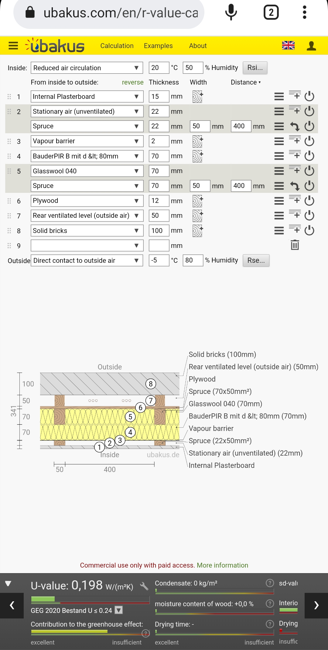

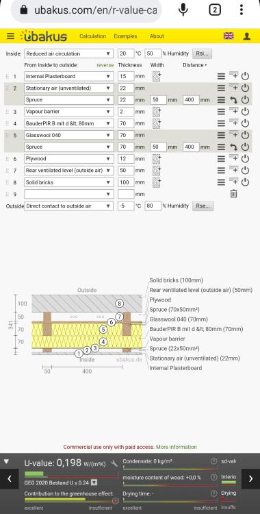

Steve450 Posted December 23, 2022 Share Posted December 23, 2022 Hi all, I have a single brick external leaf rendered with a 50mm cavity then a timber kit with paper, ply wood and 70mm studs. I have jumped the gun a bit and purchased 70mm PIR. My plan was to fit tightly inside the 70mm studs then fc foil vcl then battern 2x1 for a service void then plasterboard or soundbloc, I’m aware that would only give me roughly .28 U value going on the average figures I’ve got back from online calculators. my question is, if I was to add another sheet of PIR say 30mm would I install it directly over the stud face and 70mm PIR then install battens and plasterboard or am I better installing the battens over the 70mm PIR then installing a 30mm PIR or 40mm insulated plasterboard and if so on either option to gain a better U value of approx .22 where would the VCL go? thanks in advance Link to comment Share on other sites More sharing options...

Iceverge Posted December 23, 2022 Share Posted December 23, 2022 @Steve450 Welcome and seasons greetings. Do you have any photos to share please, they always help. Sounds like fiber glass batts in the wall as is. If they're ok I'd leave well enough alone. Put the 70mm PIR cross the studs then VCL and then service cavity and plasterboard. Link to comment Share on other sites More sharing options...
