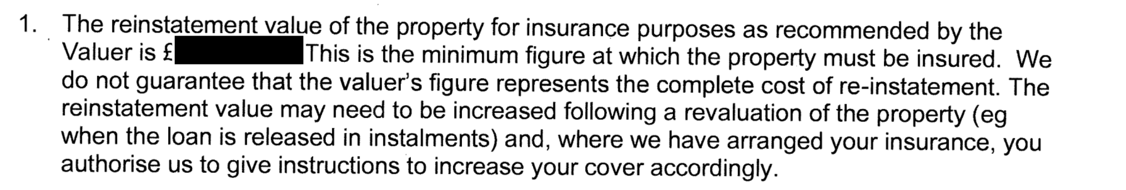

puntloos Posted December 23, 2022 Share Posted December 23, 2022 (edited) Ecology included a special condition in our builder mortgage offer that's giving me a lot of headaches (and I seem to be racking up huge sollicitor costs, since apparently our sollicitor has to determine if the insurance is sufficient). It says: This baffled a bunch of my team, incl the builder and the QS - effectively they _seem_ to want building insurance on a building that doesn't exist. I understand that ecology want to be able to reclaim their loan somehow if everything on my side fails, but they don't seem to be offering any useful advice on what suffices. Instead we're trying to get ecology to be on the noted parties list of the builder's all-risk but it's also somewhat unclear if that will suffice. What have others here done? Did your mortgage include this condition? Edited December 23, 2022 by puntloos Link to comment Share on other sites More sharing options...
PeterW Posted December 23, 2022 Share Posted December 23, 2022 No but a standard construction all risk policy would suffice. Will cost you about £300 I would expect for the build period Link to comment Share on other sites More sharing options...
puntloos Posted December 23, 2022 Author Share Posted December 23, 2022 15 minutes ago, PeterW said: No but a standard construction all risk policy would suffice. Will cost you about £300 I would expect for the build period That's what I thought, and the contractor has an all risk but my sollicitor has the impression that I need to have that insurance (or at least that the mortgage company is added to the all risk as a noted party of interest). A few of the first hits on google on "construction all risk policy" demand that I'm a company to take this policy out, and I can't apply as an individual. Am I missing something? Link to comment Share on other sites More sharing options...
PeterW Posted December 23, 2022 Share Posted December 23, 2022 Here you go https://www.selfbuild.uk.com/forms/products/SelfBuild/SB_1_QuickQuote.aspx Standard Zurich policy 1 Link to comment Share on other sites More sharing options...
puntloos Posted December 23, 2022 Author Share Posted December 23, 2022 1 hour ago, PeterW said: Here you go https://www.selfbuild.uk.com/forms/products/SelfBuild/SB_1_QuickQuote.aspx Standard Zurich policy Good lead, thanks. Sadly my contracted cost is slightly above that, so will need to call them but will give that a go! Happy for other insurers to chime in too Link to comment Share on other sites More sharing options...
Seren161 Posted December 26, 2022 Share Posted December 26, 2022 “It is a condition of this mortgage that buildings insurance cover is in place, that it is sufficient for your property and remains in place for the duration of this loan. We can provide you with a quotation on request.” Similar..we had the buildcare site insurance which included the required reinstatement value of the anticipated full build cost as opposed to mortgage borrowing . Rebadged and probably significantly overpriced .. I think it was underwritten by Catlin insurance Link to comment Share on other sites More sharing options...
