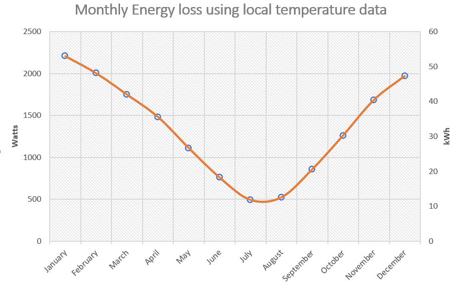

Furnace Posted December 22, 2022 Author Posted December 22, 2022 Having built my own spreadsheet I feel pretty comfortable with the heat loss numbers based on local temperature data, and they largely agree with the PHPP consultant. The area of most difference is the air heat loss from infiltration and MVHR. I've not spoken to him about it yet, but it may be that he's input a different flow rate for the MVHR and a different adjusting factor for the ACH50 losses. In the meantime, does this pass the general sanity test? Remember, it's just losses and no account is made for solar gain or internal equipment or human based gains Next I need to get comfortable with the solar gains. Anyone done any work on this outside of the PHPP bird's nest? Cheers Mark

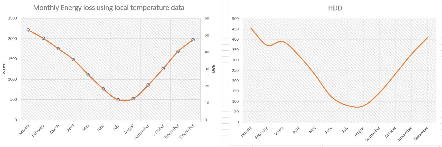

SteamyTea Posted December 22, 2022 Posted December 22, 2022 4 hours ago, Furnace said: I feel pretty comfortable with the heat loss numbers based on local temperature data, and they largely agree with the PHPP consultant. Check against the HDD databases, the charts should be similar shape. https://www.degreedays.net/ Solar gain is quite tricky. When I plot my house data against weather data, there is not a very strong correlation. I think there is a better correlation to windspeed, but when the wind is strongest, the temperatures are highest. Not as if I get many clear skies caused by NE winds, in the summer. Not as if I get many clear skies and warm SW winds in the summer either. It rains most days here, and when it is not, it is dark.
Furnace Posted December 22, 2022 Author Posted December 22, 2022 1 hour ago, SteamyTea said: It rains most days here, and when it is not, it is dark Do you moonlight for the tourist board? 1 hour ago, SteamyTea said: I think there is a better correlation to windspeed, Is your ACH50 high? Maybe strong winds are boosting infiltration losses? 1 hour ago, SteamyTea said: Check against the HDD databases I'll check the shape, although I suspect they'll be the same. I'm more interested if others have a sense if the real world experience supports these ballpark actual numbers. Cheers Mark

Furnace Posted December 28, 2022 Author Posted December 28, 2022 (edited) On 22/12/2022 at 22:15, SteamyTea said: Check against the HDD databases, the charts should be similar shape. Pretty similar as expected. What I'm more interested is the order of magnitude of the losses. Any thoughts from similar size gaffs. My design is currently 236m2 TFA with heat form factor of 3.06 Edited December 28, 2022 by Furnace
