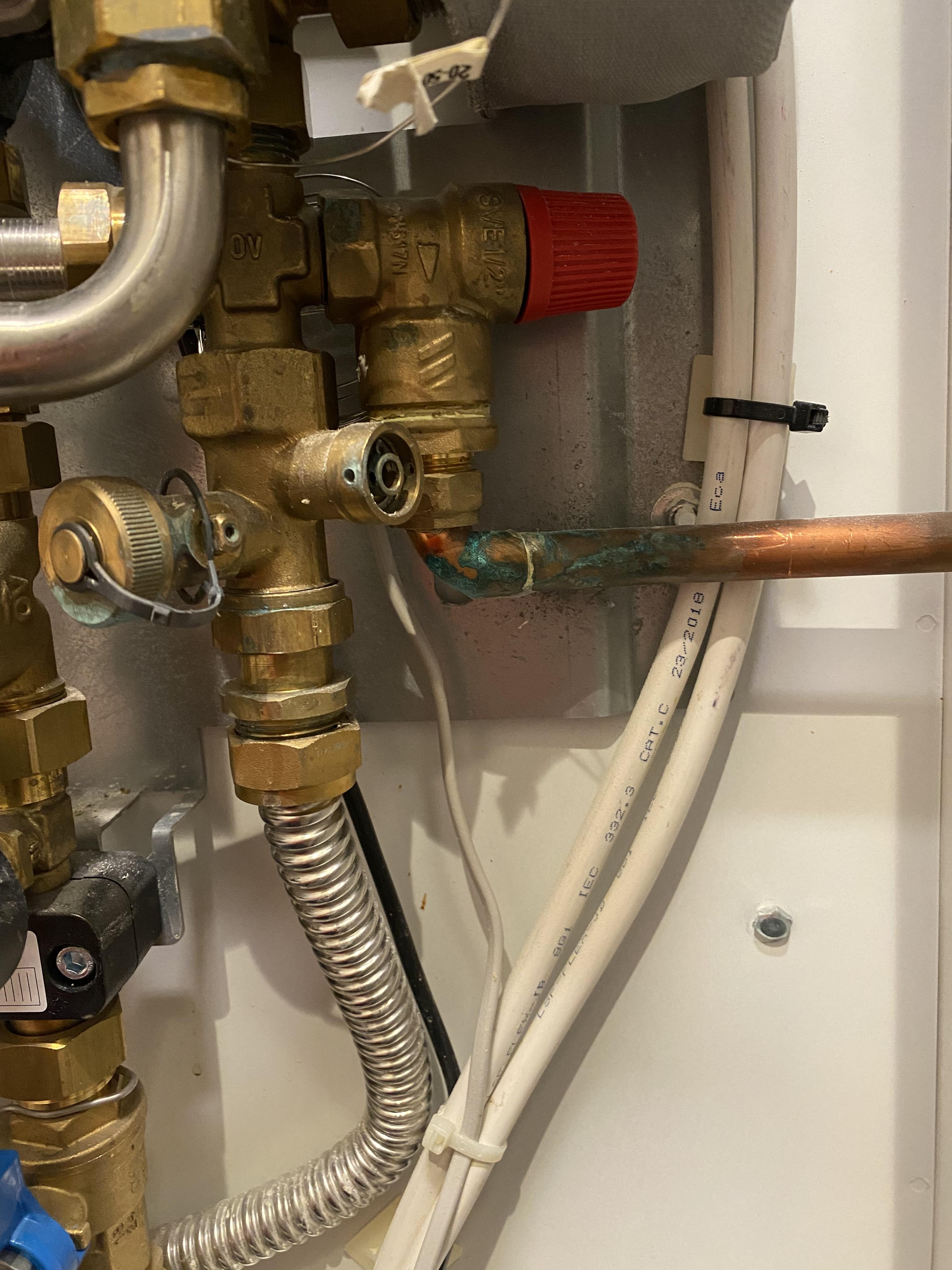

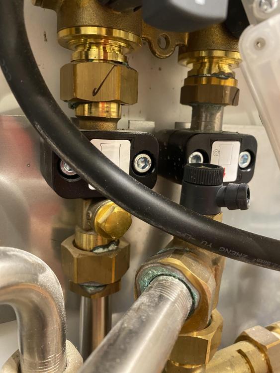

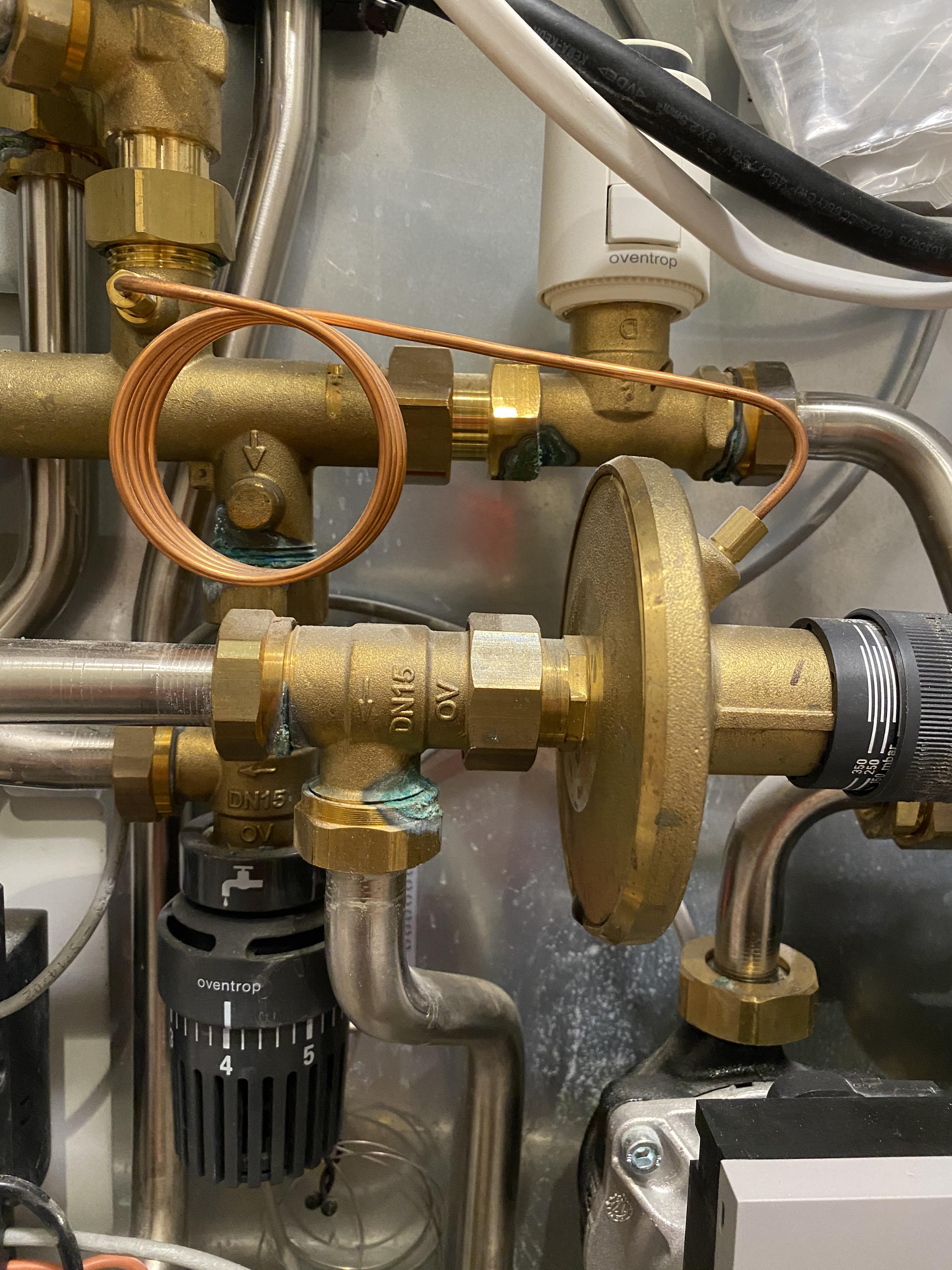

Opened the heat interface unit (I think that’s what it’s called) to read my heating meter, and noticed there’s mainly green (and some white) crusts on pipe joints. Some of it flakes off with just a light brush, but does not come off completely.
Is it something to worry about?

 Nothing to worry about. Sometimes you might get some water weep and this happens which can self seal, or the plumber left some flux on the pipe (picture two) When to be concerned is when you have a thicker line of it running down a pipe as that means there has been a leak.

Yup, flux residue ( likely they used PowerFlux or Laco ) from acidic "self-cleaning" fluxes. The others are leaks which look to have sealed themselves as @Kelvin said.
Clean all these joints up so you can be sure they've cured, but this is typically what you see under a combi boiler where it's leaked a little but then sealed itself up, eg very minor weeping joints.
