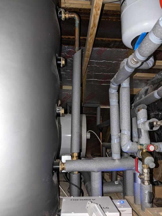

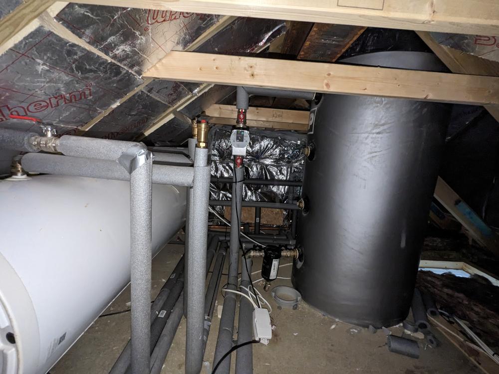

1 hour ago, Rupe30 said:
I'll measure up tomorrow I think we do have that height. Is it worth having a smaller buffer than losing it all together?
Let's answer that after you've decided whether or not you can do without all those valves that can randomly turn off so may zones that the heat pump has nowhere to put it's heat.
They've put that in there so that the heat pump has something to do if all the zones shut down. The lady of the house wanting to run one towel rail and one bathroom floor even when it's 25C outside may dictate that you keep it.
There's room for two vertical tanks up there though if you don't vomit equipment in like your average plumber.

Sorry to go radio silent, ASHP problems melt away in summer!
After the last post I set all thermostats to 30 degrees to stop them clicking on and off and adjusted the flow rates to all the zones on both manifolds till the rooms held temperature. It was challenging to balance the system, downstairs all zones are on minimum flow and manifold pump is on minimum setting and the lounge still got too hot so I had to use the thermostat for that, but I used it as a timer rather than temp target to avoid it clicking on and off repeatedly. Upstairs 2 rooms require  max flow with the manifold pump on max setting to keep temperature which is what is restricting the whole system as the rest of the house is pretty much on minimum flow rate.
Th So In summary yes I can run the whole house on, but I need to turn two small bedrooms off and the lounge sometimes . Running the AI mode at -2 so I think all in all it's working well considering house is a comfortable 21 degrees which much warmer than we had it previously.
One issue of running The system in this way is that I can only adjust the temperature of the house using the LG controller using the + or - on the AI mode and it takes a long time to take effect. Which means I can't have the house cooler at night.
I'd like to track my COP to as i figure that's a good way to track the efficiency. I can't see any heat output data on the LG controller so am I going to have to fit my own heat meter and electric meter to determine COP or is there an easier way?
Figured out the issue with the hot water, cylinder was installed back to front, so the hot feed was attached to the cold (which has a dip pipe to the bottom of the tank) and the cold feed was entering into the top of the tank. Much better since we've re-plumbed.
