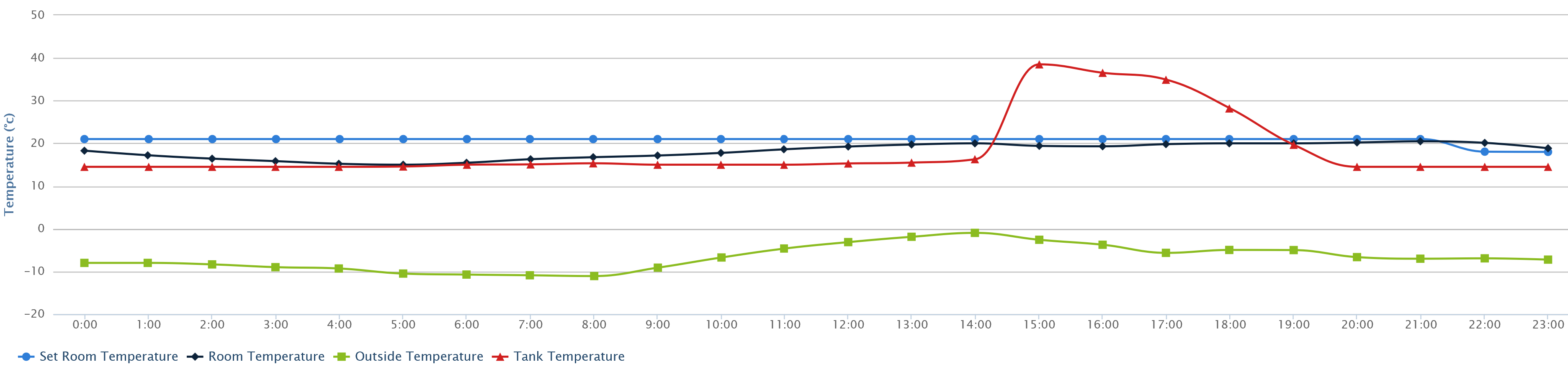

Just to follow that up with a bit of hard data, here's my MCS heat loss design calc:-
Indoor average design temp. 19°C
House area 137 sq metres
Peak power/heat loss 8.26kW
At design temperature -2.4°C
And here is how my 11kW HP has been coping on the 15th Dec, operating in WC mode with a degree of manual intervention
Edited by PhilT
