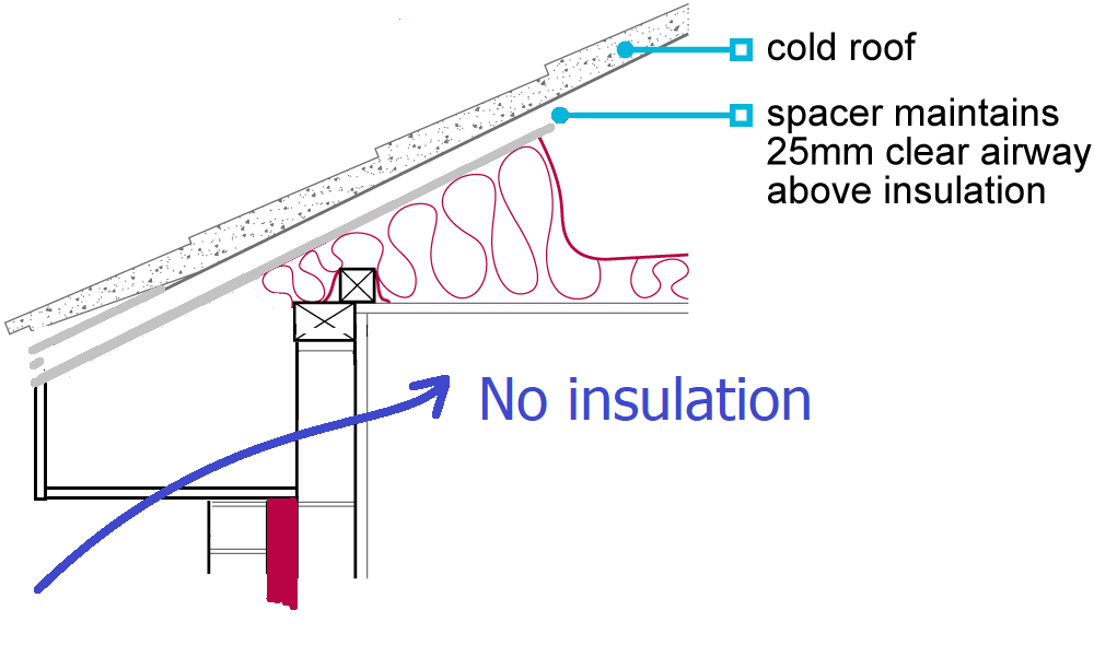

Radian Posted December 13, 2022 Share Posted December 13, 2022 13 minutes ago, Jason213 said: I have asked around, and quite a few people I know (not on our estate) have wet lofts due to the very cold, and non-windy conditions. I'm really just after your opinion if this is a problem? You've hit the nail on the head. It's unusually cold and calm. Normally the through draught would be carrying away the vapour but not lately. And the exceptionally cold roof is just the perfect thing to condense the vapour back into water. I think it's OK for this to happen occasionally (it's inevitable) and is inconsequential in the long run. It will cycle a few times (condensing, evaporating, condensing... ) but the weather will change and the next windy day will restore the former equilibrium. But be very careful when you're thinking about using rigid insulation. Unlike glass wool insulation, it isn't vapour permeable so it has to be guaranteed that moisture laden air from the house below can't accumulate anywhere that's not fully thermally insulated. Whatever you do here will lock-in the consequences and then, in the long run, may cause permanent damage. I recently realised that the eaves in my loft are poorly detailed for insulation. The inner leaf that carries the wall plate and trusses is around 300mm higher than the outer leaf (which supports the soffit board) and the loft roll stops at the wall plate. Here it meets the plastic eaves protector sheets that also form the eaves ventilation. Everything looks good from in the loft until you pull back the roll and realise there's a void forming the soffit: Link to comment Share on other sites More sharing options...

Radian Posted December 14, 2022 Share Posted December 14, 2022 6 minutes ago, Jason213 said: If I did use rigid insulation, should there be a plastic membrane underneath against the plasterboard? My thinking was it would give better insulation at the edges to stop cold bridging to the rooms below. It sounds reasonable enough in theory, but in practice you're interrupting the natural ventilation that cold lofts rely on. Wrapping things that are open to vapour on one side can end up making big problems with condensation. You're only thinking of using rigid insulation to improve the insulation levels at the outer horizontal edges but is this really where the problem lies? I put up the diagram showing the issue I have at the eaves. How does your insulation regime ensure a continuous envelope that wraps the inner leaf? I.e. how does your vertical cavity wall insulation (you do have that right?) transfer to your horizontal loft roll? Mine has a 300mm break! Link to comment Share on other sites More sharing options...

Jason213 Posted December 14, 2022 Author Share Posted December 14, 2022 Hi, yes they were left dangling and there were unused roof vents so connected to those. Our en-suite isn't being used at the moment, due to it being re-tiled, so we're only using the main bathroom. In terms of the diagram above, the outer wall is the same height as the inner. I think I'll not put rigid board insulation in due to your advice. Link to comment Share on other sites More sharing options...
