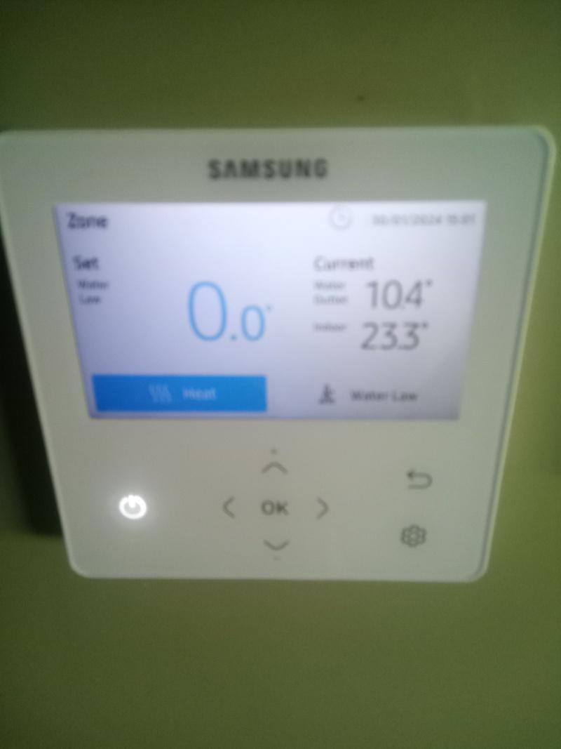

Squiggle Posted January 30, 2024 Posted January 30, 2024 Thanks for the replies. So my living room thermostat is currently showing 23 degrees (also solar gain) and my bedroom is 19 degrees, the Samsung controller is always 20.0. I've gone through all the settings and nothing is set to 20.0. Does this number affect how the heat pump operates? I'm using water law with the thermostats switching on/off at their set temps.
Jenki Posted January 30, 2024 Posted January 30, 2024 55 minutes ago, Squiggle said: Thanks for the replies. So my living room thermostat is currently showing 23 degrees (also solar gain) and my bedroom is 19 degrees, the Samsung controller is always 20.0. I've gone through all the settings and nothing is set to 20.0. Does this number affect how the heat pump operates? I'm using water law with the thermostats switching on/off at their set temps. You are correct there are a lot of settings, but I use water law and an external thermostat, and this temp has no bearing on the operation of my HP. initially my control was next to the cylinder, and always read 1.5-2 deg more than the thermostat that controls the house temp, and the HP worked as required. i.e. the system controller could say 20 deg, if my room stat was at 18 and my set point 19 the HP would be on. switching off at 19. 1

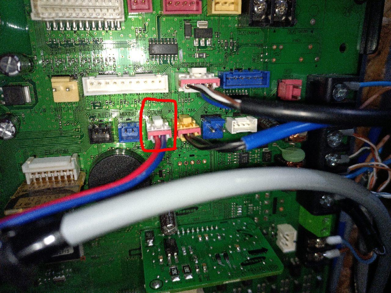

Tony t Posted February 25, 2024 Posted February 25, 2024 Hi jenki, I'm new, joined to ask you a question. I have a similar set up but only radiators. The installer put the controller and wired remote inside the cupboard where the circulating pump and loads of pipes are, I'm assuming the indoor temperature is taken from that - so it is obviously high. I've studied the books but can't see how to change it to add a remote thermister ( two came with the kit). That's my first question, I expect more will follow.

billt Posted February 26, 2024 Posted February 26, 2024 The room remote isn't supplied with the heat pump, but it's not that expensive. https://midsummerwholesale.co.uk/buy/samsung-heat-pumps/Remote-Temperature-Sensor-MRW-TA I suspect that the spares you have are intended to control a mixing valve, if they have the right characteristics they'll work but they aren't pretty and I doubt that they are the same as the remote temperature sensor. The remote room temp sensor plugs into a connector marked 'ROOM' on the MIM controller board. You also need to enable it from the remote controller. I think its FSV 2093, but I'm not sure.
Tony t Posted February 26, 2024 Posted February 26, 2024 Brilliant. The ones I have are just a thermistor on the end of a long lead, the proper ones will look rather better unless I can hide it somewhere. I would have thought the room temp wherever it is taken should effect water law, but who knows what's hidden in those chips.
ReedRichards Posted March 3, 2024 Posted March 3, 2024 "Water Law" seems to be what is generally called "Weather Compensation" in the UK. Weather Compensation is unaffected by room temperature. But there is also "Load Compensation" where the heat source will work harder the further away the actual room temperature is from the desired room temperature set on the room thermostat. Load Compensation works very well maintaining a constant room temperature but it could reduce your heat pump efficiency by making it work harder when the room temperature needs to be increased rapidly. On the other hand, getting a room up to temperature quickly will boost your comfort so its swings and roundabouts.
