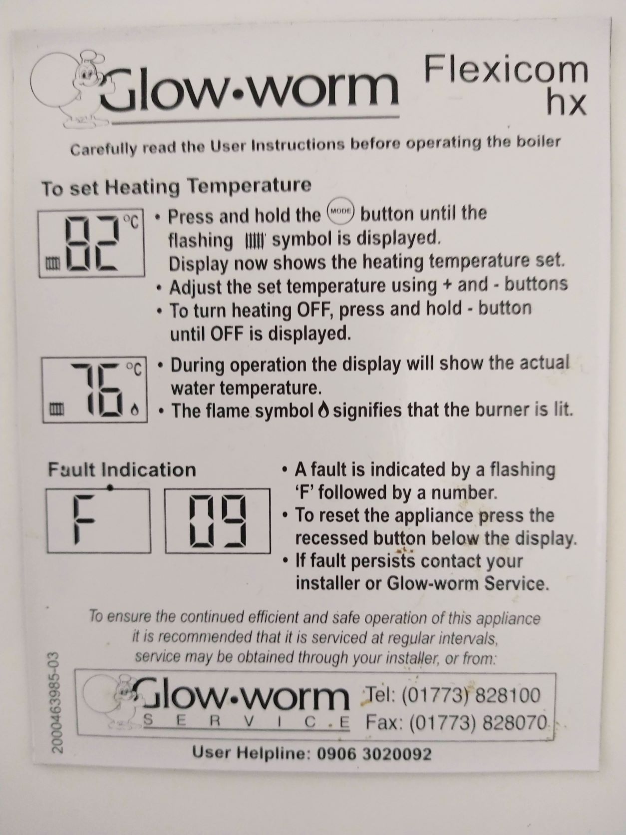

Shame to put people off unnecessarily, many condensing heat-only boilers (if not most judging from my experience with a few different ones I've checked recently) are set to around 80oC  The label on my own glow worm installed in 2008 perpetuates the old pre-condensing regime...
...by showing an example flow setting of 82oC. I'm pretty sure plenty of people would take this as advice when contemplating what the setting should be.
Yet without any additional instruction, people with HW cylinders could be told to set the cylinder stat to 60oC and the boiler to 70oC and gain a bit of extra efficiency. The additional instruction would be that if they have a control system that provides independent HW and CH flow temperatures then take the extra step of reducing the CH in steps of 5oC until the system seems to take too long to heat the house. It does seem that they're trying to keep it dumbed down a bit too much to me. I mean, things are pretty serious at the moment. People need to apply themselves.
