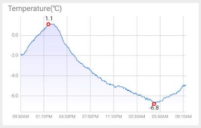

How are others coping on site with the cold temperatures? I thought I would share what I'm doing, which could probably be a fair bit better.
We don't yet have central heating in the build. I've set up a cheap "Diesel Heater" from  eBay that I'm using Kerosene in. There aren't many of the "All In One 5kW" type left on eBay like the one we have:

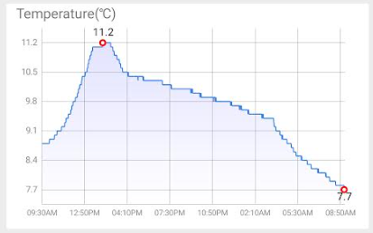

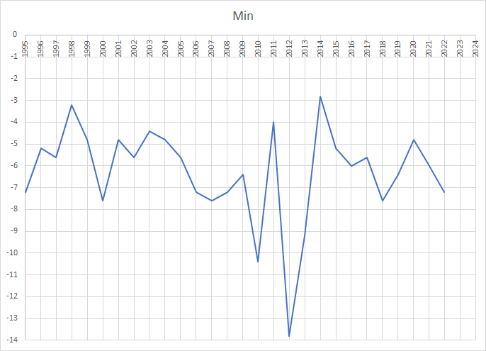

Last night was properly cold, below -7C in Cambridge which is below most year's minimum (bottom third 1995-2021). We recorded -6.8C in the garage (no doors) and the kerosene heater upstairs in the house stopped at around 3am unfortunately (-6C in garage), so the temperature dropped there more quickly. We're putting about 2.3kW of heat in (heater set to 3Hz to make 5L last ~24 hours) from the Kerosene heater plus the log burner downstairs, but that stopped at around 10:30pm.

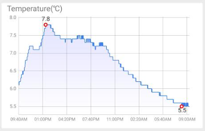

I'm surprised the log burner can't raise the temperature downstairs more than ~7.5C but there are quite a number of drafts / weak points downstairs (e.g. Polythene over a 2.2m x 2.1m door opening which has some gaps).
I'm quite pleased that we can keep the temperature in the house above 8C upstairs (bar it stopping) and above 5C downstairs in such an extreme outside temperature. I was hoping for 10C or above, but these are extreme temperatures (for here). Only upstairs is MF framed and plasterboarded so far. So far the loft only has 1 layer of 100mm / 150mm Loft Roll (44) with some areas not yet done. The walls have been blown with their cavity insulation (beads). All windows are in but not all doors.

Garage:
Upstairs:
Downstairs:
Cambridge Weather Station minimum temperatures calculated in Excel:
