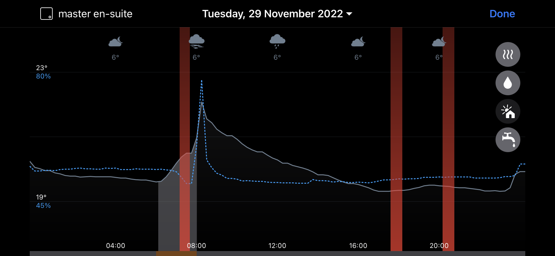

It’s all to do with the level of ventilation vs the level of human occupation. If humans (and animals) live in a property they produce humidity. If the property is very well ventilated, the ventilation will help counter act the humidity. If the property is not well ventilated, then the humidity caused by the occupants will create damp. It is more complicated than this, but that’sa quick summary.
 Old properties are usually pooorly insulated and ventilation is mixed (some have better ventilation than others). New builds have very good insulation and very good ventilation.
You want to aim for about 35% to 55% relative humidity. Within that range it shouldn’t be too dry (which is what causes a dry throat) or too moist. It will naturally fluctuate, but within that range you will be fine. If you have something like MVHR it will be more stable. Here is a graph of my bathroom’s ambient conditions.
You will see it is pretty stable between 45% and 55% except for a peak where it almost reached 80%. That was when I was showering and so it peaked very quickly, but because we have MVHR it cleared the humidity very quickly.

To add to the above, if you have a prolonged cold period outside, such as central Europe experiences, and MVHR, then as you heat the incoming air with out going air, you can do reduce the relative humidity.
A big house with only one person in it with sub zero temps for quite a few days could experience well below normal humidity levels.  But not sure it's that likely in the UK.
Our house today is sitting at 42% RH and 20 degrees inside, 6 degs outside and 77% RH outside.
