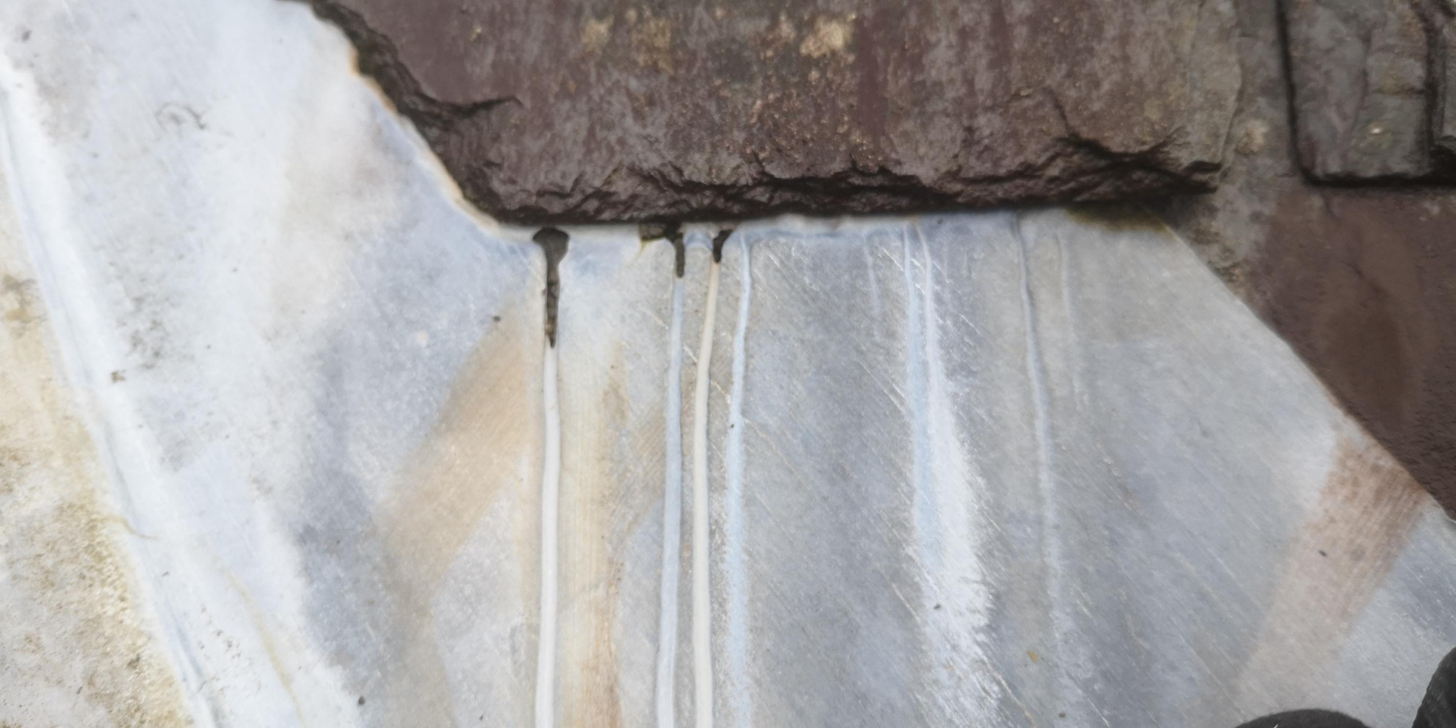

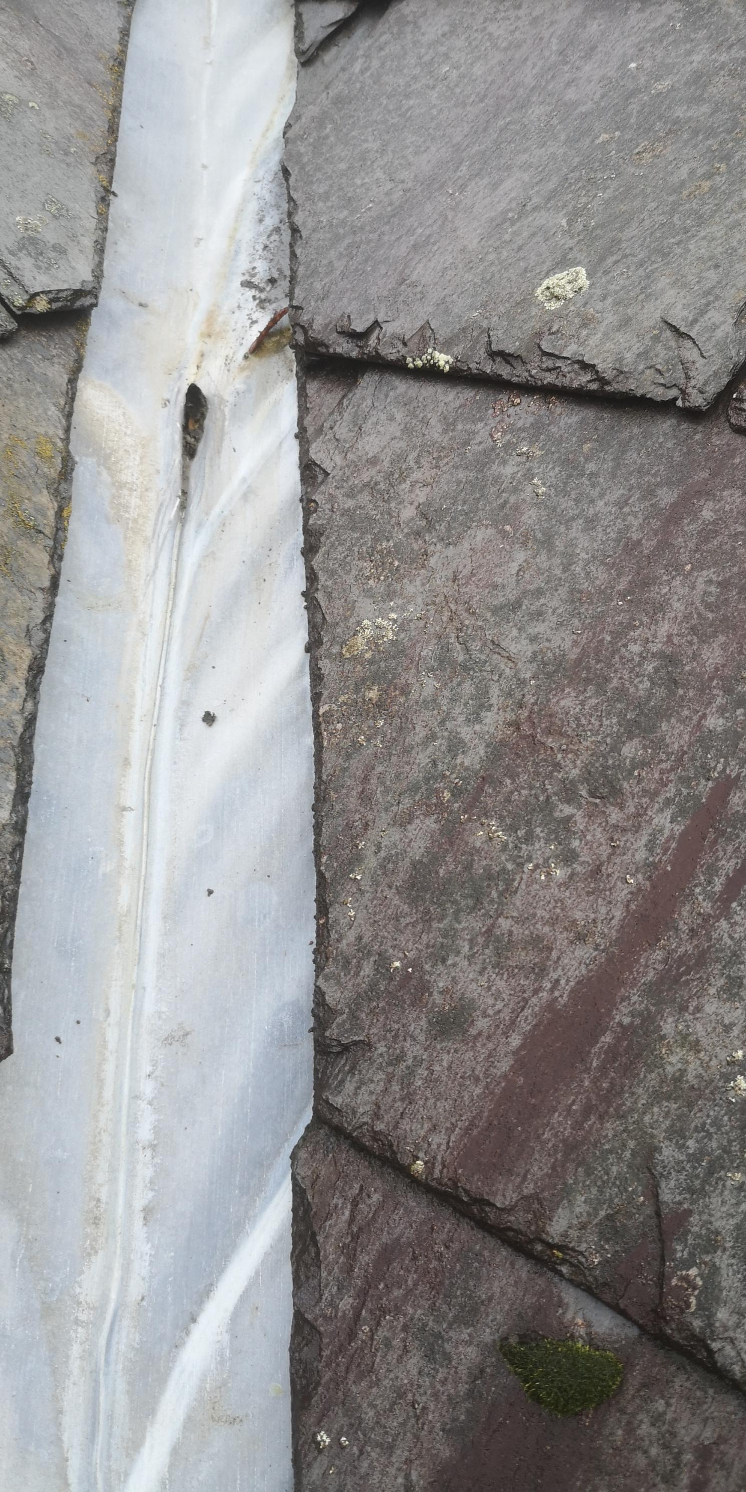

Roger440 Posted November 6, 2022 Posted November 6, 2022 On the new (quite old) house, there was a leak in the dormer window area. We knew this as its obviously been like it some time. Getting up to look what the issue is, ive found that the lead has eroded away. To the point of a split. Would i be correct in presuming that this is not actually lead?

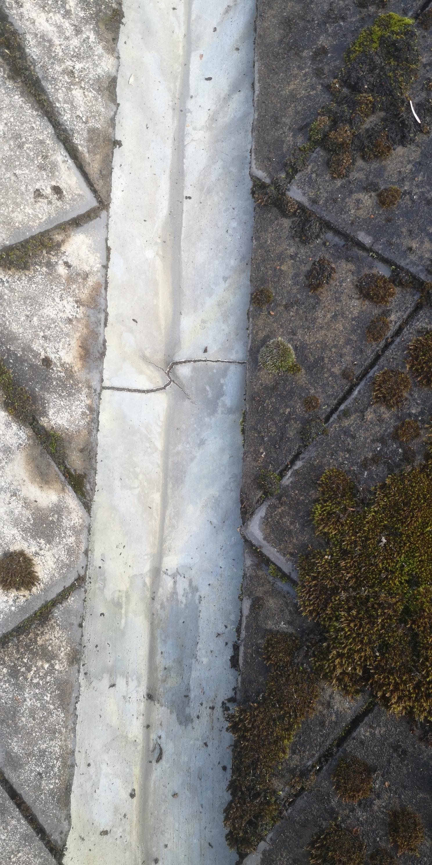

makie Posted November 6, 2022 Posted November 6, 2022 (edited) It is lead, the split in picture 3 is because it is longer than 1.5 (probably not even code 4 based on the holes from run off water) Edited November 6, 2022 by makie
Roger440 Posted November 6, 2022 Author Posted November 6, 2022 2 minutes ago, makie said: It is lead, the split in picture 3 is because it is longer than 1.5 (probably not even code 4 based on the holes from run off water) Thanks What should it be? Code 5? Yes, you are right, that run is probably 3-3.5 meters. Cant say im surprised. Main issue is finding someone to fix it properly. Ive properly bodged it for now. There are other issues, like the eaves being completely boxed in and minimal airflow. But i understand and can fix those.
makie Posted November 6, 2022 Posted November 6, 2022 Code 5 is the best for valleys but you can use code 4, just don't expect it to last as long. For the affected areas if you really can't find anyone to repair or redo you could cut a line and slip a new bit of lead in. If you do I recommend 8 inches lap on the slit upwards and 8 inches past the last hole etc.
Roger440 Posted November 6, 2022 Author Posted November 6, 2022 1 minute ago, makie said: Code 5 is the best for valleys but you can use code 4, just don't expect it to last as long. For the affected areas if you really can't find anyone to repair or redo you could cut a line and slip a new bit of lead in. If you do I recommend 8 inches lap on the slit upwards and 8 inches past the last hole etc. Sorry, but im not sure what you mean? Cut a line where? Surely i need to be removing all the tiles?
makie Posted November 6, 2022 Posted November 6, 2022 5 minutes ago, Roger440 said: Sorry, but im not sure what you mean? Cut a line where? Surely i need to be removing all the tiles? You may be able to swing the slates, depending on if they are double nailed etc. Would remove the need to strip big sections. https://www.youtube.com/watch?v=or37dqQ1owM This video will show you what I mean. To ensure all slates are nailed yes. Depending on the area or need for a quick repair you could use a lead tingle and some glue to hold it down.
Roger440 Posted November 6, 2022 Author Posted November 6, 2022 46 minutes ago, makie said: You may be able to swing the slates, depending on if they are double nailed etc. Would remove the need to strip big sections. https://www.youtube.com/watch?v=or37dqQ1owM This video will show you what I mean. To ensure all slates are nailed yes. Depending on the area or need for a quick repair you could use a lead tingle and some glue to hold it down. That was very useful. Thanks . Ive seen some of vids, but not that one. I dont follow what you mean on the tingle repair. I understand it for holding tiles, but for a valley repair?
makie Posted November 6, 2022 Posted November 6, 2022 34 minutes ago, Roger440 said: That was very useful. Thanks . Ive seen some of vids, but not that one. I dont follow what you mean on the tingle repair. I understand it for holding tiles, but for a valley repair? You would use them to repair any slates removed to fix the valley, if you didn't fully strip the area
