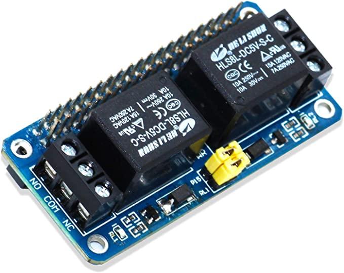

Radian Posted November 6, 2022 Share Posted November 6, 2022 58 minutes ago, Xerxes991 said: Not bad (for a mechanical engineer). Have you got a home brew suggestion? Sounds interesting. Well yes, there's a thousand ways to implement such a thing - it all depends how much from first-principles you are happy to start with. Assuming you'd rather not create your own temperature sensor from a forward biased diode I'd suggest using a ready made temperature sensor like a DS18B20. Then you grab a raspberry pi and follow steps from any online tutorial like this one to hook it all up. That link has a video tutorial as well. If you were to follow it you'd end up with the temperature on a display. The Python code example could then be tweaked to operate a 240V relay board to produce a boiler demand contact closure at your chosen set-point. A relay board like this for example... ...Can plug straight on to the Raspberry Pi pins. You could put probably it all together for under £50. Once you have the basics working there are numerous ways to go about making it smarter should you wish to. Link to comment Share on other sites More sharing options...
