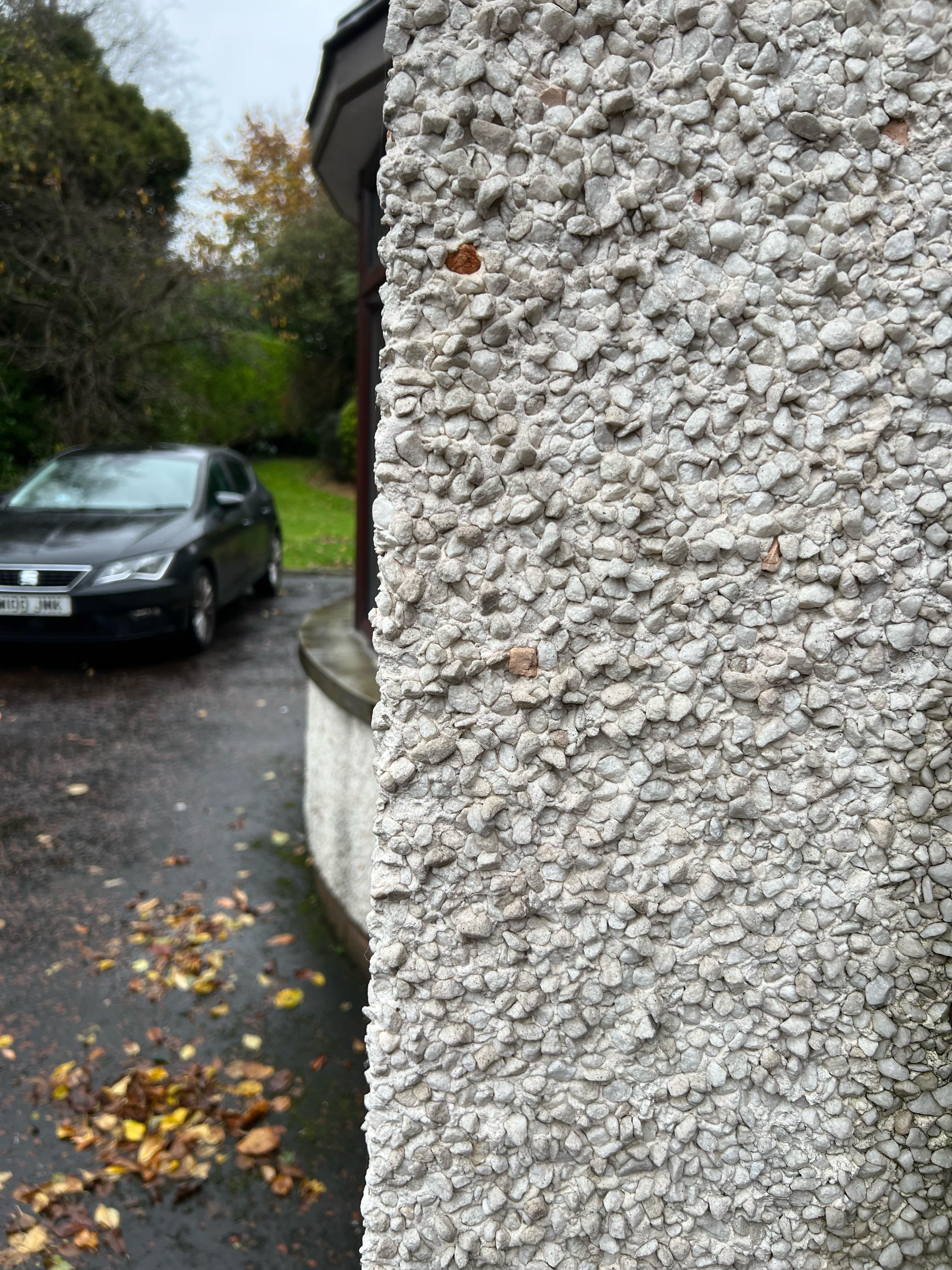

JCGD Posted October 27, 2022 Share Posted October 27, 2022 As much as we love the new house, neither of us are a fan of pebbledash, and would like to get a rendered finish. Is this possible to do without removing the pebbledash? Link to comment Share on other sites More sharing options...
themucky1 Posted October 28, 2022 Share Posted October 28, 2022 19 hours ago, JCGD said: As much as we love the new house, neither of us are a fan of pebbledash, and would like to get a rendered finish. Is this possible to do without removing the pebbledash? If you post a pic up I can give you some advice, but if it’s a new house I would say it’s monocouche roughcast not pebble dash. Plus if it’s fairly new will probably cause more damage removing as it will still have a strong bond to the substrate Link to comment Share on other sites More sharing options...
JCGD Posted October 29, 2022 Author Share Posted October 29, 2022 (edited) 23 hours ago, themucky1 said: If you post a pic up I can give you some advice, but if it’s a new house I would say it’s monocouche roughcast not pebble dash. Plus if it’s fairly new will probably cause more damage removing as it will still have a strong bond to the substrate This is what we are dealing with. House was built in 1982. Edited October 29, 2022 by JCGD Link to comment Share on other sites More sharing options...
Iceverge Posted October 29, 2022 Share Posted October 29, 2022 You could of paint it? Link to comment Share on other sites More sharing options...
Adsibob Posted October 29, 2022 Share Posted October 29, 2022 As long as it is not damp, you can add EWI and then render with a more contemporary finish. I recommend Ceresit. Link to comment Share on other sites More sharing options...
