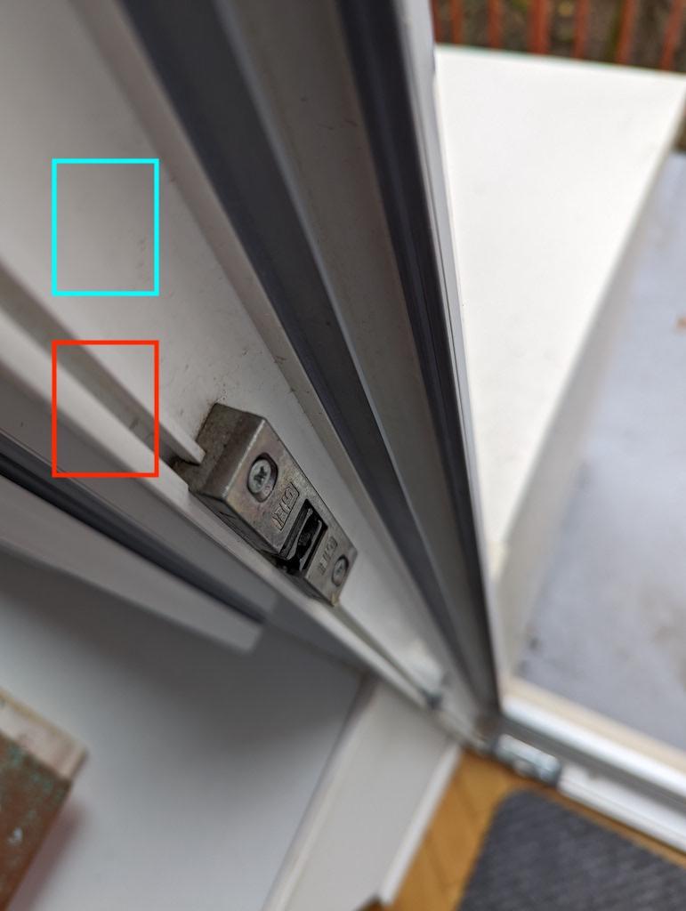

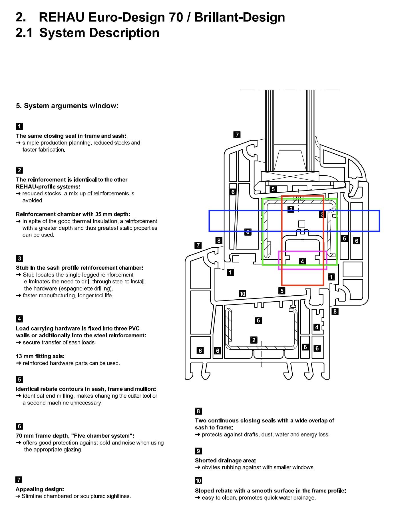

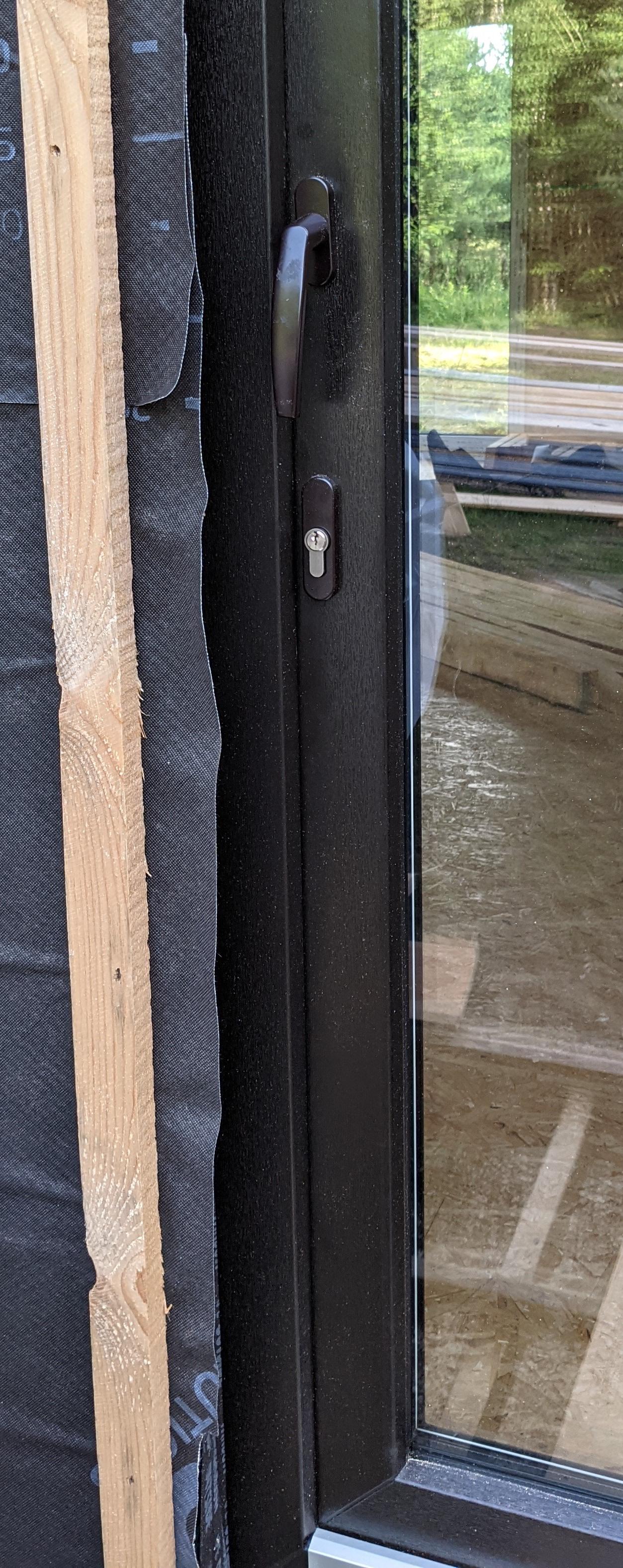

This is the profile and the current outside handle / lock arrangement. Highlighted in green is where a mechanism can fit. Highlighted in blue is where the current handle bar / euro cylinder are fitted. These offer fairly token security. (they half heartedly stop the slide bar moving up and down) Highlighted in pink is what I think is called a "eurogroove" for all the mechanism gubbins:

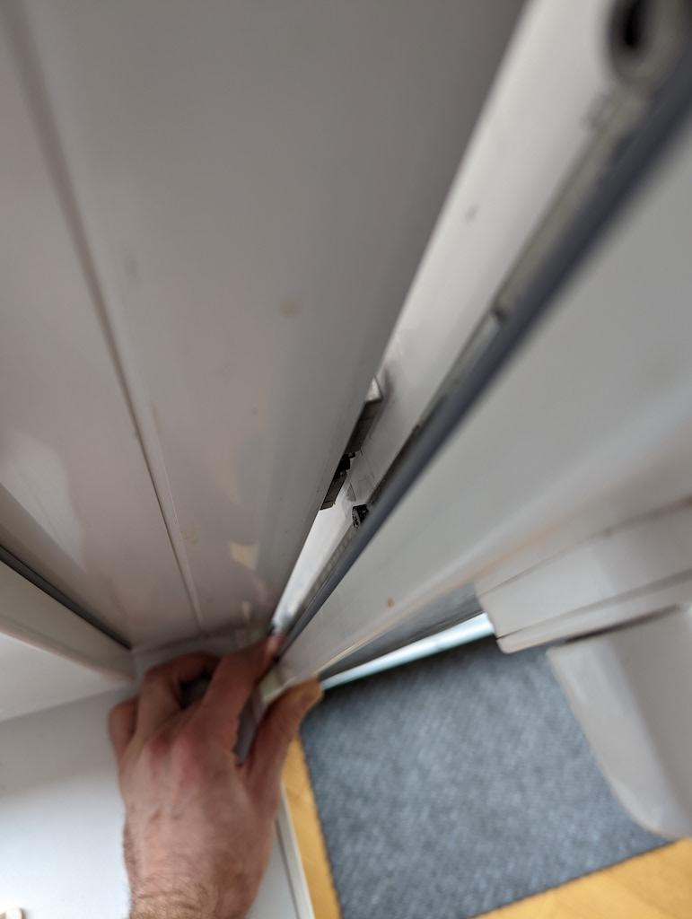

There's a bit more space between the sash and the frame that could be used (i.e. lock could stick out a bit / not be flush with the frame) I've highlighted that in red in the section view above.
You could even nibble a bit out of the outside frame if you had to (highlighted in red below) and rebate the keep elements in the blue bit; though that feels like a lot of bodging at this point. Frame below isn't quite the same profile but the edge / lock detail is the same)

Apologies but you're overcomplicating this, order a new door.
The work involved in converting this will cost you probably the same to reorder, deliver and install the door. Secondly, it's unlikely the cylinder will fit properly in the door and it's a lot of hassle to solve a problem, which is easier to do by ordering a new door. Trust me, talking from experience.
Bite the bullet and order new.
