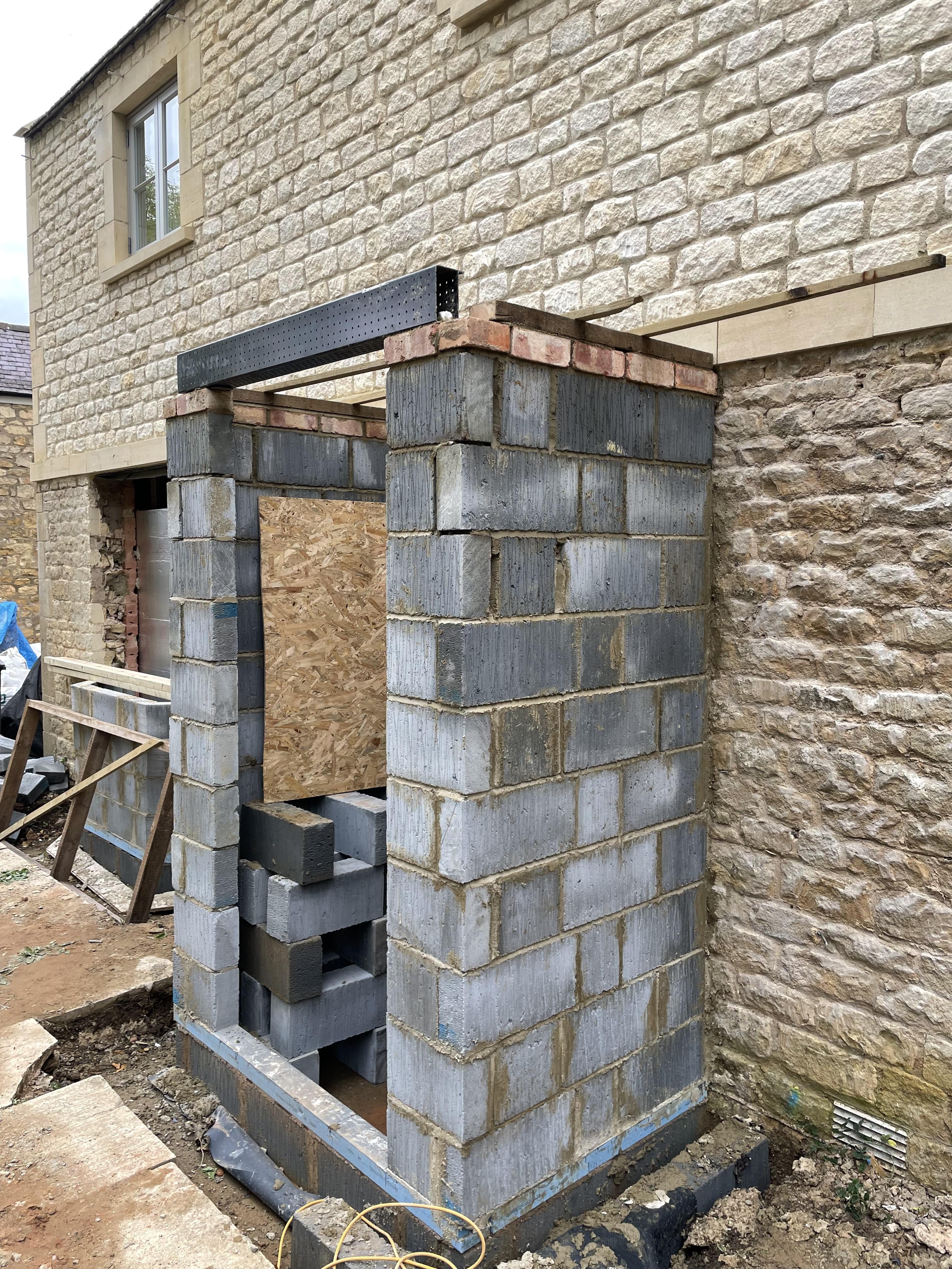

SuperPav Posted October 17, 2022 Posted October 17, 2022 Just got to wall plate level on the new porch to the existing house. I want to get the rafters up, but wanted to check if for a porch this size (tied into the existing walls), any rafter ties are required, or if I can get away without them. The porch is only 1.2m deep, 1.5m between wall plates. so 3 pairs of 6x2 rafters. I'd prefer to have a pitched ceiling in the porch, so would omit the ties, but if required, I'll put some raised ties at 1/3 up the rafter.
Dave Jones Posted October 17, 2022 Posted October 17, 2022 will be fine on something that small, truss clip the trusses to the wall plate to belt and braces it. 1
