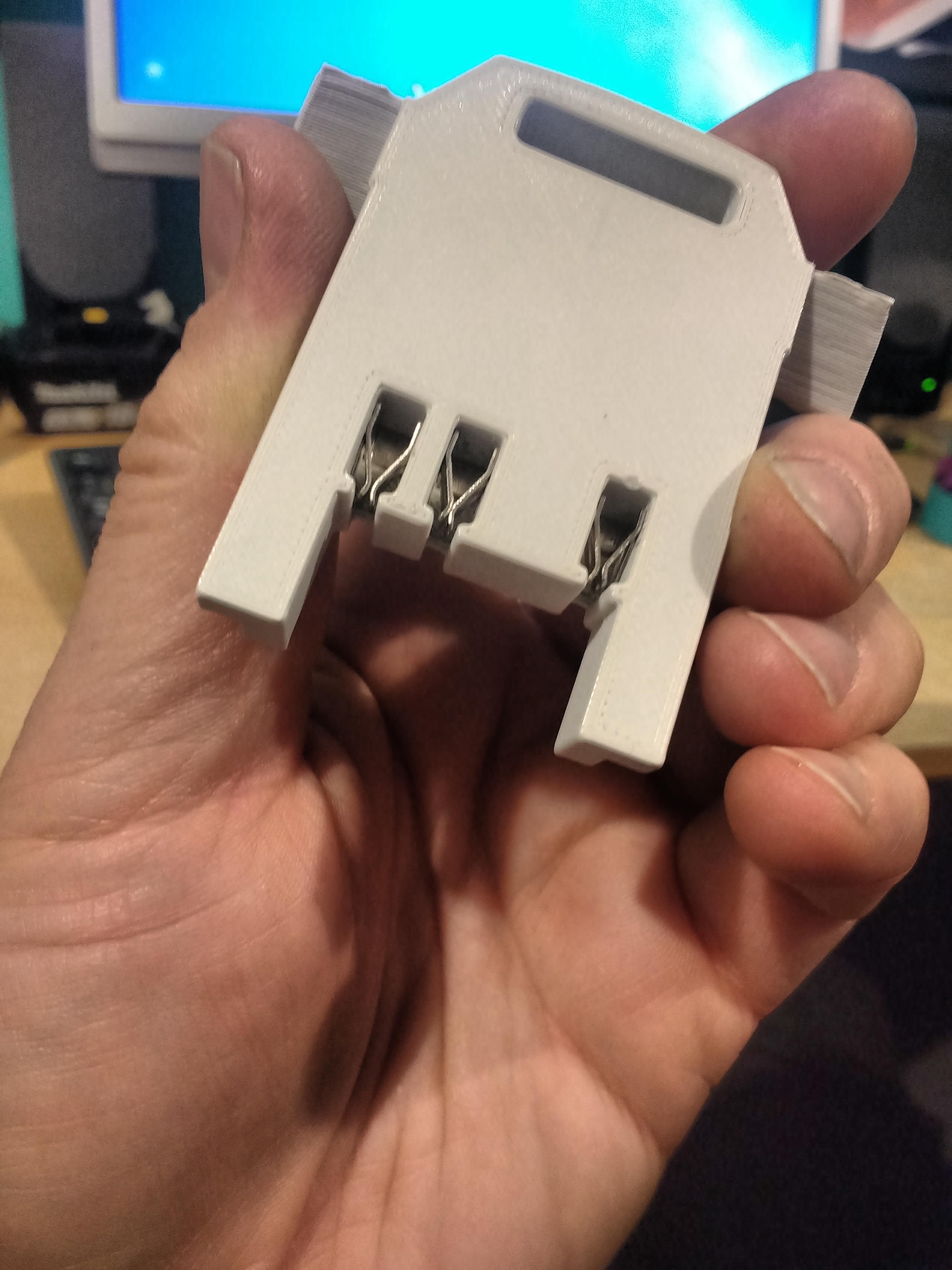

It prompted me to ressurect the adapter design. This is where I am as of yesterday. Test piece done, the part that fits into the Parkside tool. I've used spring finger battery terminals recovered from duff Makita batteries. Fits like a glove.

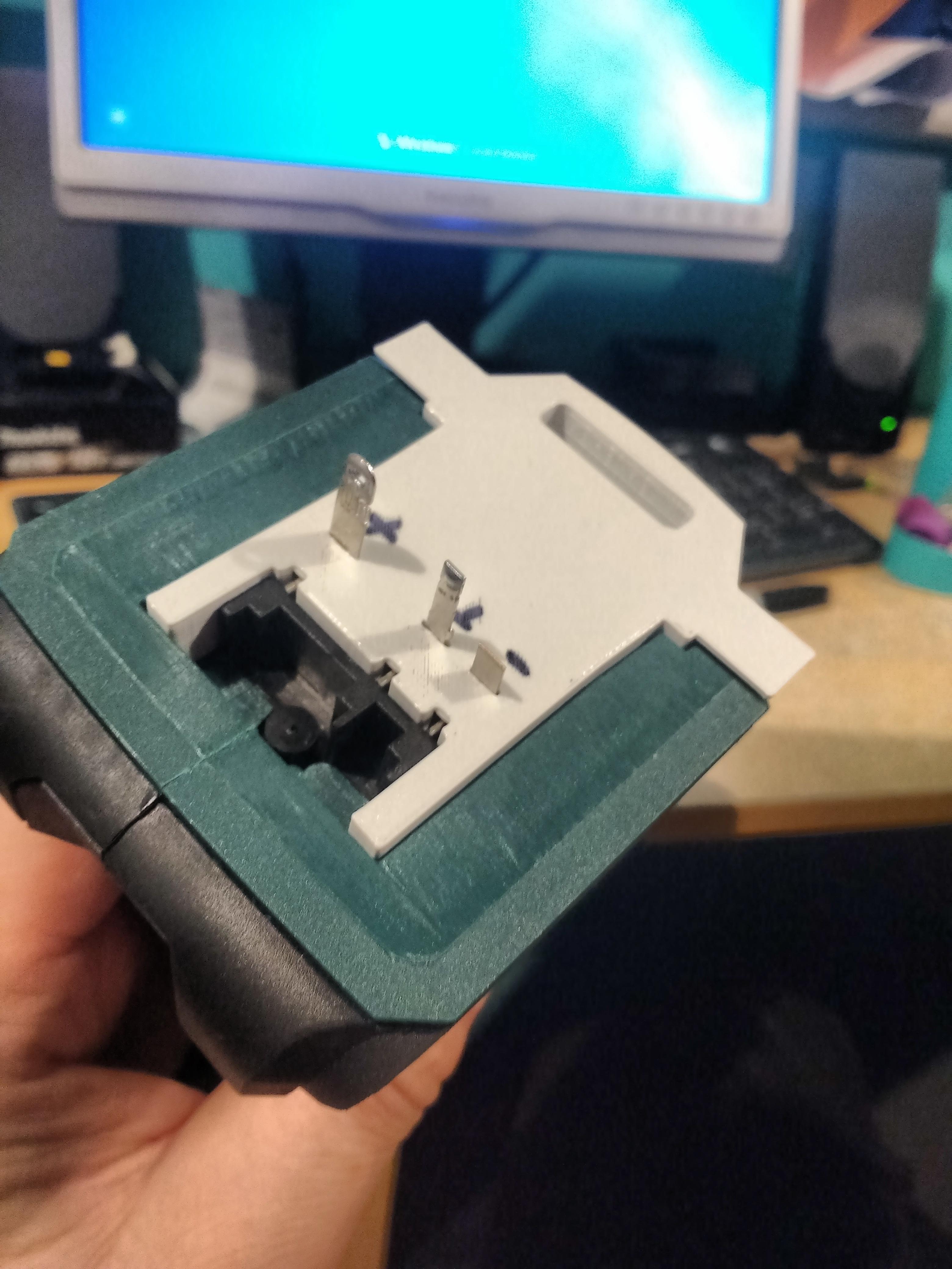

The "Mak2Par" Makita battery to Parkside tool adapter is done and works. We'll call it the prototype as I'm not 100% happy and will thus make some tweaks for the next one.
So a PETG adapter to my own design. The supported side is a bit rough but that isn't seen as it's against the Parkside tool. Changed from the original PLA filament. The connectors are salvaged from dead, clone Makita batteries and engage with the tabs underside the Parkside tool.

The battery tabs where they come through:

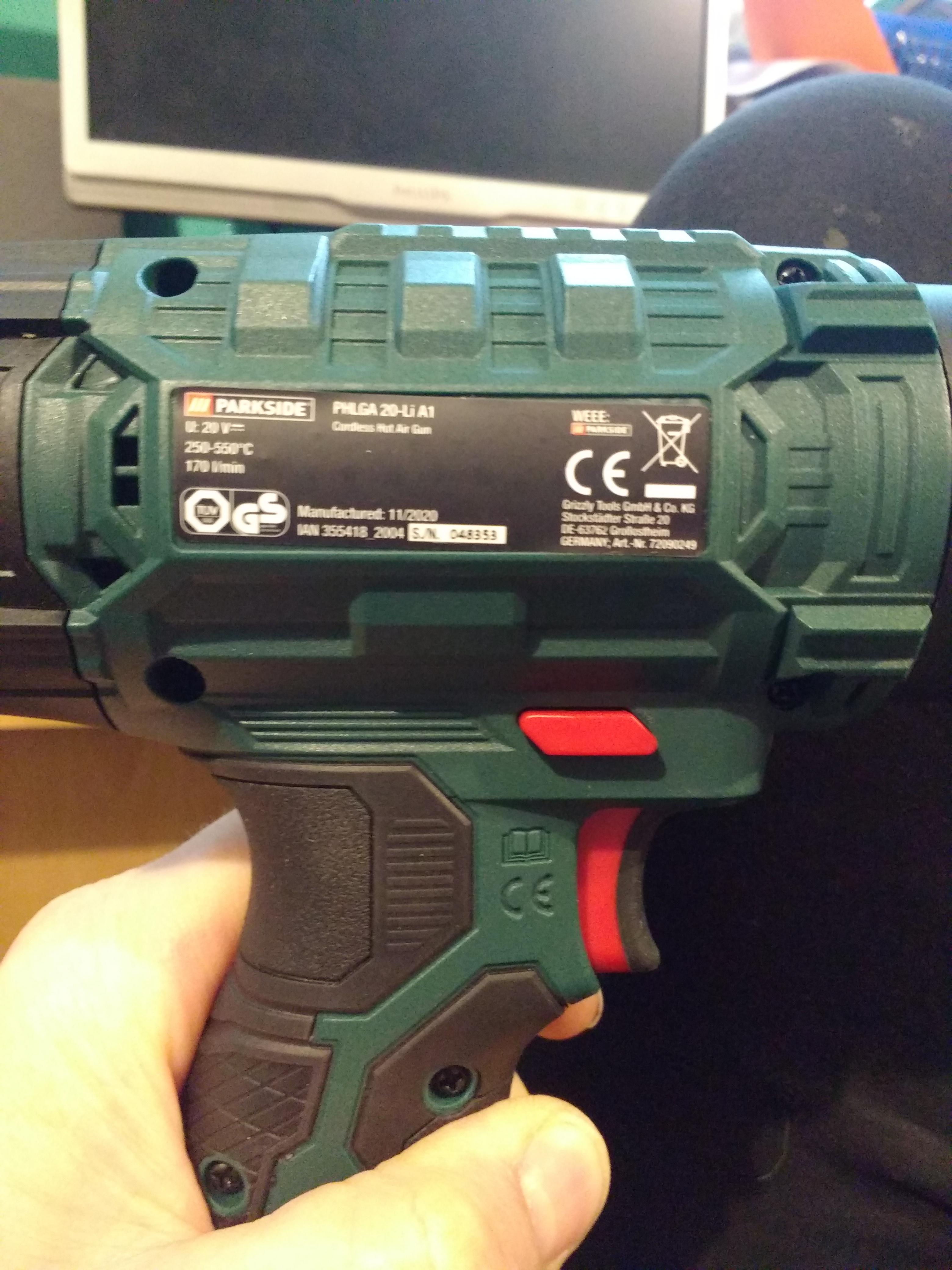

Nice work. How would you rate the hot air gun?

I'd read the hot air gun was a bit pants and from the quick "holding against the hand test" last night, might agree. However, that was with a non genuine, clone battery, not fully charged. All I want it for is the odd bit of heat shrinking, on a roof where I'd otherwise have to run a lead.
It adequately did the job on a bit of heat shrink last night albeit took longer than say my Bosch 230V would have done. I'll report back on that. Be interesting too, to use outside in near freezing temperatures. Had problems in the past trying to use low wattage soldering irons in that situation.

The tricky ones to get hold of are the sprung "finger" contacts that engage with these blades hence my salvaging them from dead batteries.
