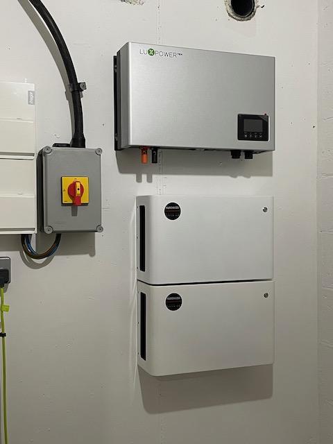

Thorfun Posted October 10, 2022 Posted October 10, 2022 I've gone LuxPower (SquirrelPod) and Chinese batteries (Hanchu Ess https://www.hanchuess.com/low-battery.html). it's a good system that seems to work well but I've since learned it only supports 13A on EPS/UPS load so not quite a whole-house power cut solution but definitely enough to keep the lights and the router on! the LuxPower inverter works by using CT clamps on the solar and grid feeds and it works out if it needs to discharge or can charge. seems to do a great job so far but it's only been running a couple of weeks and we're not even in the house yet! but I do have the EV charger running off the new house so I can set that to get energy from PV and to supplement it from the batteries if PV isn't generating enough. I bought all my stuff direct from Big Green Beard and my electrician wired it up after I hung it on the wall. this is from before it was wired up.

Benguela Posted October 10, 2022 Author Posted October 10, 2022 3 hours ago, Thorfun said: I've gone LuxPower (SquirrelPod) and Chinese batteries (Hanchu Ess https://www.hanchuess.com/low-battery.html). Looks good!

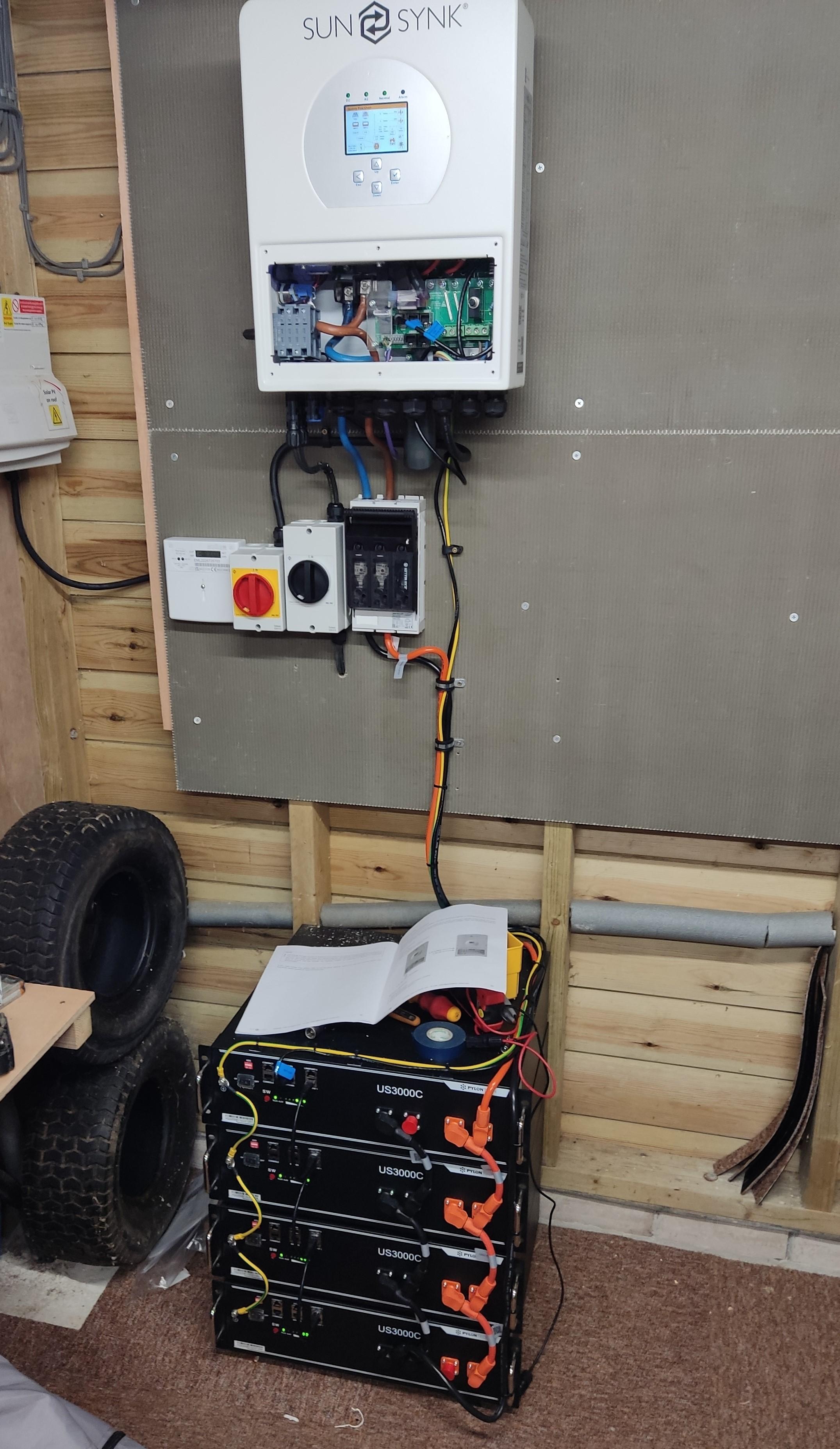

pudding Posted October 11, 2022 Posted October 11, 2022 I had a pre-existing 4kWp array from 7years ago, and this year have added another 3.6kW Sunsynk hybrid inverter with 3.5kW more PV panels and 4x Pylontech US3000C batteries giving me 14kWh storage. The inverter uses a single CT clamp around the incoming mains grid supply, so that whenever export is detected, it will redirect and charge the batteries if needed, so it scoops up excess from the pre-existing array too; it doesnt care where the excess comes from.
