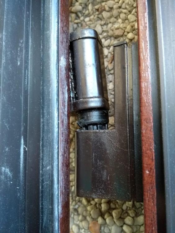

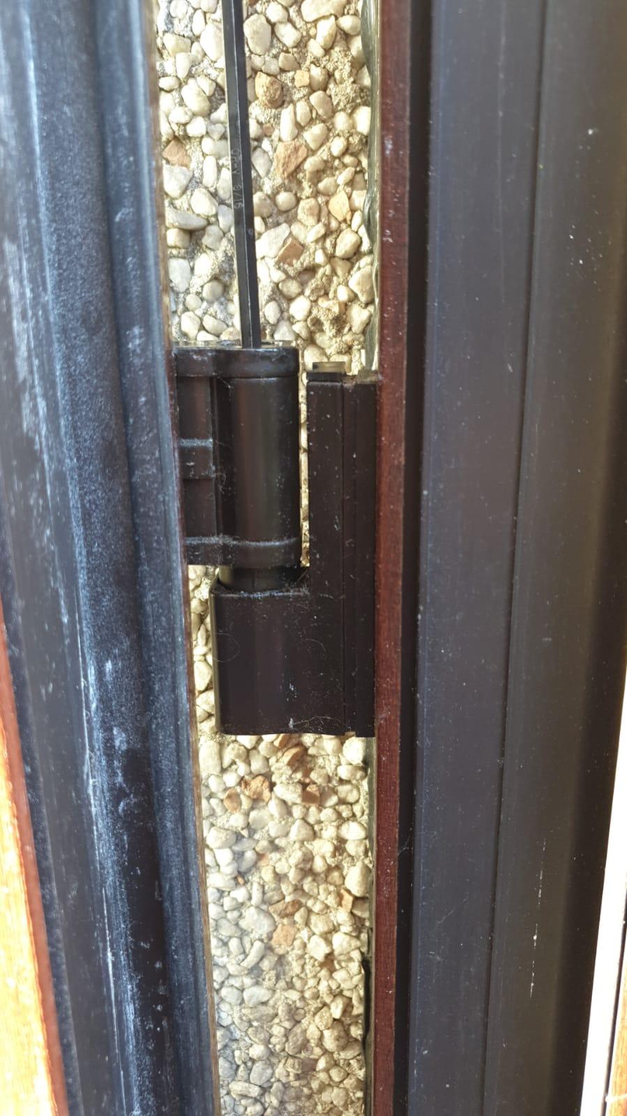

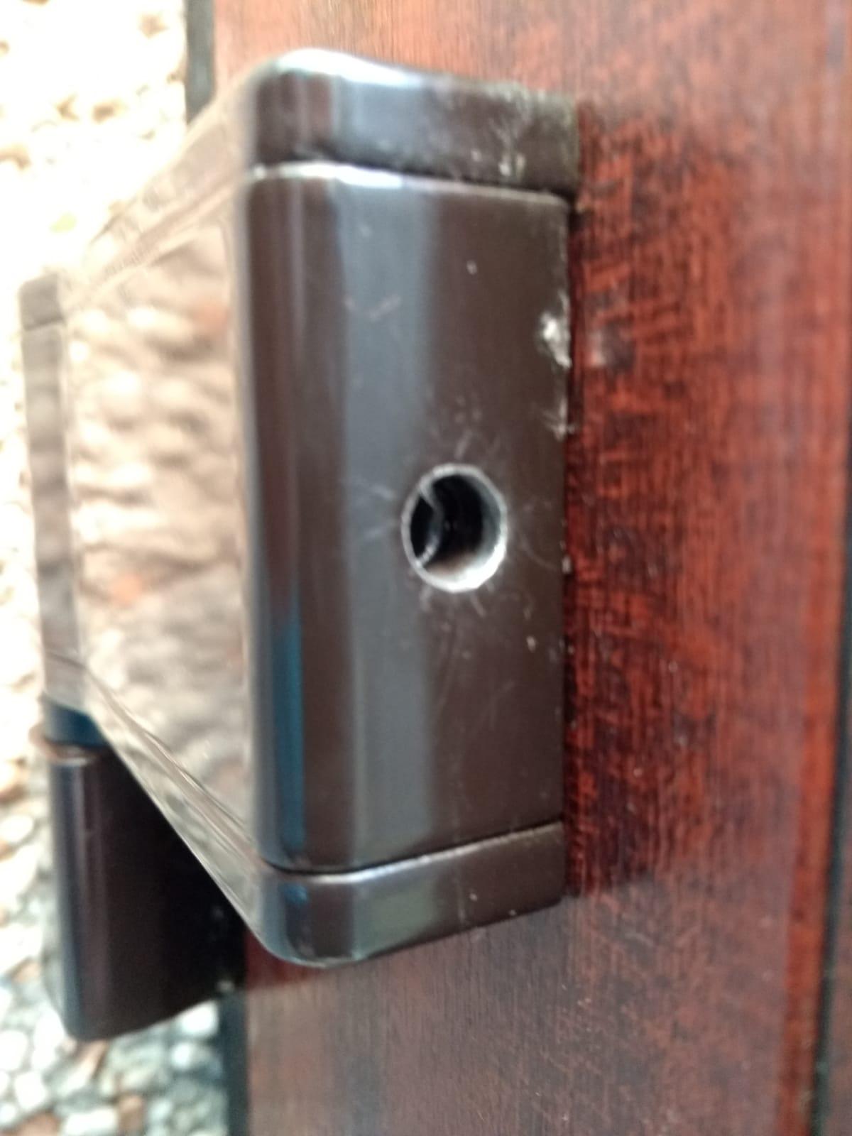

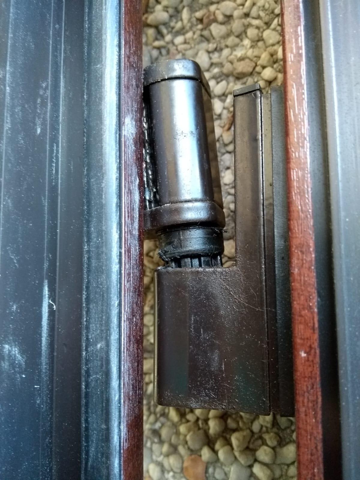

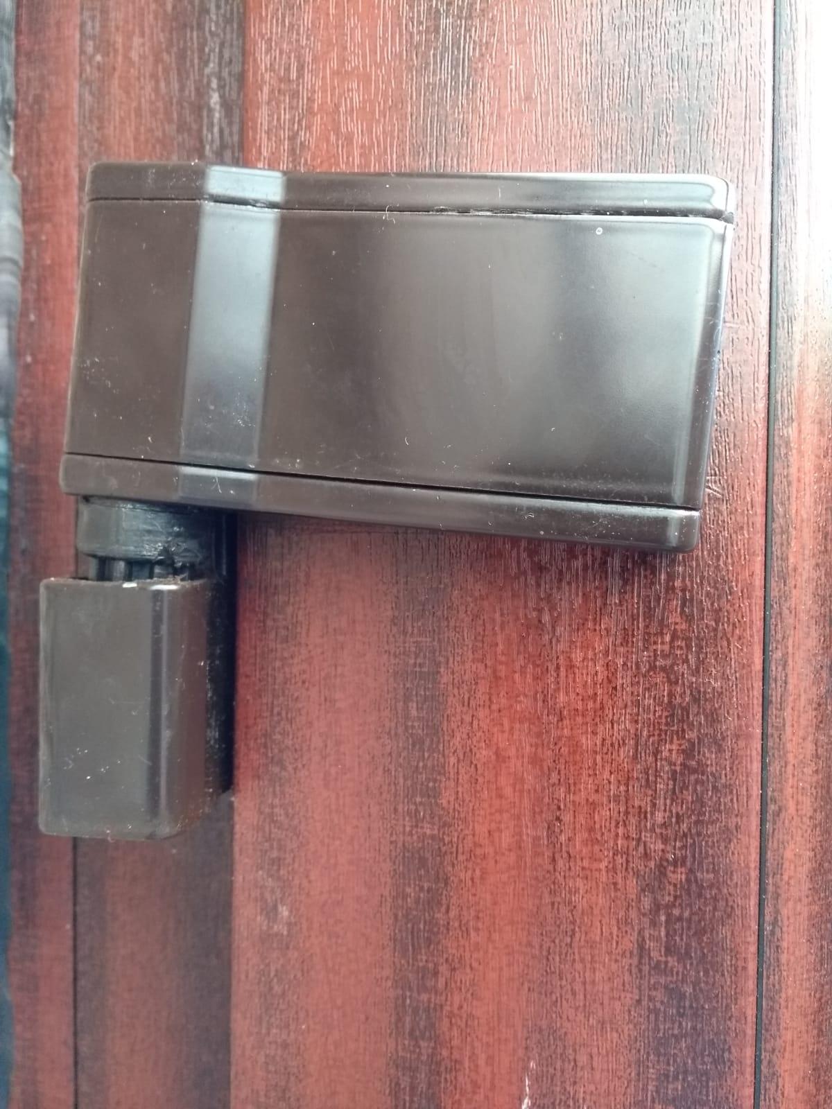

Bob8 Posted September 23, 2022 Share Posted September 23, 2022 My dad has replaced the door seal on the conservatory door now the hinge has dropped and door lock not locking. Any ideas? He has tried looking on line how to get to the mounting screws to adjust the hinge but can't find anything. Any advice on how to get the hinge cover off? Link to comment Share on other sites More sharing options...
Temp Posted September 23, 2022 Share Posted September 23, 2022 Never seen that type before but I'd try looking in the hole in that last photo to see if there is a screw or Allen key screw in there that releases the cover or even the whole door. Take care, I'd want help to support the door before undoing anything and put packing under the door to take the weight. Link to comment Share on other sites More sharing options...
Bob8 Posted September 24, 2022 Author Share Posted September 24, 2022 13 hours ago, Temp said: Never seen that type before but I'd try looking in the hole in that last photo to see if there is a screw or Allen key screw in there that releases the cover or even the whole door. Take care, I'd want help to support the door before undoing anything and put packing under the door to take the weight. Thanks. There is a Allen key in there but doesn't matter if try to undo it no cover comes off Link to comment Share on other sites More sharing options...
dpmiller Posted September 24, 2022 Share Posted September 24, 2022 I think that cover just clips over- try gently levering away from the door just where the hole is for the Allen... Link to comment Share on other sites More sharing options...
