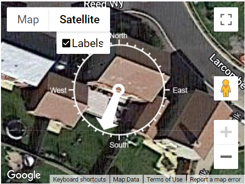

Jason213 Posted September 21, 2022 Share Posted September 21, 2022 Hi everyone I’ve been thinking and reading about solar panels for some time, and to be honest I’ve found it a bit of a minefield of information. I haven’t started contacting suppliers/installers yet as I want to know what I want to achieve before getting quotes in, although I have registered with solartogether.co.uk. My family: 2 adults, and 2 young children (1 and 3). No EV yet.. just two diesel cars and will probably change to one EV in 3-5 years time. Mrs and kids are home by 4pm 3 days per week and home the rest of the time (apart from me working FT). Current house: New build house built 2017 (120 sq mtr) in the South East (GU32 post code). Combi boiler (gas 35 kw) for hot water and heating. EPC rating B (84) - Air permeability 4.4 m³/h.m² (as tested) Well insulated with additional loft insulation which I have done. Air con installed, which can also heat as well as cool. The house roof is 8.5mtrs wide with no shading and faces SSSW as below (this could hold 7x2 rows). We also have a double garage facing the same orientation, which could hold a second array. That is 6.5 mtrs wide – I’m not sure if it could fit 5x2 rows, but definitely could fit 5 panels. Current Energy Usage Elec usage daily: Average 8.46 kwh per day, (max 18 kwh) (5% of the time 12 kwh or more since we’ve lived here) (5% of the time 4.5 kwh or less) Gas usage daily: Average 20.6 kwh per day (average over the year) (38 kwh in all the December’s) (Max 67 kwh) (5% of the time 45 kwh or more) Based on a 540watt panels, the house could hold 14 panels totalling 7.5kw array The garage could hold 2.7kw array I would also like it to work in a power cut. Now, where do I start? My budget would be £15-20k tops for panels and batteries. Ultimately, I want the biggest array possible when the scaffolding is up hence the 500+ watt panels, and ultimately be as off grid as possible. I would probably want to register for feed in tariff payments, just so that is set up. Looking at our usage, and (https://re.jrc.ec.europa.eu/pvg_tools/en/) a 7.5kw array could produce 9.3 kwh in December, rising to 31.5kwh in June. So almost cover all of our current electricity use for the majority of the year on average. If we got a 10kw array (using the garage aswell), that would be 12 kwh in December, rising to 42kwh in June. The surplus, I would look into storing hot water, Elec heating/cooling for the house and a future EV. I’m not sure if it’s possible to install a hot water tank due to the weight, although do have the space upstairs. So I like the idea of something like SunAmp. But I accept this is the next step after panels and batteries. I also like the idea of topping up on a cheaper night time tariff if required (but may not be required with such a large array). What systems do people recommend? I liked the idea of a Tesla Power Wall, but I don’t think I can have more than one due to needing a 3 phase? Secondly, they are completely unavailable now. I’ve read Solar Edge only works with their own components, so you’re tied to them if you go that route. I don’t have a clue what the best panels or inverter are. What size batteries do you think I would require? Obviously the larger the better, but something like 25 kwh (i.e. 3 days average usage)? I’m aware some people say do it in stages (panels, then batteries), but I would rather it all installed and working in one hit. I would also want to give me as much power as possible during winter when top up from the grid is inevitable. Thanks! Link to comment Share on other sites More sharing options...
Marvin Posted September 21, 2022 Share Posted September 21, 2022 Hi @jason213 This may help with your battery calculations... Based on your home with 10kW system this is December 2020's calculated daily production using the PVGIS. Note the variance over the days: (assumptions: GU32 10kW, roof angle 40 deg, Azimuth -22, system loss 5%) 24,017 4,442 1,515 4,119 11,816 16,774 3,285 28,062 8,637 1,278 8,262 18,298 1,967 2,024 11,259 2,634 11,027 1,282 11,197 19,542 3,870 5,990 3,988 27,743 28,824 2,816 23,547 2,730 12,745 21,850 15,055 Total for December. 340,593kWh Of course this is just December 2020. Other Decembers can vary widely from year to year. Good luck M Link to comment Share on other sites More sharing options...

Marvin Posted September 22, 2022 Share Posted September 22, 2022 (edited) Put as many panels up as possible is my advice. Knowing that you will be above the permitted export allowance you will have to apply to the DNO (distribution network operator ) for their permission. (DNO Survey: will the local mains cables take the load/supply. will the substation take these changes, will the supply cables to your home take these changes and so on) Last fee I was charged was £300+vat for the SURVEY and about two to 3 month for reply. The survey can state that other works will need to be carried out to achieve your installation. Read the small print on the application about what your agreeing to pay for by submitting the application! The application has to be done BEFORE the installation is commenced. I would suggest before any decisions are made (you buy all the gear and they say the infrastructure changes will cost you £10k for example). Be aware that battery storage before the inverter will not make a difference to your exporting capability. Battery storage after the inverter will, and will need to be added to the amount your are proposing to export (as far as I understand) Calculations for the DNO will be based on the maximum that the Inverter will export (not on the amount of PV on the roof etc) and calculated on 'after Inverter battery supply'. (As above, if I have this right). If you don't do this all at the same time, you will then need to apply for the increase in potential upgrade later. (you could go for just the permitted now but the inverter would be too small in the future....) Check battery for power volume to output. One of my 100amp 12v batteries can only supply about 40% of it's capacity before damaging the battery. So I need 2.5 times the storage of what I want to use. Other battery types will have a higher capacity to supply but will cost more... Depending on the inverter you can install more PV panels than the invert will export. Ours is limited to 6000W but you can install almost 8000W Hope this helps M Edited September 22, 2022 by Marvin further thought Link to comment Share on other sites More sharing options...
