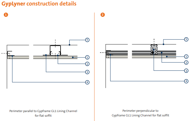

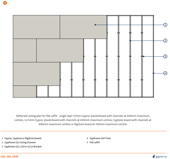

MortarThePoint Posted September 17, 2022 Share Posted September 17, 2022 (edited) GL1 channels at 400mm c/c for 12.5mm plasterboard and 600mm c/c for 15mm plasterboard. Brackets (e.g. GL2) only need to be every 1200mm. Not clear how far first bracket can be from perimeter track (GL8), but diagram below suggests pretty far, so may be OK at 1200mm. Will probably limit myself to 600mm to first bracket. British Gypsum components: Channel GL1 & GL1 datasheet Perimeter Track GL8 & GL8 datasheet GL3 connectors for extending GL1 Brackets: GL2 (<=75mm), GL9 (<=125mm) and GL12 (<=175mm) for under solid (hollow core concrete in my case) soffit A Hough alternative brackets: AH185 (=GL2) AH186 (=GL9) AH175 (=GL12) Edited September 17, 2022 by MortarThePoint Link to comment Share on other sites More sharing options...
MortarThePoint Posted September 17, 2022 Author Share Posted September 17, 2022 Plasterer is nervous about channel being flat enough, so plan mount GL1 on brackets (GL2) slightly high, and then use a laser to adjust each one down to level using packer between bracket and concrete (all approx 230 of them). that should get all to within 1 or 2mm of level. Using TechFast masonry screws with Hex & Torx head (link) well priced at CPC. Note: fully threaded unlike photo. Also have some 32mm ones, which will limit to GL8 if used at all. Link to comment Share on other sites More sharing options...
MortarThePoint Posted September 17, 2022 Author Share Posted September 17, 2022 Tempted to use 15mm plasterboard and 600mm centres to reduce the workload, but that puts up the load per bracket by 80%, though I think the brackets are OK with a double layer of 15mm anyway. Starting in a smaller area so will get an ideal of work rate. Link to comment Share on other sites More sharing options...

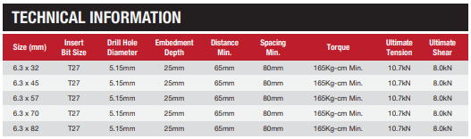

MortarThePoint Posted September 18, 2022 Author Share Posted September 18, 2022 (edited) Specs of the TechFast masonry screws are the same for all lengths, 10.7kN = 107kg. 2 layers of SoundBloc plasterboard with 600mm x 1200mm centres would be 21kg per screw (perhaps 25kg with skim). Edited September 18, 2022 by MortarThePoint Link to comment Share on other sites More sharing options...

Annker Posted November 2, 2022 Share Posted November 2, 2022 11 minutes ago, MortarThePoint said: Hi Annker, I got pulled away onto other more urgent bits. I have got a small room reads (GL8 round the edge and brackets in place). The brackets can be at 1200mm centres so that is one fixing per 0.48m2 or 0.72m2 depending on whether you are at 400mm or 600mm c/c respectively. I forget what centres the top hat hangers go in at but isn't it similar? I'll share some pictures and thoughts when I get back on it which will be in a couple of weeks hopefully. For the sake of a few extra lengths of metal I'd recommend to go 400 c/c with regardless of using 12.5mm or 15mm pb. Hangers for the main support channel (used to support tophat sections) are at 1200 c/c and FYI the spec states that 1st hanger can be positioned at 1200 c/c (i.e. no hanger is required at the start adjacent to the wall) however I always used to put a hanger at the start despite a friend's advice (who was professional fixer) insisting it was not necessary! Another useful tip for any MF work is when connecting two metal components together that a much more robust connection is made if screws are driven from the lighter gauge metal into the heavier gauge metal, if that makes sense. For example, with the MF system this means that screws are driven into the lighter gauge hangers to the heavier gauge main support channel and not visa verse. 1 Link to comment Share on other sites More sharing options...
