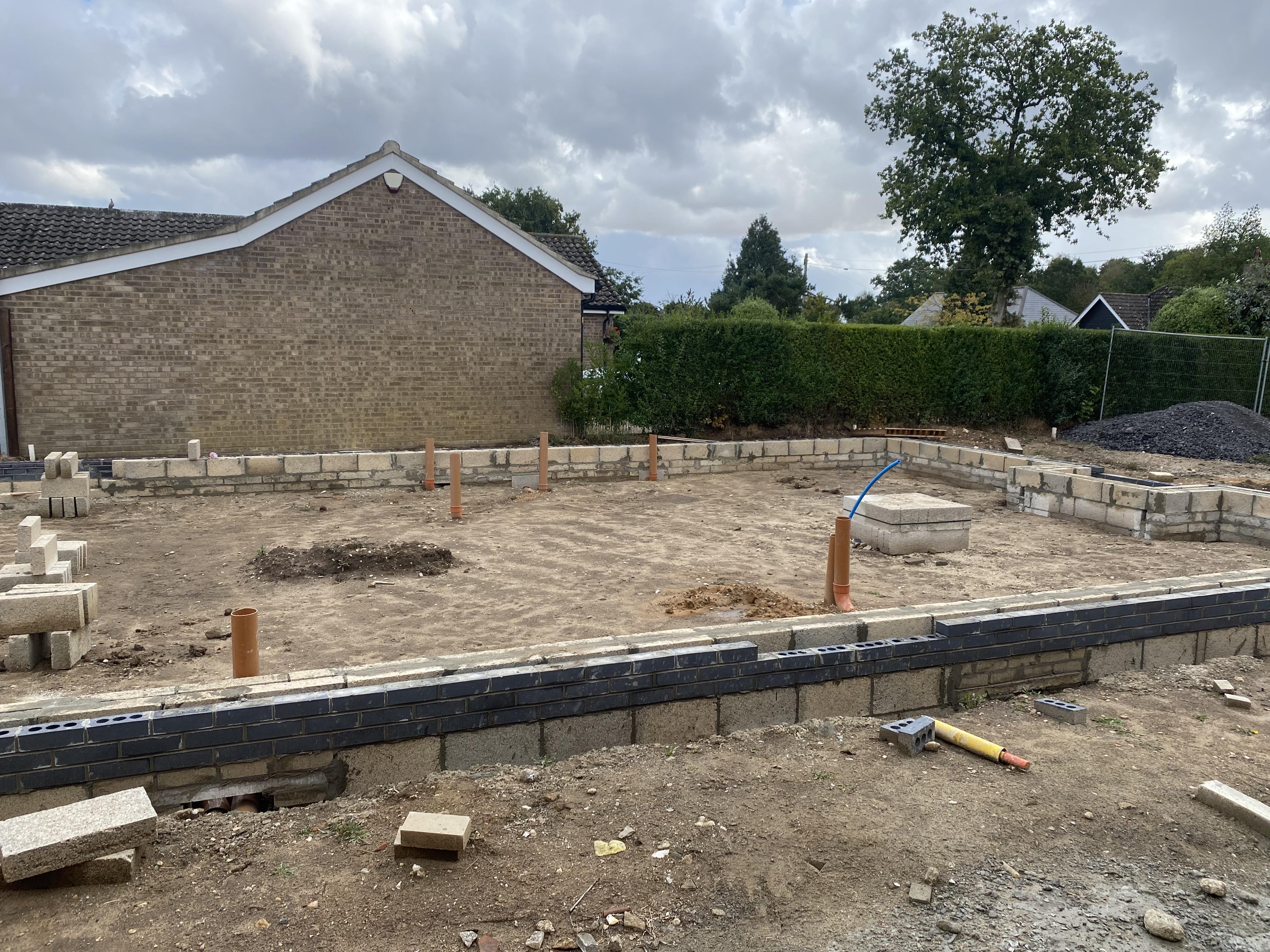

Our groundworkers have laid soil pipe runs under our subfloor, leaving the pipe sticking up through the beam & block floor for later connection.  I'm a bit concerned the stub isn't particularly long, as they likely underestimated the floor build-up thickness.  There's a coupler on end, which at the current height would end up embedded in the floor screed.  Is this likely to problematic?  Thinking it might be worthwhile replacing with a longer length that can be cut down later, whilst it's still reasonable accessible through the floor?
I agree. Don't like the idea of having a coupling in the screed.
Sounds like plan, I'll get it sorted then - thank you!!

Soil pipe is cheap so yes put a longer bit in, I have left mine quite tall, less likely to trip over them then 😀
