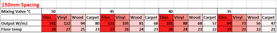

You are trying to heat a big chuck of concrete/screed, if it's 70m2 you could be 8 to 10 Tonnes.  So getting it to temperature takes a fair bit of energy, after that you are managing heat input to heat losses.
Would strongly suspect you are running it too hot.  The heat output of the floor is governed by the mean flow temp.  So the bigger the delta T the higher the flow temp needs to be to the same output v a low delta T but the higher the flow rate.
Have attached a sheet to help you calculate the mean flow temperature you need.  Ignore the lines already on there.
You will need to know the floor area and heat load required.  Then from that calculate the W/m2.
PHE19_Fix3.thumb.jpg.748b20dbede32ef52deac686cbba1481.jpg1113139219_PHE19.Fix2(1).thumb.jpg.e6f5b10749b0a8b28a782f83356b9791.jpg
Have a play.

Great, thanks for those. Interestingly, those don't seem to match with what the UFH company sent me when purchasing my kit;
The City Plumbing Heat Loss Calc suggests I need, on average 100W/m2. Which is works out at approx 7 kWh. Perhaps I need to leave it running for longer to see what the energy usage looks like once the slabs at heat for a period of time? I could live with 7 kWh until I get around to fitting the IWI!
Its a pretty crappy calculations tool, it says my house needs 15kW, in reality it needs 3kW - on the coldest day.
The output of the tool isn't kWh it's kW, so you will use 7x24hrs per day if the calculation tool is to be believed, to heat a 70m2 area. So 168kWh per day.  In gas terms after Oct that's £17 per day, plus the other house heating.
Interestingly, I've just had a fiddle with Jeremy Harris' heat loss calc, I included upstairs (radiators) and downstairs (UFH) and it's coming out at approx 17.5 kW (20c delta T). Perhaps that's more accurate and would be a better representation of the impact of installing given insulation.

Jeremy spreadsheet is pretty good.  Would trust it over some generic tool on the internet.
