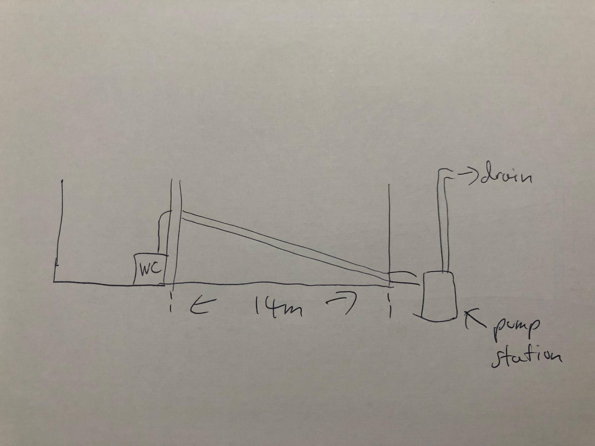

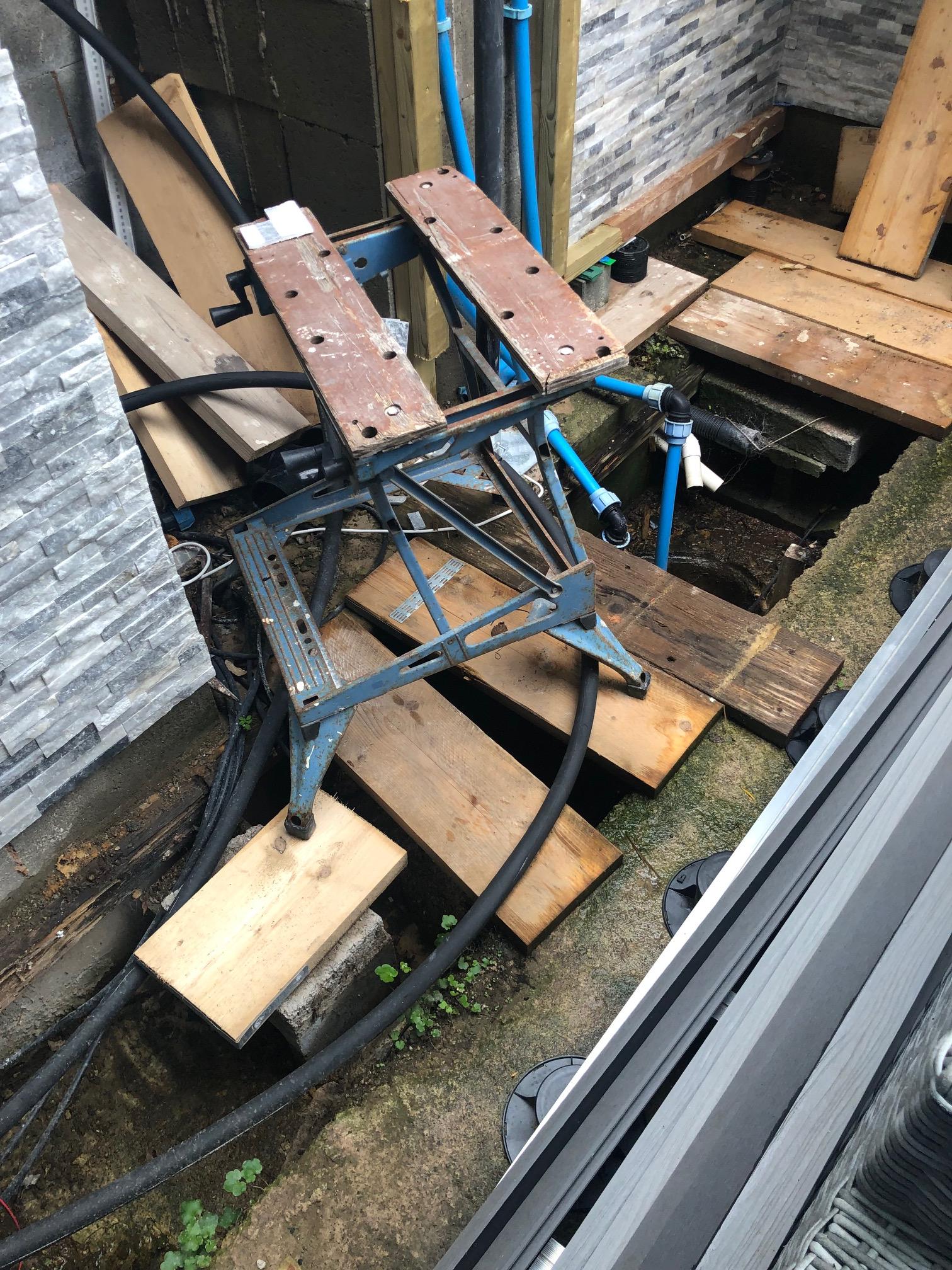

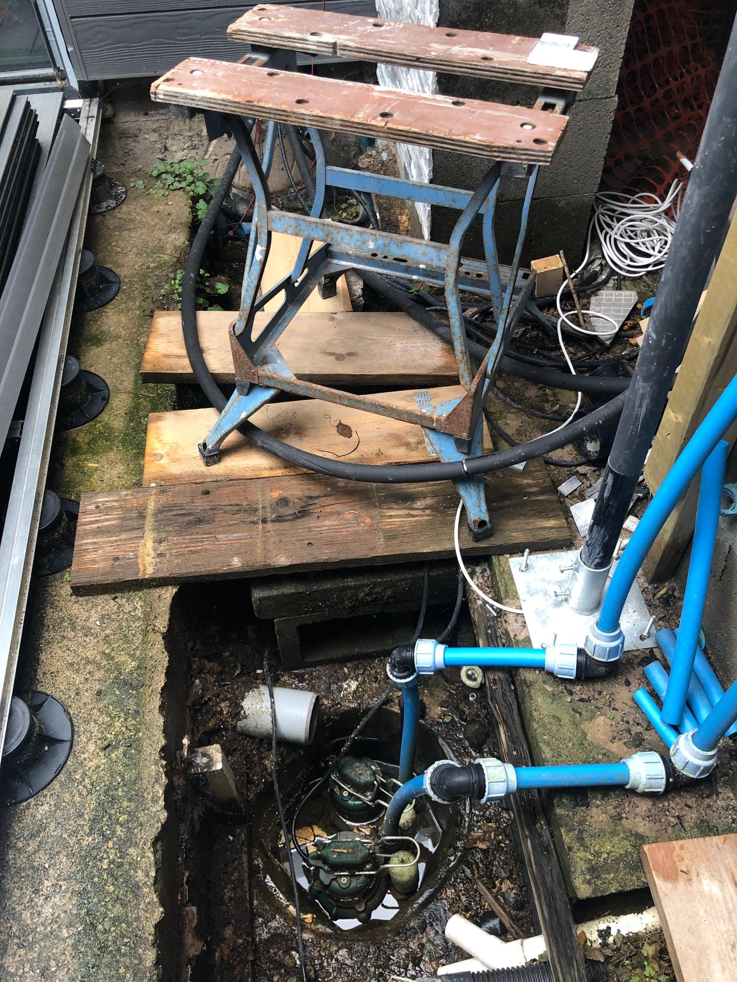

Pocster Posted September 10, 2022 Posted September 10, 2022 This is happening!. The plan!. Macerator at WC ( no bitching about that ). Outlet's to about 1 metre high. Then a horizontal run with fall for about 14 metres ( also picking up sink/washer etc. waste ). This then into sump pumping station outside. What I 'improvised' though many years ago was just to deal with rainwater i.e. 2 zoller pumps to deal with rainwater. Question is now how to get a sump in there aswell or 'somehow' that the sump ( possibly a twin pump unit ) deal with rainwater aswell - making the the 2 pumps I have redundant. Suggestions welcome !
