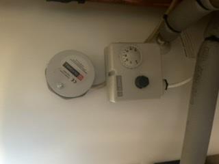

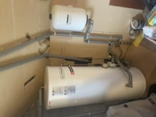

TonyT Posted August 28, 2022 Posted August 28, 2022 What’s the temp set on the dial on the cylinder/hot water tank?
Ando Posted August 28, 2022 Author Posted August 28, 2022 21 minutes ago, TonyT said: What’s the temp set on the dial on the cylinder/hot water tank? 60 degrees
TonyT Posted August 28, 2022 Posted August 28, 2022 Any problems with the hot taps temperature in the bathroom next to the shower?

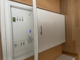

JohnMo Posted August 28, 2022 Posted August 28, 2022 Your boiler flow has to be higher than the set temperature of the cylinder. So if you want 60 degs in the cylinder, the flow temp coming from the boiler will have to higher. That the first thing to check. If the flow temp is 50 the cylinder will only get to 50 if direct or lower if indirect (heats via a cylinder coil).
Ando Posted August 28, 2022 Author Posted August 28, 2022 The temp coming out the tap is 47. I have no idea what it should be. The boiler flow temp is set to 74 so shouldn’t be a problem there. The max it can be set to is 82.
Ando Posted August 29, 2022 Author Posted August 29, 2022 On 28/08/2022 at 12:23, JohnMo said: Your boiler flow has to be higher than the set temperature of the cylinder. So if you want 60 degs in the cylinder, the flow temp coming from the boiler will have to higher. That the first thing to check. If the flow temp is 50 the cylinder will only get to 50 if direct or lower if indirect (heats via a cylinder coil). Turned boiler up for todays hot water and had timer on for only 30 mins - did the trick. Shower nice and hot this morning and again this afternoon. My understanding following a long day of searching this forum / googling / you tubing yesterday is as you say high setting on boiler for efficient HW heating. But the opposite for the central heating system - a low setting for lower flow temp to avoid cycling (literally the only way I have ever used central heating previously). I don’t think my boiler is compatible with the clever systems that allow HW priority / load bearing / weather monitoring etc.. so need to now try figure out if any savings from that technology make it worthwhile to replace the boiler with one that is compatible.
