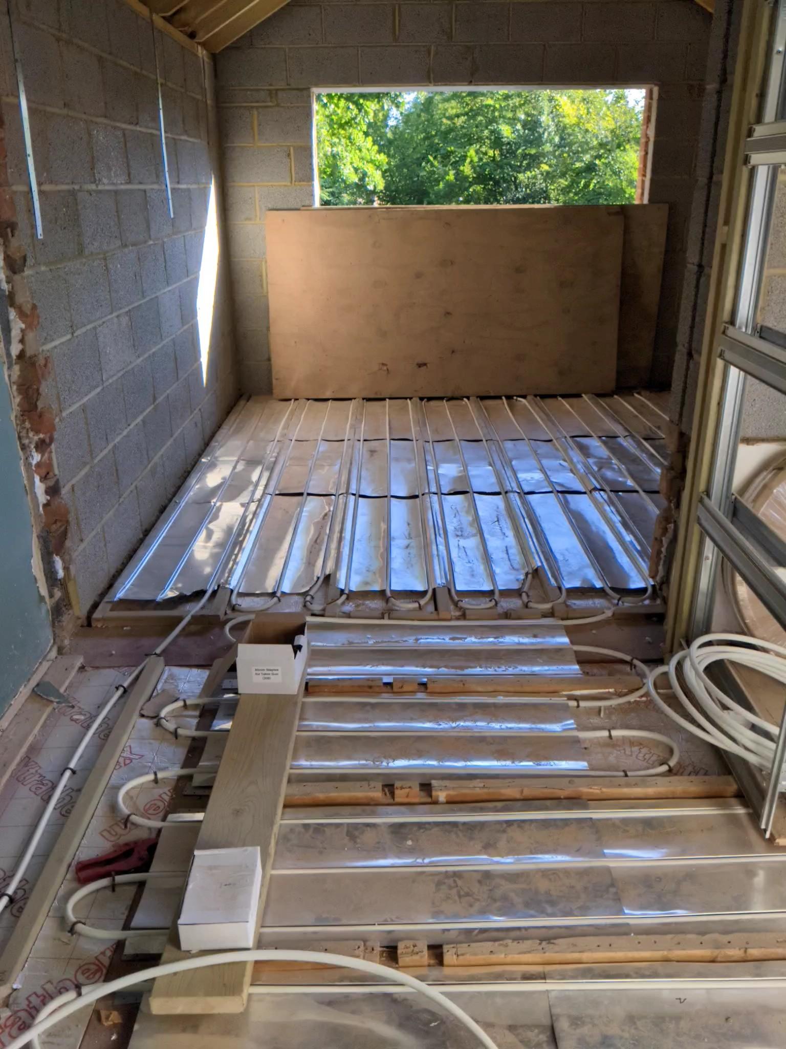

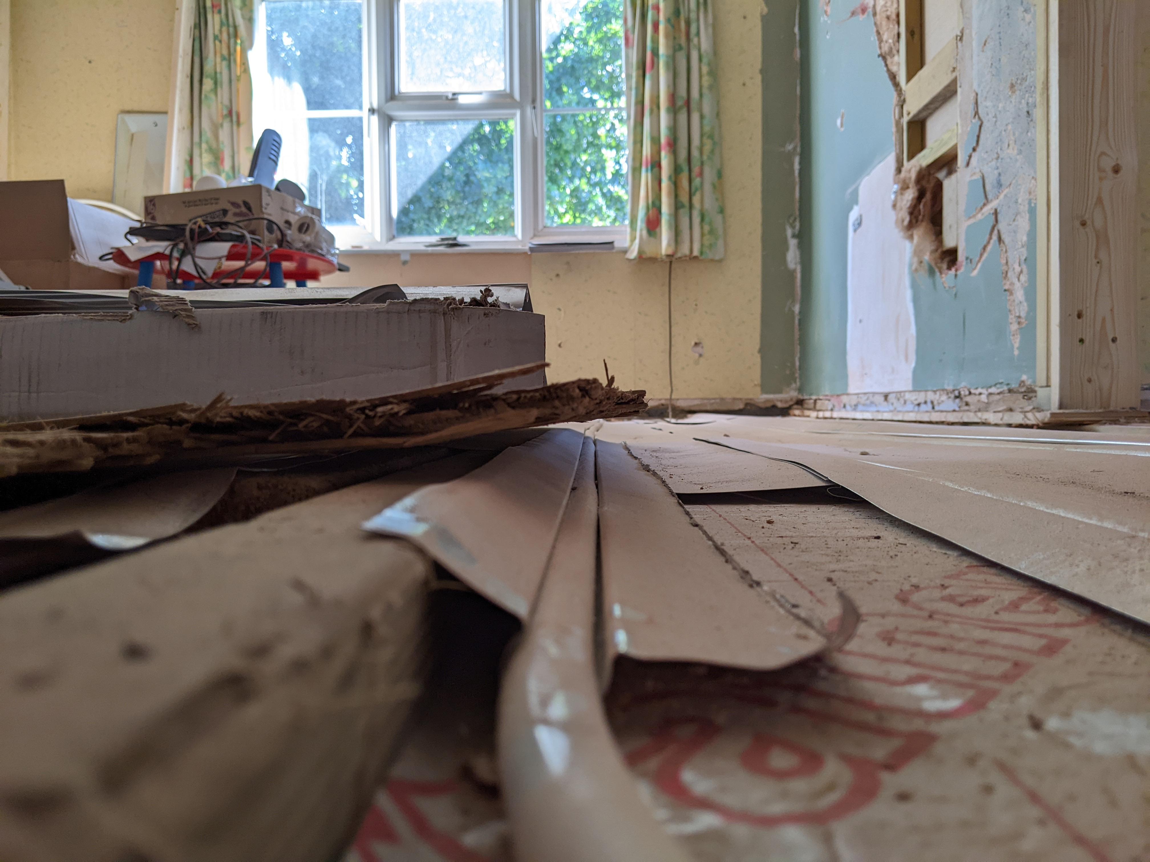

ADringer Posted August 14, 2022 Share Posted August 14, 2022 Hi, I've got spreader plates currently being installed, and at first they were installed incorrectly. The insulation was installed too low and so the plates bent from the joist down to the boards rather than being flat. They were also installed overlapping. This is now being rectified, however I'm a little concerned about the uniformity of the plates. If they were installed properly initially then the plates would be completely flat, however as they have been bent previously I'm concerned there might not be full contact between the plate and subfloor and so be less efficient. I've attached photos of the plates. It still needs to be redone (boards need to be brought up a little) but are the plates ok to use if installed correctly or should I just scrap them and get replacements to ensure uniformity? Thanks! Link to comment Share on other sites More sharing options...
markc Posted August 14, 2022 Share Posted August 14, 2022 You will never get full contact between the plate and subfloor, and the plates are there to distribute the heat overs wider area. Bends are easily flattened out and you never see them after fitting so creases and bends are not a problem Link to comment Share on other sites More sharing options...
Nickfromwales Posted August 14, 2022 Share Posted August 14, 2022 If there’s no access from below, eg to staple the plates to the underside of the floorboards / deck, then I always recommend putting sufficient mineral wool directly under the plates to make them distended. The fact they’re left raised up by the wool means that when the deck gets screwed down, the wool compressed and maintains the contact between the plates and the deck. You’d need to spend an afternoon manually reshaping these to get the sag out of them, but no need whatsoever to discard them imho, just needs a bit of time and elbow grease. Leaving the PIR insulation where it is and fit the wool on top of it, as long as it won’t move south under compression of course. Link to comment Share on other sites More sharing options...
ADringer Posted August 14, 2022 Author Share Posted August 14, 2022 46 minutes ago, Nickfromwales said: If there’s no access from below, eg to staple the plates to the underside of the floorboards / deck, then I always recommend putting sufficient mineral wool directly under the plates to make them distended. The fact they’re left raised up by the wool means that when the deck gets screwed down, the wool compressed and maintains the contact between the plates and the deck. You’d need to spend an afternoon manually reshaping these to get the sag out of them, but no need whatsoever to discard them imho, just needs a bit of time and elbow grease. Leaving the PIR insulation where it is and fit the wool on top of it, as long as it won’t move south under compression of course. Ok great, thanks. The builder was happy to move the insulation up from below, but would wool be a better solution to ensure they are distended in this case? Link to comment Share on other sites More sharing options...
