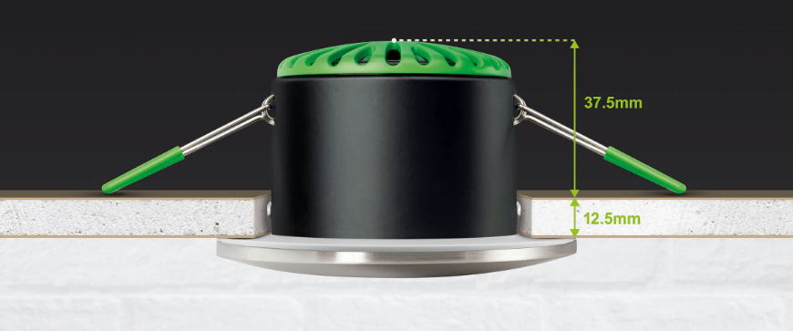

MortarThePoint Posted August 5, 2022 Posted August 5, 2022 I'm keen on having downlights in the bathrooms like the JCC V50 shown below. I am installing a polythene vapour barrier in the ceiling as there is insulation and loft above and a bathroom is obviously one of the most humid spaces. How to I deal with the downlight as that will make a pretty big hole in my vapour barrier?
JohnMo Posted August 5, 2022 Posted August 5, 2022 You get down-lights that are about 15mm tall. A service batten 50mm tall will be enough space for the little control box.
MortarThePoint Posted August 5, 2022 Author Posted August 5, 2022 2 minutes ago, JohnMo said: You get down-lights that are about 15mm tall. A service batten 50mm tall will be enough space for the little control box. Is that creating a 50mm void under the vapour barrier and above the plasterboard then? I'm using Resilient Bars. So I have stuck the polythene to the underside of the truss bottom chord and then screwed the Resilient bar underneath. The resilient bar is 16mm high so there is a 16mm void.
JohnMo Posted August 5, 2022 Posted August 5, 2022 So you could use something like. These are 25mm deep. 16+12.5, gives 27.7 height, if you are using 15mm plasterboard then 31mm height. https://www.toolstation.com/enlite-slim-fit-round-low-profile-led-downlight/p56573?store=LJ&utm_source=googleshopping&utm_medium=feed&utm_campaign=googleshoppingfeed&mkwid=_dm&pcrid=&pkw=&pmt=&gclid=Cj0KCQjw_7KXBhCoARIsAPdPTfh3zjexFfspXlESIQ7o08bNkmHonb00JmuXlD4QTK_uFsPn5L0xW5caAsd4EALw_wcB&gclsrc=aw.ds
MortarThePoint Posted August 5, 2022 Author Posted August 5, 2022 22 minutes ago, JohnMo said: So you could use something like. These are 25mm deep. 16+12.5, gives 27.7 height, if you are using 15mm plasterboard then 31mm height. Thanks, that looks like an option. It has a driver too, but I can probably bulge the vapour barrier slightly where that goes.
