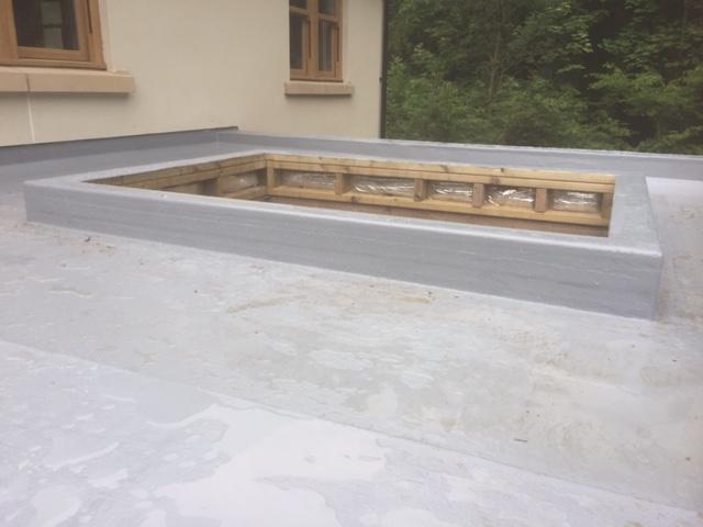

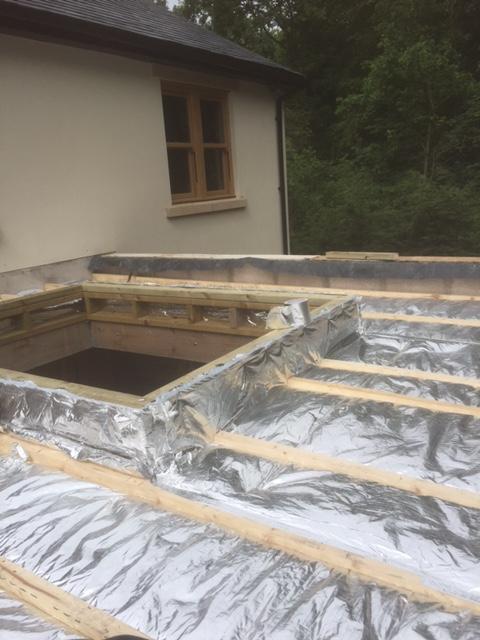

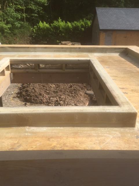

Orangery roof is now ready for copings and lantern
The most difficult part was keeping everything dry prior to the fibreglass going on

@nod Only just spotte this. Did you do the GRP yourself in the end? Simple enough? Certainly looks good from the photo's.
Sorry only just seen your question
Yes my wife and myself did the woodwork and all the falls on the Sunday Intending to fibreglass on the bank Holliday the following day But had to cover it up till the following Thursday
The fibreglass went on easy enough But the top coat had to be done later that evening due to the direct sunlight and heat
