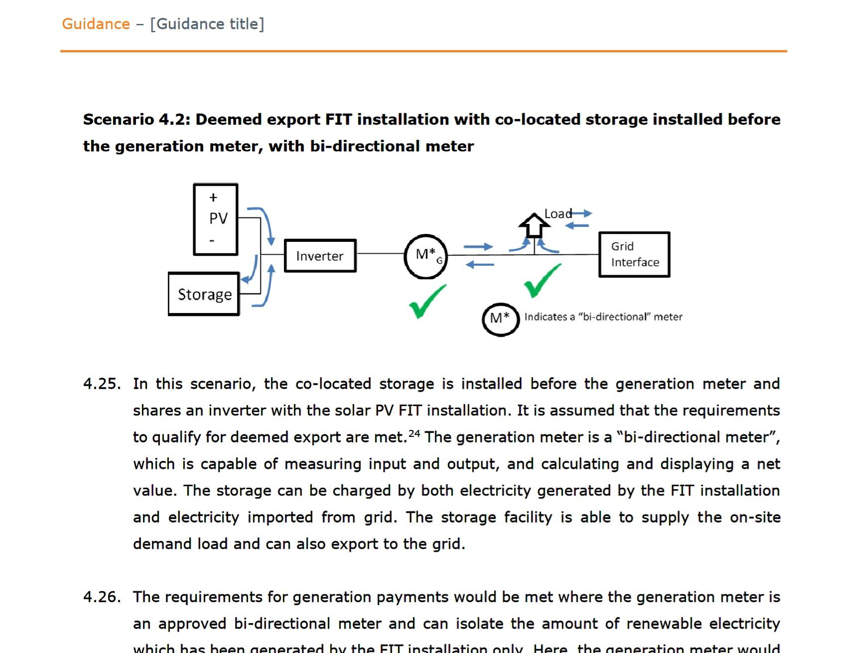

bontwoody Posted July 30, 2022 Author Share Posted July 30, 2022 So Ive had a couple of realisations on reading the documents. If I want to keep my FIT payments and use off peak charging for the batteries then I will have use an AC coupled system so I dont confuse the generation meter readings. In that case there isnt really any advantage to oversizing the panels since the clipped output would be wasted. I cant actually see either how the TIC would be calculated if the inverter size was smaller than the panel size. My guess is that they would use the panel size which would disadvantage me. I think my choices will be: 1. leave the panels and inverter untouched and just add an AC coupled battery system 2. upgrade the panels and current inverter up to 4kW and add an AC coupled battery system probably sensible to do 1. first and then complete 2. once the current inverter fails. Link to comment Share on other sites More sharing options...
bontwoody Posted July 30, 2022 Author Share Posted July 30, 2022 Addendum. I was wrong about the installation having to be AC coupled if I want to keep my FIT payments. It can be DC coupled if a bi-directional meter is used. Link to comment Share on other sites More sharing options...
