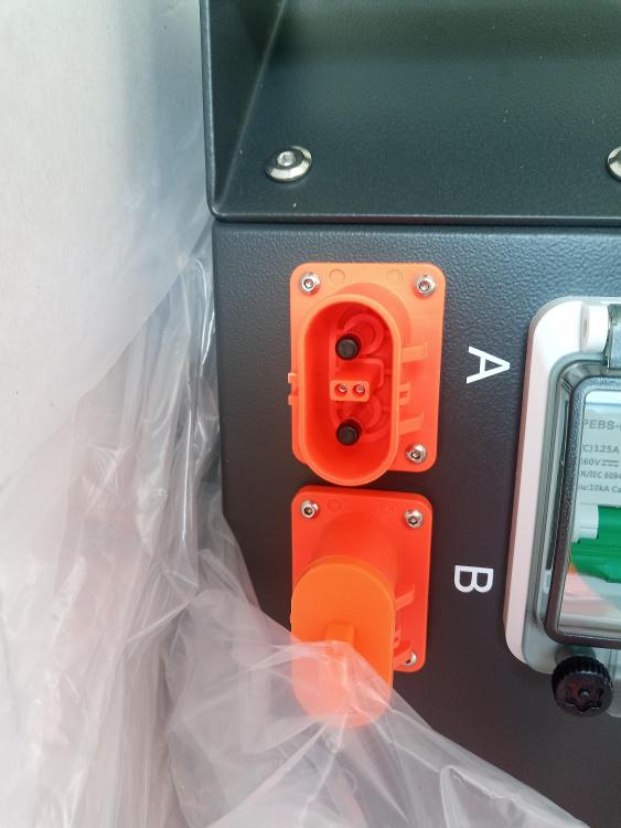

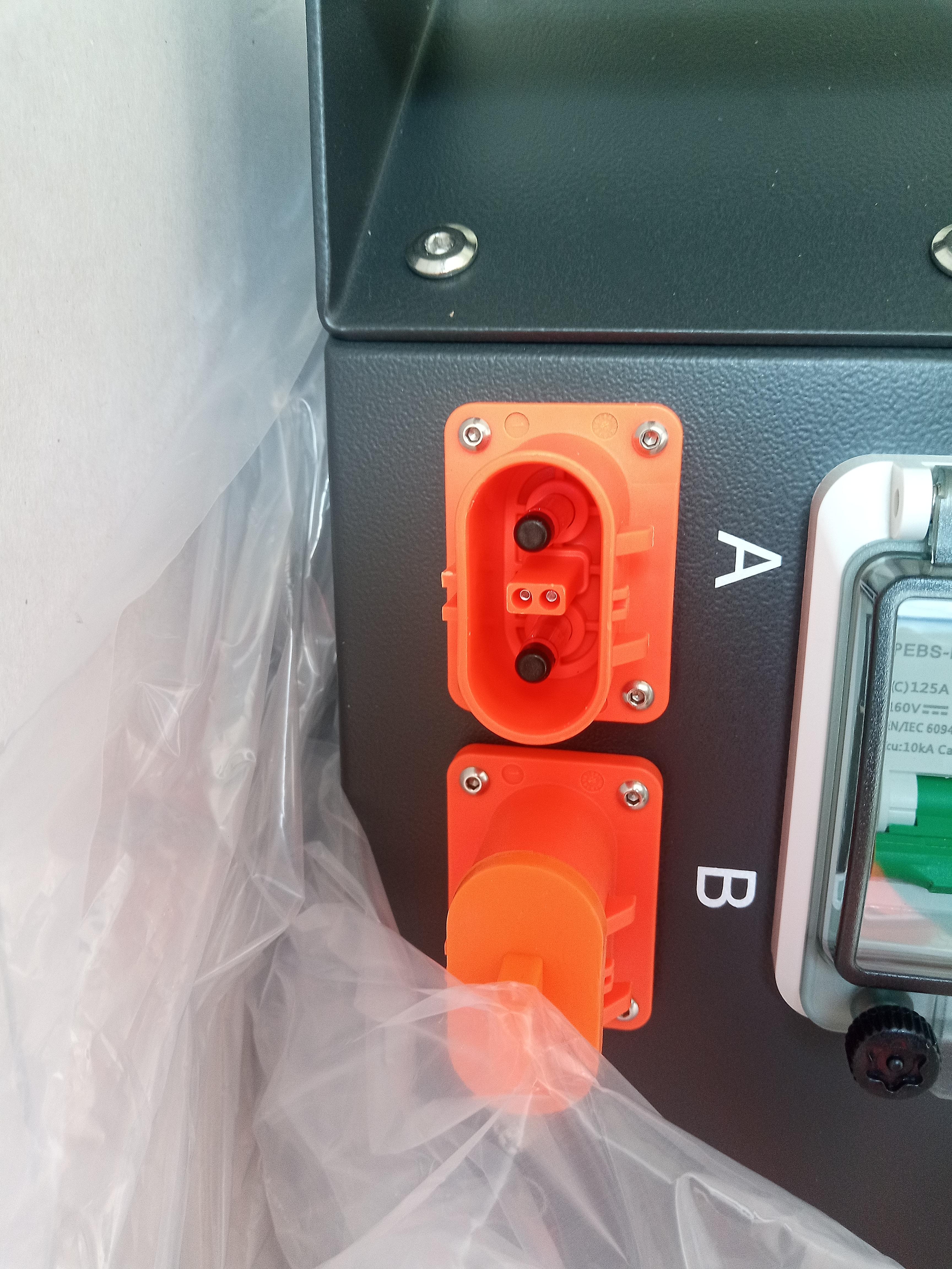

I hope one of you may be able to help me identify this plug type. Our battery storage arrived yesterday and it came without a lead and so far I have failed to find a supplier with one in stock. If I can identify the plug type I can make one UP as I have crimpers etc. The socket is 38mm x17 mm with two DC 6mm pins and two small signal cable pins.
Any idea what the plug type is? so I can get one from CEF or RS
Mystery solved thanks to Mr Harris:
That's a high voltage 150A interlock connector, mostly used in EVs.  Renhotec make them and the part number you want is HVIL150-2P-AO-C35 for the free socket (I think).  The fixed plug you have is part number
HVIL150-2S-AO-M6 (I think).  The fixed plug web page is here: https://www.renhotecev.com/product/hvil-high-voltage-interlock-connector-2pin-6mm-150a-socket-plastic-w-busbar-m6-thread-hole  and the free socket web page is here: https://www.renhotecev.com/product/hvil-high-voltage-interlock-connector-2pin-6mm-150a-straight-plug-plastic-shell
