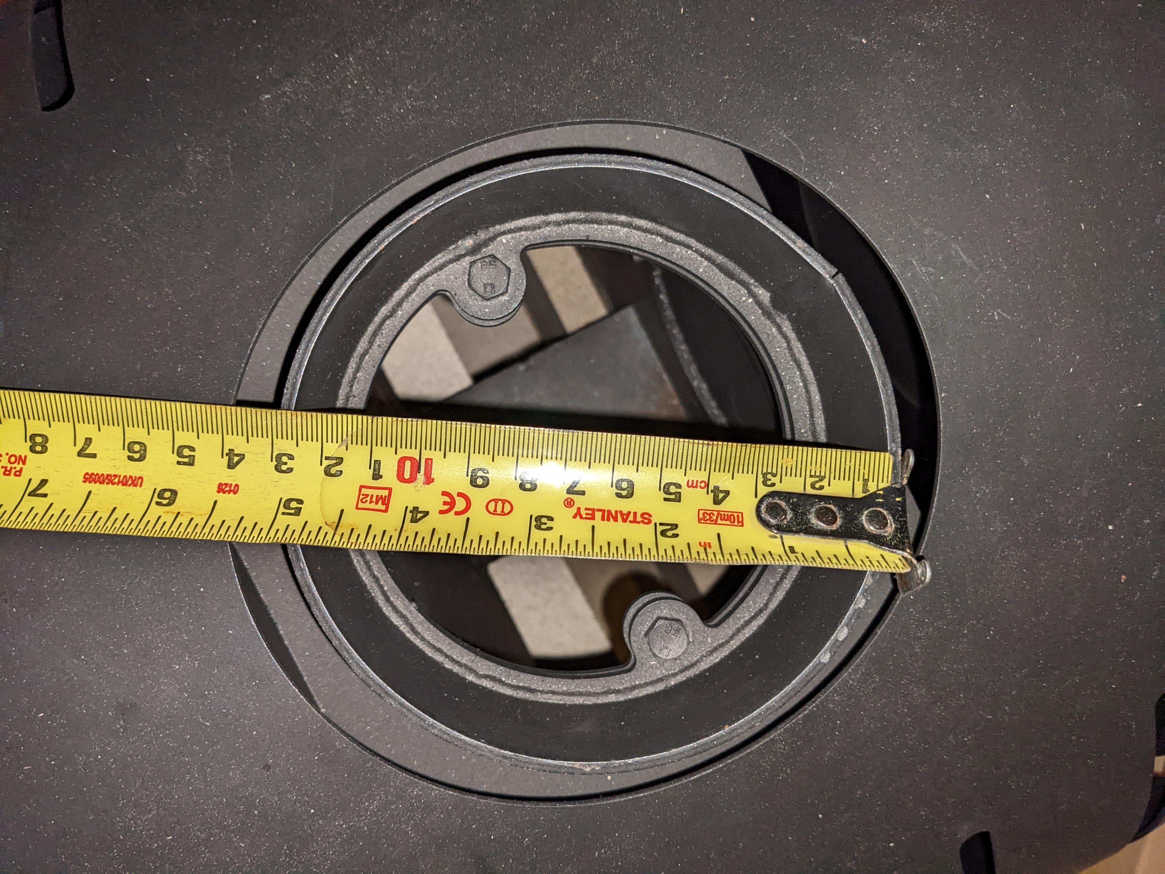

Stove connection to twinwall
This is the stove connection. Manual says "130 mm" flue" is required.
In practice it is approx 129 mm OD / 123 mm ID:
How would we go from this to "130 mm" twinwall:
https://www.sauresta.com/en/lower-cower-npnp/104
Do we need something like a "120 to 130 mm increaser" and sealing material? (i.e. 130 mm twinwall is 130 mm OD for the liner)
https://www.sauresta.com/en/increaser/78
Or is "130 mm" twinwall more like 120 mm OD for the liner?
I can ask supplier but language barrier for me / weekend etc.

Answer:
Pop the connection off the stove; chop the existing 129mm OD ring to 1cm high, weld another ring of mild steel around it; now you have >130 mm ID for going direct to 130 mm OD twinwall without adapters.
Weld on the inside and water/airtight.
