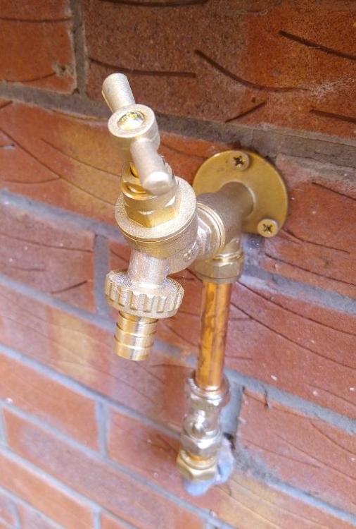

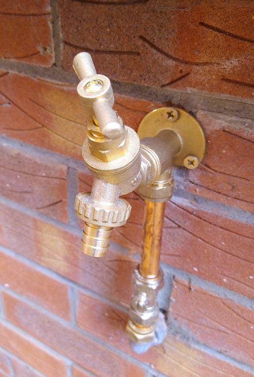

idiot question (!) but a had a replacement outdoor tap fitted but my hose connector doesn't fit it anymore. Is there a quick release connector available / adapter or are you meant to just bung the raw 1/2" hose end onto this tap for it to work? Thanks!
Ignore! I went to screwfix but couldn't figure out how to attach what they gave me until I read the Q&A. You unscrew the fitting and replace it with something like "HOZELOCK BRASS THREADED OUTDOOR TAP CONNECTOR (95018)" and you're done! Can attach my old hose now!
Yes:
...or just dip the hose end in hot water / warm up with a heat gun, push it on and secure with a jubilee clip
