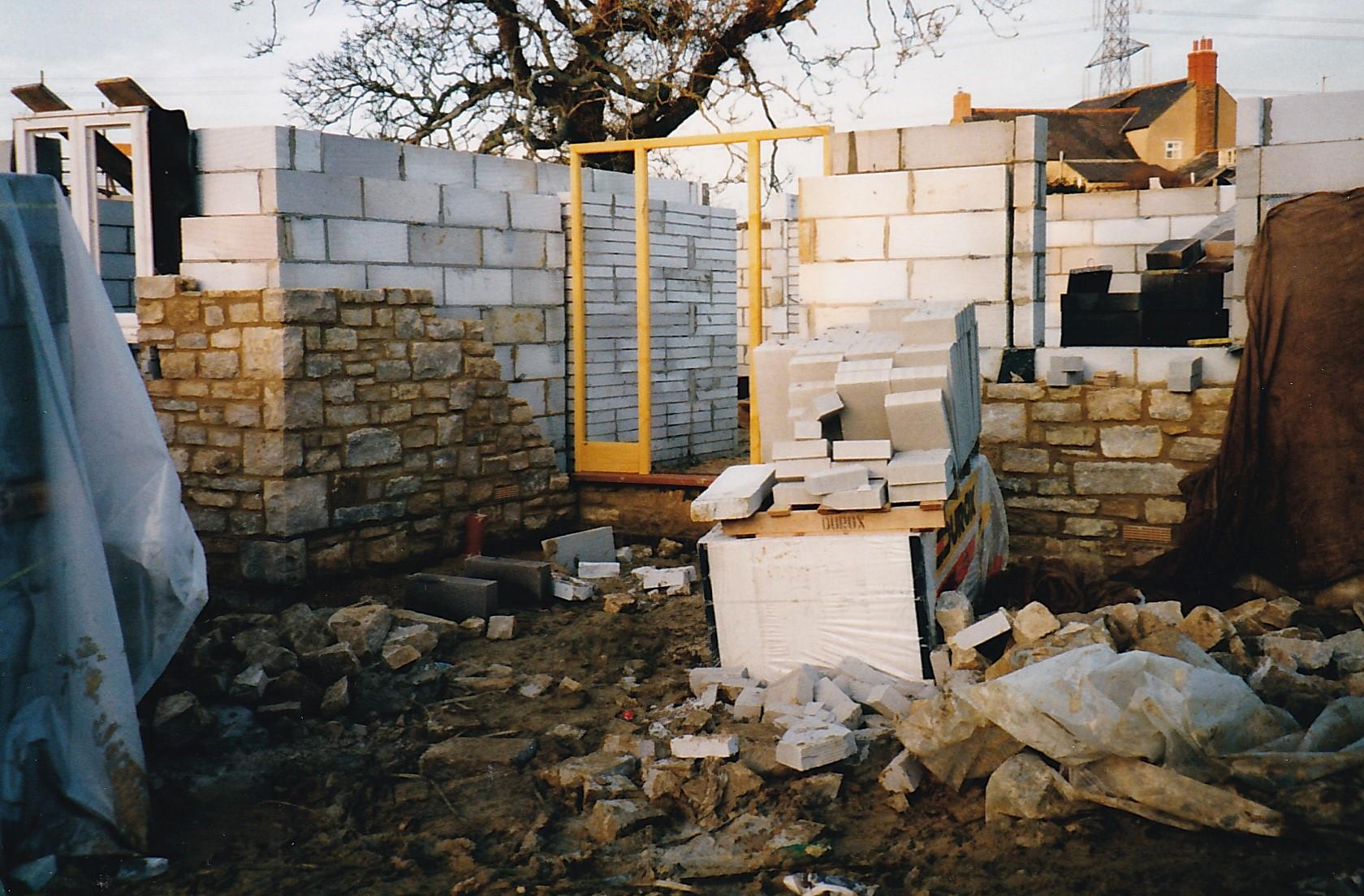

Radian Posted July 1, 2022 Posted July 1, 2022 My house being built back in 1997: What a mess. Anyhow, the palette has Durox printed on it. But the blocks look long and skinny to me, not a size Durox currently make. The ones laid flat, inside the front door, are presumaly around 70mm thick to get three courses per upright block. They laid them flat wherever the stone cladding wasn't, to make up the width. The innermost leaf is, I'm pretty sure, 100mm thick. Then a 50mm empty cavity, then 70mm outer leaf clad with ~150mm cropped walling sandstone. Durox don't seem to do this size anymore but I was hoping to find some data on it.
Mr Punter Posted July 1, 2022 Posted July 1, 2022 These? https://tarmac.com/products/blocks/durox-supabloc/
Radian Posted July 1, 2022 Author Posted July 1, 2022 23 minutes ago, Mr Punter said: These? https://tarmac.com/products/blocks/durox-supabloc/ Ta, but that's what I found and they only show the following block thickness (mm) 50 100 140 200 It can't have been any of those.
