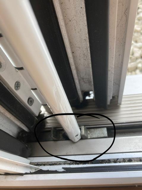

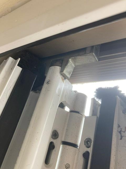

Need to source a new one of these which has broken. No idea what it is called!
Circled pic is the broken one, other pic is the intact one at the top of the doors.
Posted
Goggle images is good for this but I drew a blank on what it is called, can only think its called trolley or door carrier if its the part with wheels. You need as Simon suggests start with name of manufacturer and then look for spares supplies who stock their parts.

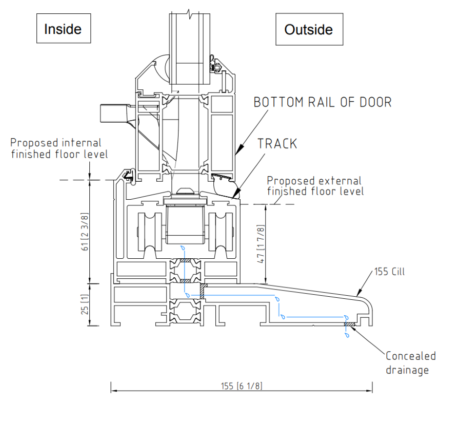

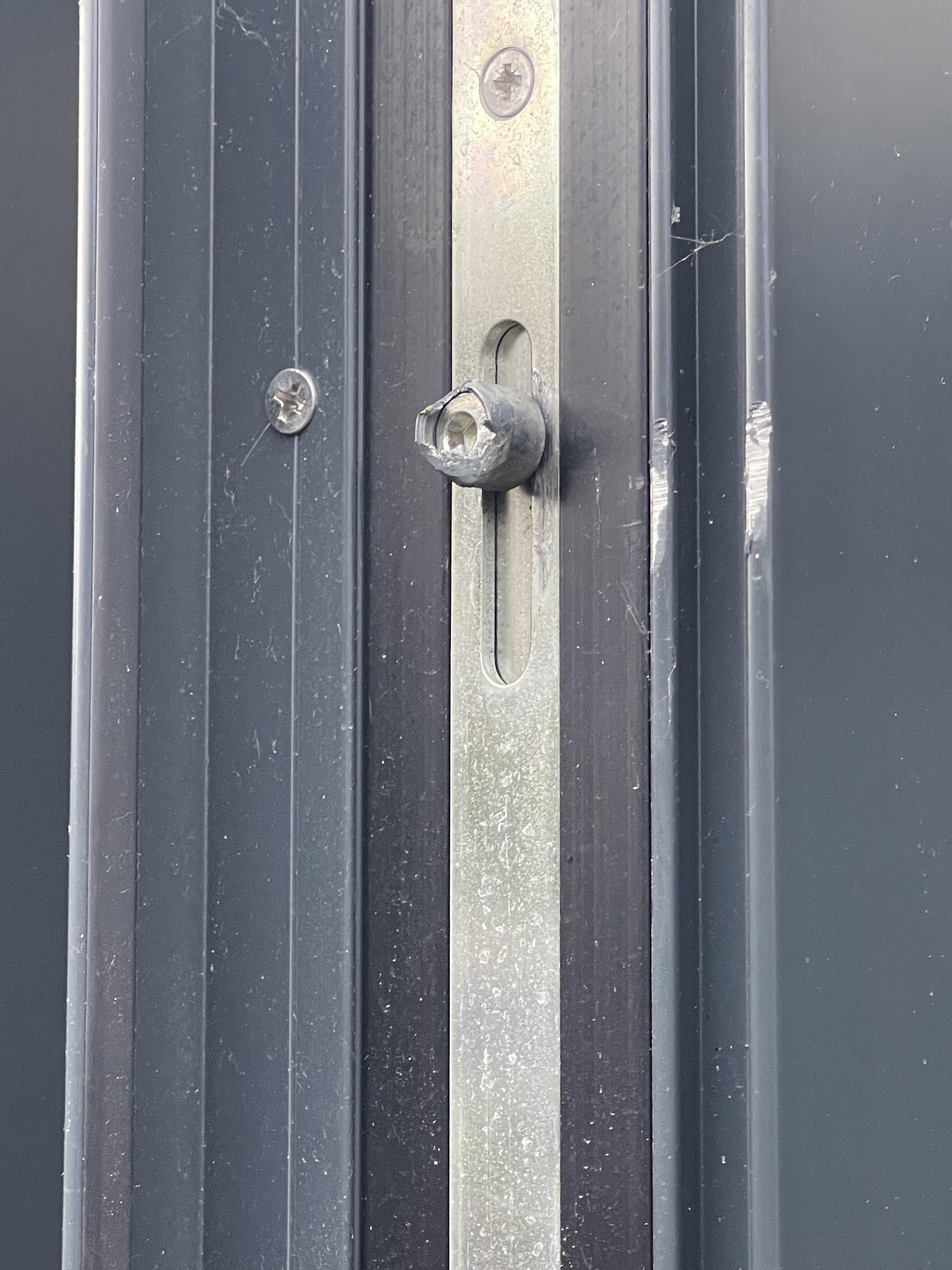

Posted
Hi sorry to jump in on this post I’m just wondering if anyone knows what this is called. And if I can get them on there own of if I have to buy the hole lock.
  • 2 weeks later...
Posted
Its an adjustable pin, start by finding the makers name usually stamped on the steel middle section. I replaced a whole one recently but threw the old one away or I could have looked at the pin to see if its detachable, it can be adjustable using an allen key in the centre but never fully unscrewed one. If you need the whole replacement there are a number of measurements to take.
