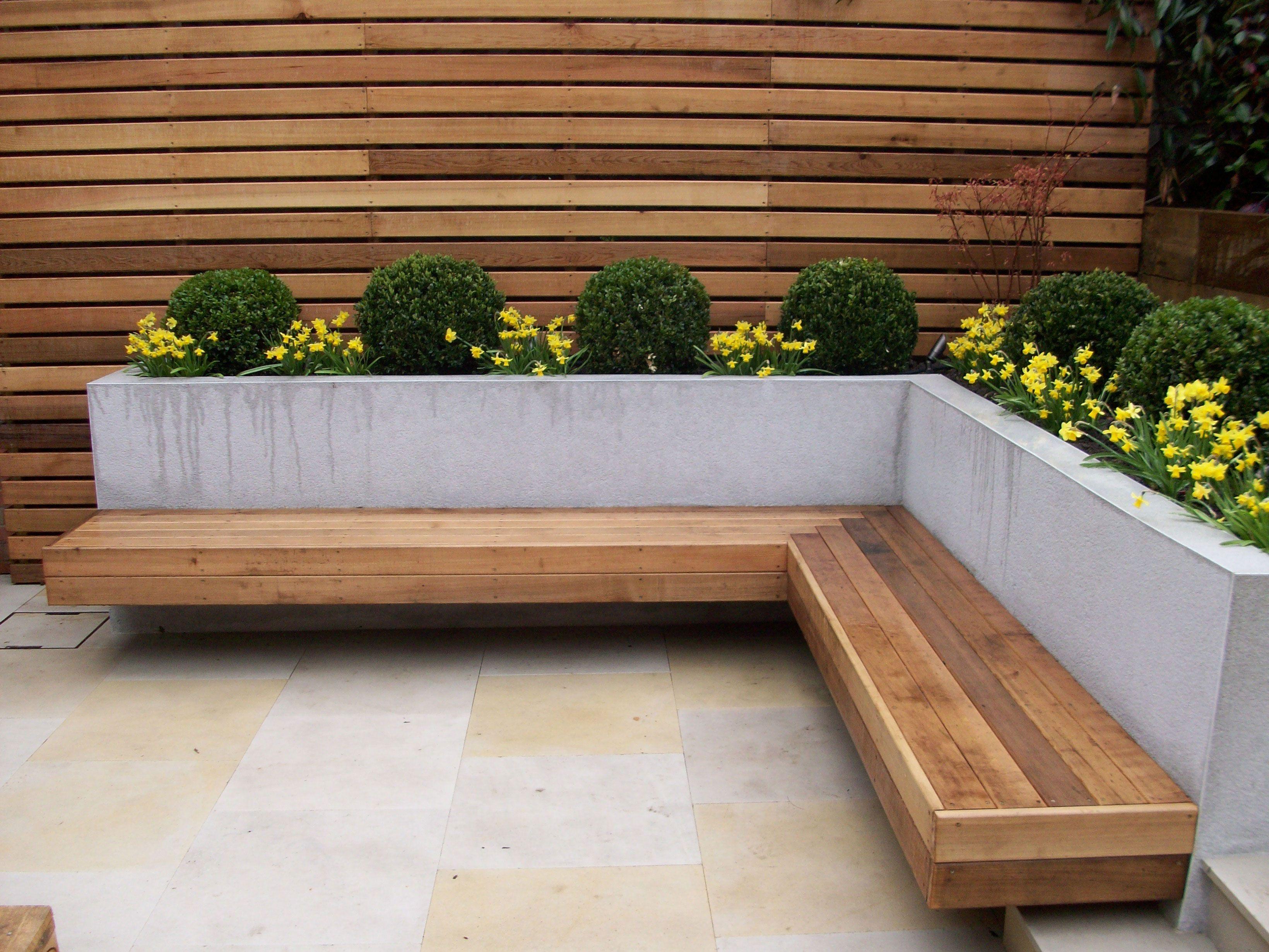

Alexob1 Posted June 13, 2022 Posted June 13, 2022 (edited) Can anyone recommend brackets or instructions for a floating bench please? I’ve built a wall but the brackets I’ve cemented in won’t be strong enough. I ideally don’t want the brackets to be seen either. Thanks Edited June 13, 2022 by Alexob1 1
Bonner Posted June 13, 2022 Posted June 13, 2022 Heavy rebar epoxied into the wall? Have you looked on YouTube? Loads of ideas, quite a lot American so some materials and tools we don’t have but worth a browse.
PeterW Posted June 13, 2022 Posted June 13, 2022 50x3mm box section frame fully welded with a 150x5mm plate backing that is resin bolted to the wall at 600mm intervals. Then the timber is over the top of that. The issue is both ends floating as they are where it will bend so you have to build the steel torsion box first.
