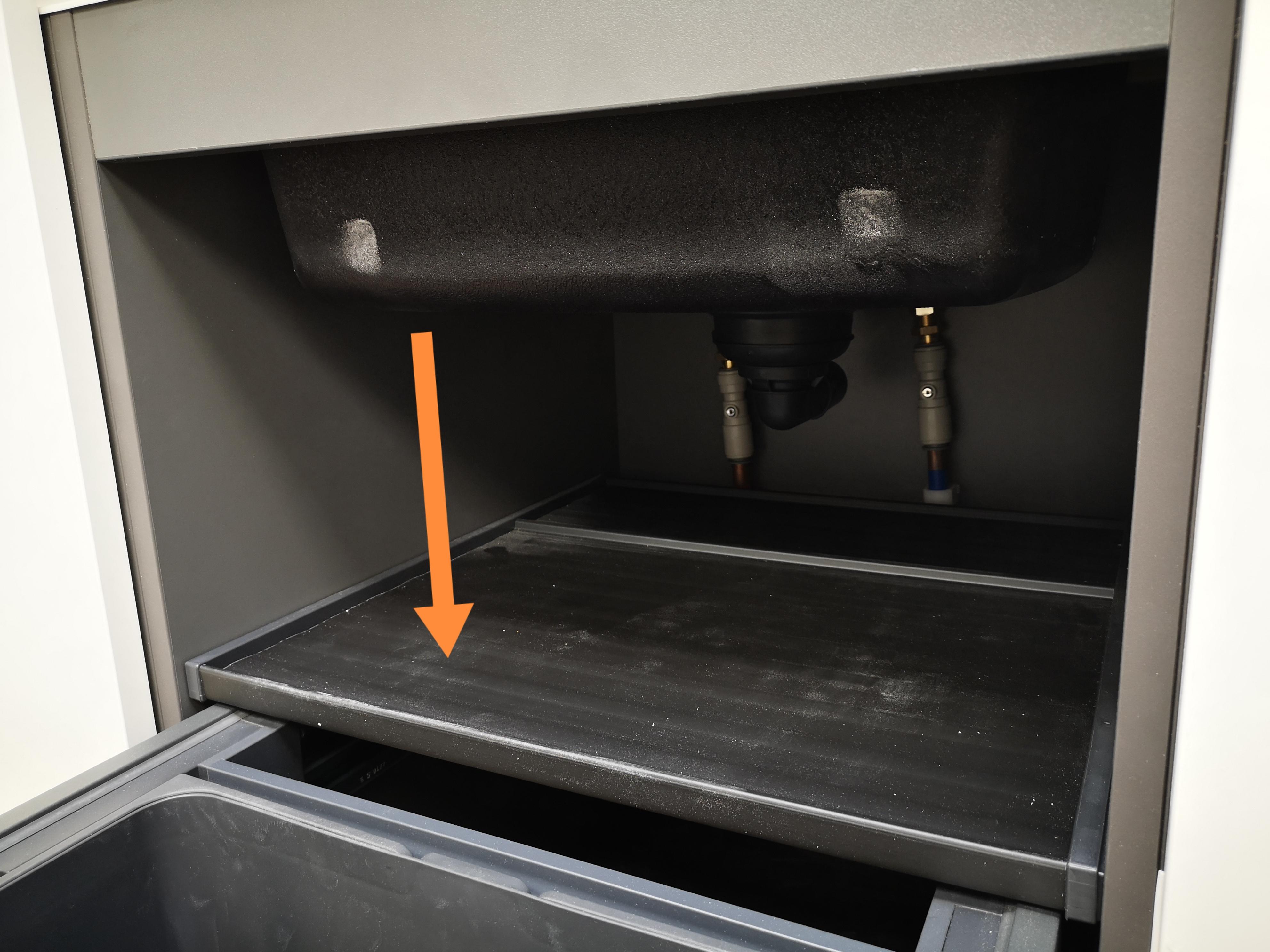

Porthole Posted May 29, 2022 Share Posted May 29, 2022 Hello Please can you help as the builder is struggling to fit a compact sink waste into the space we have. There is a bins drawer under a blanco sink which doesn't leave too much room for the u-bend waste trap (apologies I'm sure this isn't the right term). There is about 90-100 mm between sink pipe and top of bins unit. Does anyone know of a compact sink trap (u bend) which can be used? Many thanks!! Link to comment Share on other sites More sharing options...
Jenni Posted May 29, 2022 Share Posted May 29, 2022 Dry trap? Though I'm not sure if they're up to kitchen sinks. https://www.screwfix.com/p/mcalpine-wash-hand-basin-space-saver-with-self-closing-waste-valve-white-32-x-32mm/863HP?kpid=863HP&ds_kid=92700055281954514&ds_rl=1249404&gclid=CjwKCAjws8yUBhA1EiwAi_tpER4CRe5Ee9eNrPodU40whFquu9i9x5xDRuR7ok35actzCA2ouh0wyxoC18EQAvD_BwE&gclsrc=aw.ds https://www.toolstation.com/viva-magna-self-sealing-waste-valve/p82878?store=SL&utm_source=googleshopping&utm_medium=feed&utm_campaign=googleshoppingfeed&mkwid=_dm&pcrid=558023894541&pkw=&pmt=&gclid=CjwKCAjws8yUBhA1EiwAi_tpEbXHDAOectSETDWLD_I9vBRtodNkE-InSU7Gou5JZZGjXTgm_fUs4hoCRX4QAvD_BwE&gclsrc=aw.ds Link to comment Share on other sites More sharing options...
Temp Posted May 30, 2022 Share Posted May 30, 2022 Possibly this 95mm high trap.. https://www.toolstation.com/espace-extra-flat-sink-trap-1-12/p87482?store=GL&utm_source=googleshopping&utm_medium=feed&utm_campaign=googleshoppingfeed&mkwid=_dt&pcrid=558023894541&pkw=&pmt=&gclid=CjwKCAjws8yUBhA1EiwAi_tpEfnXG6GJstI6NwBbPfklp4PhPGIUkfdPjlYFBIDbztDNQcc-XWffIhoCsC4QAvD_BwE&gclsrc=aw.ds Link to comment Share on other sites More sharing options...
