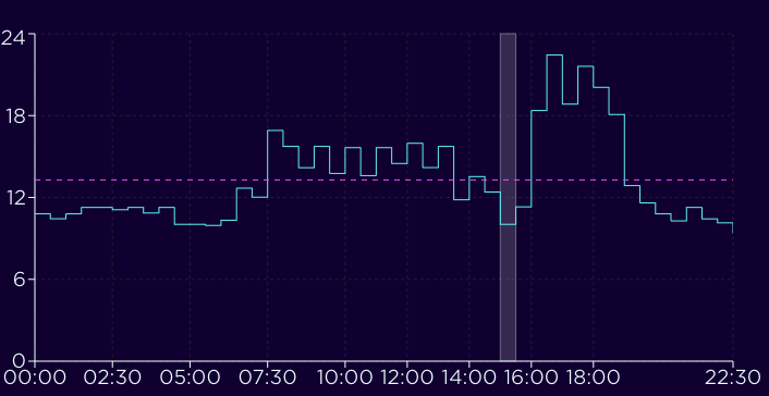

thanks. that's what I figured. I'm also thinking that all that solar PV could be being exported while the house is being built and earning us some money. according to PVGIS we should be averaging 1308kWh in May so even at 5p/kWh that's a nice little £65 a month bonus while we finish building. so a quick install of a single phase meter could be exactly what we need!
You can get more than that on Octopus Outgoing Agile.  I was getting 25p few months ago on average, but now there is more sun not quite so much.  Here is today.  You can't use "Outgoing Agile" with "Go" for import, but you aren't going to want cheap nightime during the build anyway.
yeah, looked at their agile outgoing tariff and looks interesting. I did download their data for average price over a period but I need to go through it and calculate the average price for during the day only.
